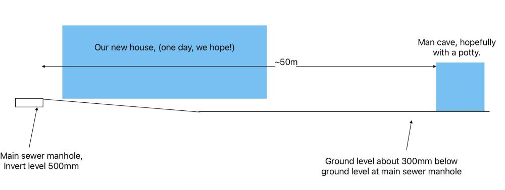

Uphill poo?

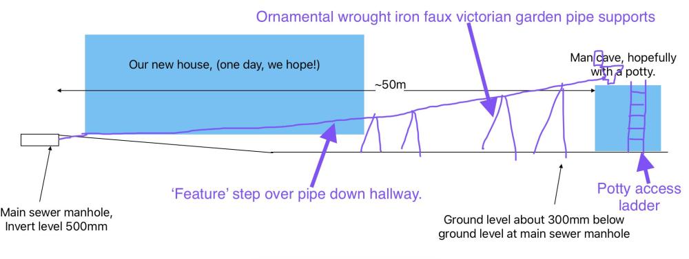

    Go and talk to a plumber  ask him if he would fit one.  guarantee if you fit it he will say don’t call him when it fails.    lots of things work, but is it right, is it a robust solution
  • I installed this pumping station in a similar situation, from Drainstore. It's been in a year and works fine so far. Completely silent.     Single Sewage Pumping Station - 610mm x 1000mm 292
  • A simple macerator would be a lot cheaper and simpler, typically they sit behind the WC pan.   Whatever you choose I would regard this shed loo as being for No 1's only.  Take a walk to the
