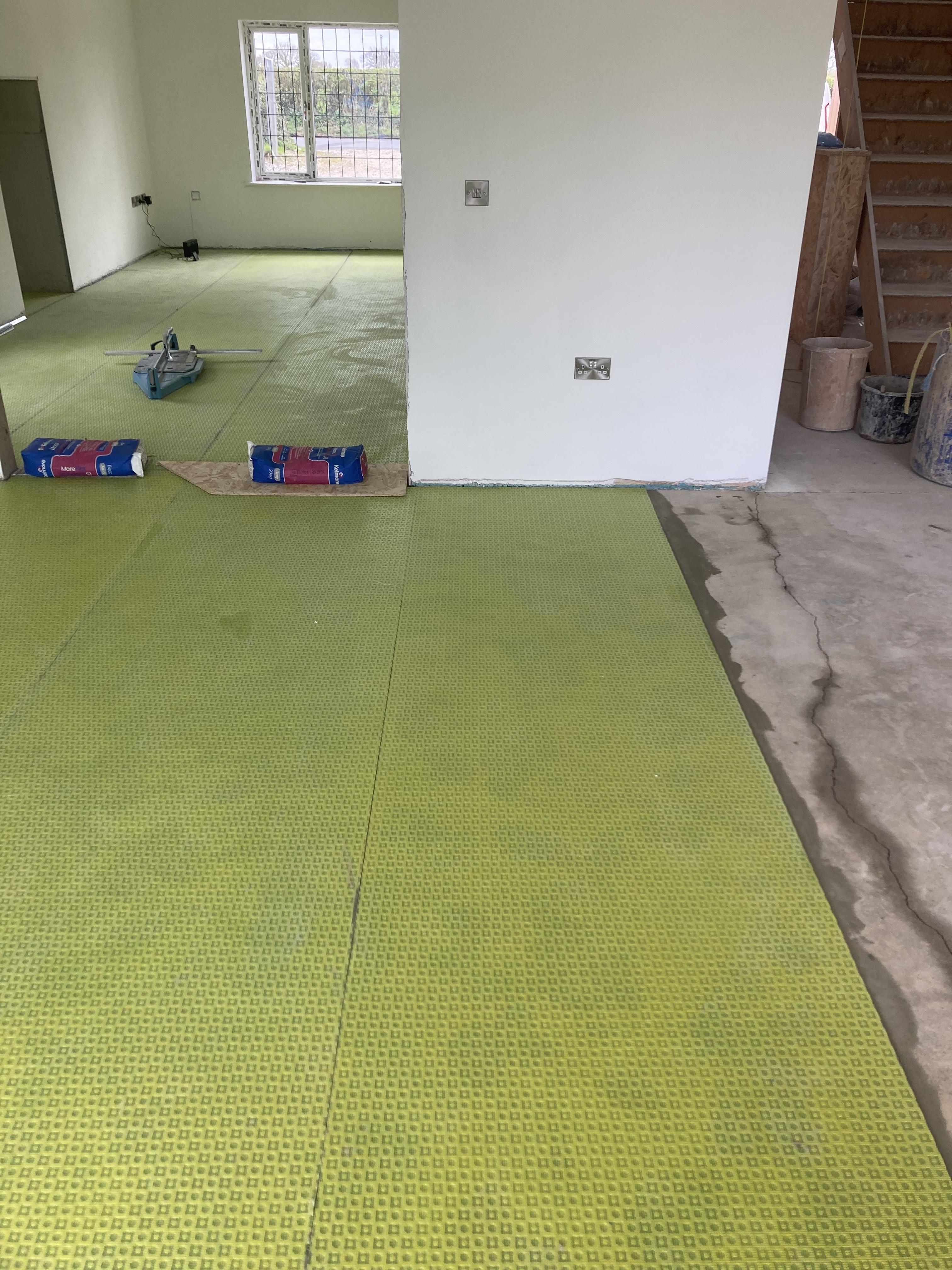

nod Posted April 7, 2024 Share Posted April 7, 2024 I’m busy for the next two weekends tiling the four bathrooms My wife helped me with the matting on the last one and decided to do a couple of rooms today Nice neat job I’ll have to show the tilers that work for me I can’t remember them sponging all the joints She’s used 90 m2 yesterday and today Another 110 m2 for her to do next weekend 😁 1 Link to comment Share on other sites More sharing options...
ProDave Posted April 7, 2024 Share Posted April 7, 2024 200m2 of matting? you have more bathroom area than my entire house. 2 Link to comment Share on other sites More sharing options...
nod Posted April 7, 2024 Author Share Posted April 7, 2024 3 minutes ago, ProDave said: 200m2 of matting? you have more bathroom area than my entire house. Just GF In doing the bathrooms myself Link to comment Share on other sites More sharing options...
JackofAll Posted April 30, 2024 Share Posted April 30, 2024 What thickness is the mat @nod also what brand, thanks. Link to comment Share on other sites More sharing options...
nod Posted April 30, 2024 Author Share Posted April 30, 2024 (edited) It’s Dura mat I normally use Ditra But my wife found this at £800 for seven rolls Which is nearly twice what pay for Ditra There a 5 mil build up once fixed Edited April 30, 2024 by nod 2 Link to comment Share on other sites More sharing options...
Canski Posted April 30, 2024 Share Posted April 30, 2024 2 minutes ago, nod said: It’s Dura mat I normally use Ditra But my wife found this at £800 for seven rolls Which is nearly twice what pay for Ditra There a 5 mil build up once fixed do you mean half what you pay for ditra ? I used Ardex AF 200 plus to stick my Ditra down. I wasn't very impressed with either the coverge or the efficiency. I presume you use tile adhesive ? Link to comment Share on other sites More sharing options...
jayc89 Posted April 30, 2024 Share Posted April 30, 2024 3 minutes ago, Canski said: do you mean half what you pay for ditra ? I used Ardex AF 200 plus to stick my Ditra down. I wasn't very impressed with either the coverge or the efficiency. I presume you use tile adhesive ? I bought some of that stuff too, and forgot about it, so used the same adhesive as what I used for the tiles on top of the mat. Seems to have worked a treat. Link to comment Share on other sites More sharing options...
nod Posted April 30, 2024 Author Share Posted April 30, 2024 9 hours ago, jayc89 said: I bought some of that stuff too, and forgot about it, so used the same adhesive as what I used for the tiles on top of the mat. Seems to have worked a treat. Yes Ditra is nearly -£200 per 30m2 Ardex is for timber floors 3 mil notched trowel Expensive But bombproof My wife stuck this down with flexi tile adhesive 5 mil notched Couldn’t wait for me I normally pay my tilers a fiver m2 But she’s getting nothing for jumping the gun 😁 1 Link to comment Share on other sites More sharing options...
