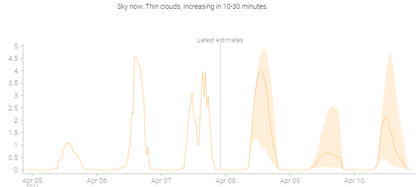

JohnMo Posted April 7, 2024 Posted April 7, 2024 46 minutes ago, NailBiter said: Of course it depends on the quality of your forecast data (and how accurately you modelled your array and shading). Pretty accurate, trouble with winter and spring the variability of the weather and variable usage My forecast (from Solcast) for the next couple of days, the white is the low forecast the pink is max and the orange line the averaged expected. A lot of variability. It also takes zero account of temperature. Today heat pump barely ran, tomorrow will also barely run, the next day it will, so although the prediction tool looks back (consumption) and ahead (PV output and averaged out consumption) it's a bit of a finger in the air during the heating season. So although home assistant knows what happens in the past and therefore predicts the future likelihoods, the likely scenario on the 9th it would see low consumption on the 7th and 8th build that in to the kWh likely to be consumed on the 9th and give a short fall in SOC at the end of my E7 window. When heating with a heat pump and you get variable weather (we all do), and this part of the picture is missing it isn't or cannot be best placed to accurately predict. @NailBiter what forecasting tool are you using?

NailBiter Posted April 8, 2024 Posted April 8, 2024 (edited) 11 hours ago, JohnMo said: Pretty accurate, trouble with winter and spring the variability of the weather and variable usage My forecast (from Solcast) for the next couple of days, the white is the low forecast the pink is max and the orange line the averaged expected. A lot of variability. It also takes zero account of temperature. Today heat pump barely ran, tomorrow will also barely run, the next day it will, so although the prediction tool looks back (consumption) and ahead (PV output and averaged out consumption) it's a bit of a finger in the air during the heating season. So although home assistant knows what happens in the past and therefore predicts the future likelihoods, the likely scenario on the 9th it would see low consumption on the 7th and 8th build that in to the kWh likely to be consumed on the 9th and give a short fall in SOC at the end of my E7 window. When heating with a heat pump and you get variable weather (we all do), and this part of the picture is missing it isn't or cannot be best placed to accurately predict. @NailBiter what forecasting tool are you using? Solcast is reasonably accurate (if you pay for access to the lower interval data), I'm guessing you are using the free high interval data but it is hard to tell from that graph. That is only 1 of the forecasts EMHASS needs to work however. You also need to be accurately forecasting use and that forecast also needs to be accurate. Your forecasts may be off as your array may be a slightly different azimuth / pitch or your panels may be producing a different amount of power than you told the solar forecasting tool. You might also have shading issues. At first it is likely EMHASS will be wildly wrong but over time it will learn. Yes that has to be from the past as we can't learn from the future. If your claim is that accurately forecasting the above is impossible I'd contend that hard is not the same as impossible. Using data and machine learning algorithms to calculate something is the exact opposite of finger in the air. Relying on an individual to monitor by manually and respond manually is a much more time consuming and error-prone approach but to each their own. I think you may have missed that it isn't just using past data to make predictions it uses current data to update those predictions. You don't have to use it if you don't want to, nobody does, equally it is a tool there waiting to be used if you want to. Edited April 8, 2024 by NailBiter
