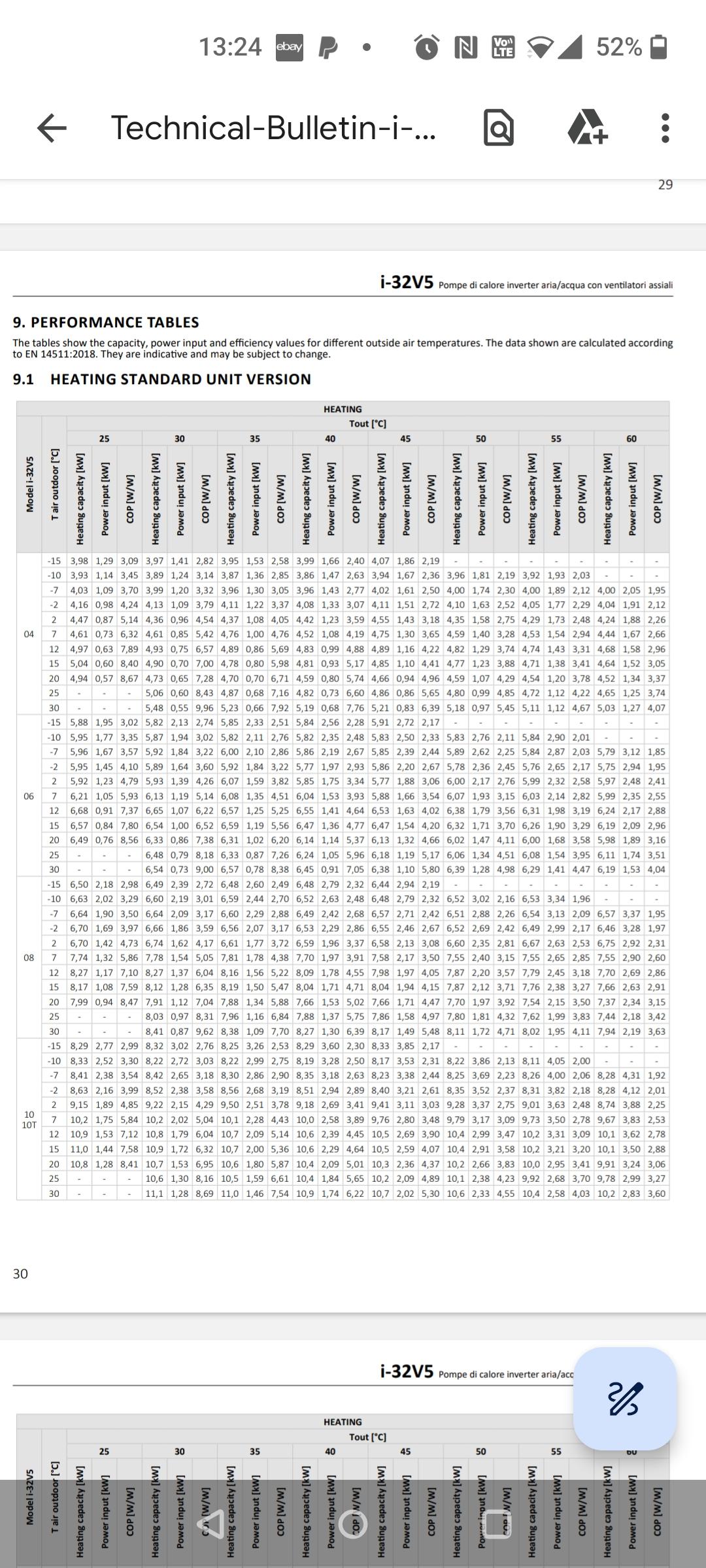

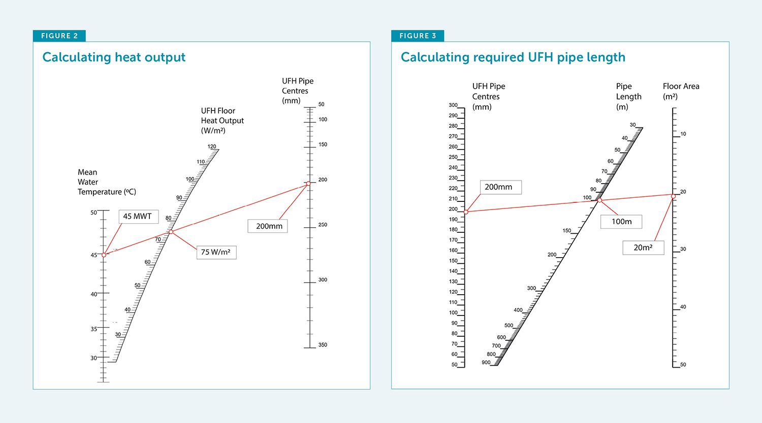

JohnMo Posted March 31 Share Posted March 31 Trying to sort out fact from opinion is difficult. You need facts to be informed. Something to read, my heat pump performance table for flow temp and outside temp, CoP and power needs. What you see at flow temps below 35 CoP is good at almost any outside temp. Another document that shows UFH output at different pipe centres and heat outputs at different mean flow temps. ASHP heat flow with delta T of 5 to 6, so the mean temperature is flow temp -2.5 to 3, when using table. W/m2 is highest heat demand, divided by the area of the floor. 1 Link to comment Share on other sites More sharing options...

Originaltwist Posted March 31 Share Posted March 31 34 minutes ago, JohnMo said: Trying to sort out fact from opinion is difficult. You need facts to be informed. Yes but you can prove anything with facts. Seriously though, I love those charts, where do they come from? Link to comment Share on other sites More sharing options...
JohnMo Posted March 31 Share Posted March 31 2 minutes ago, Originaltwist said: Seriously though, I love those charts, where do they come from? The CoP heating temperature came from a Maxa heat pump technical manual. The UFH I found on the internet somewhere. But the figures seem ok, match LoopCad reasonable well. Link to comment Share on other sites More sharing options...
