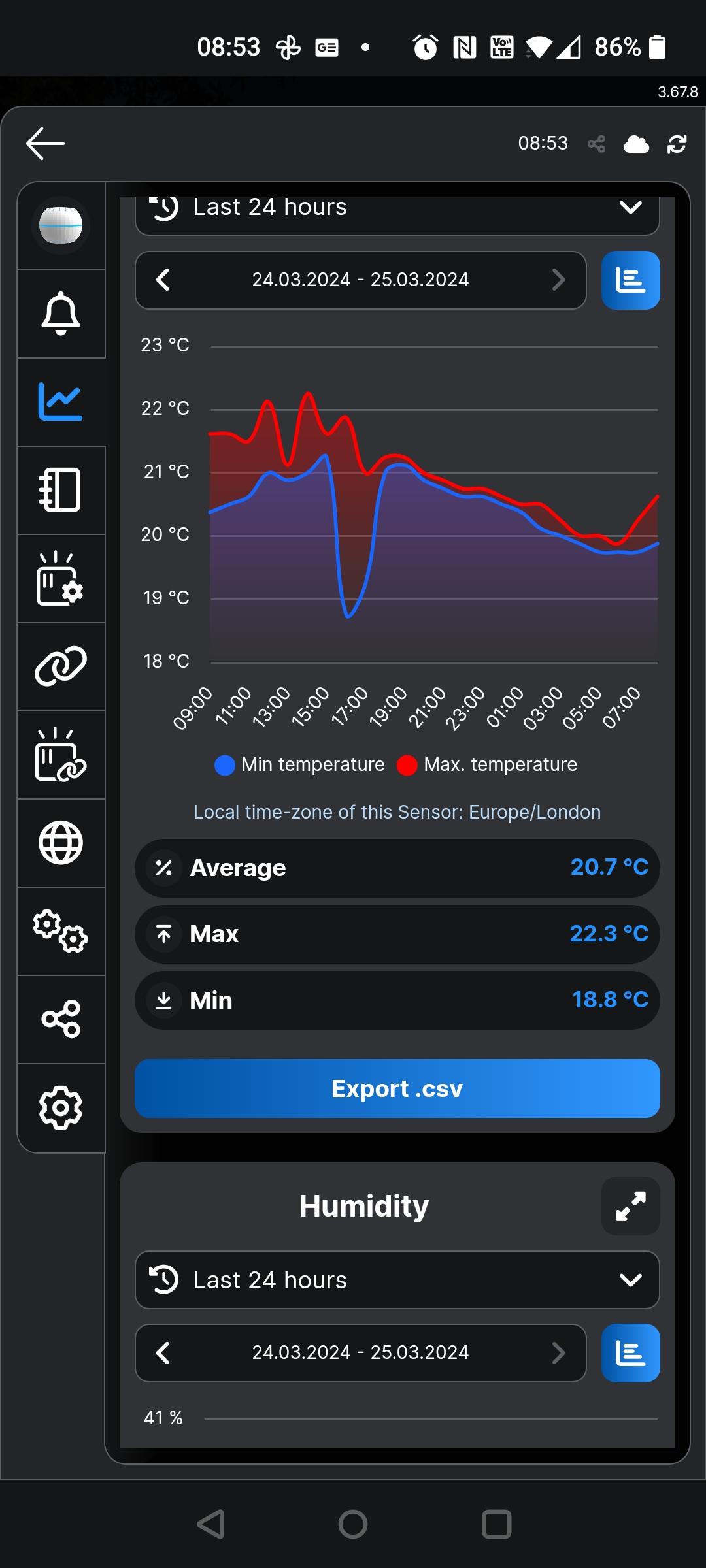

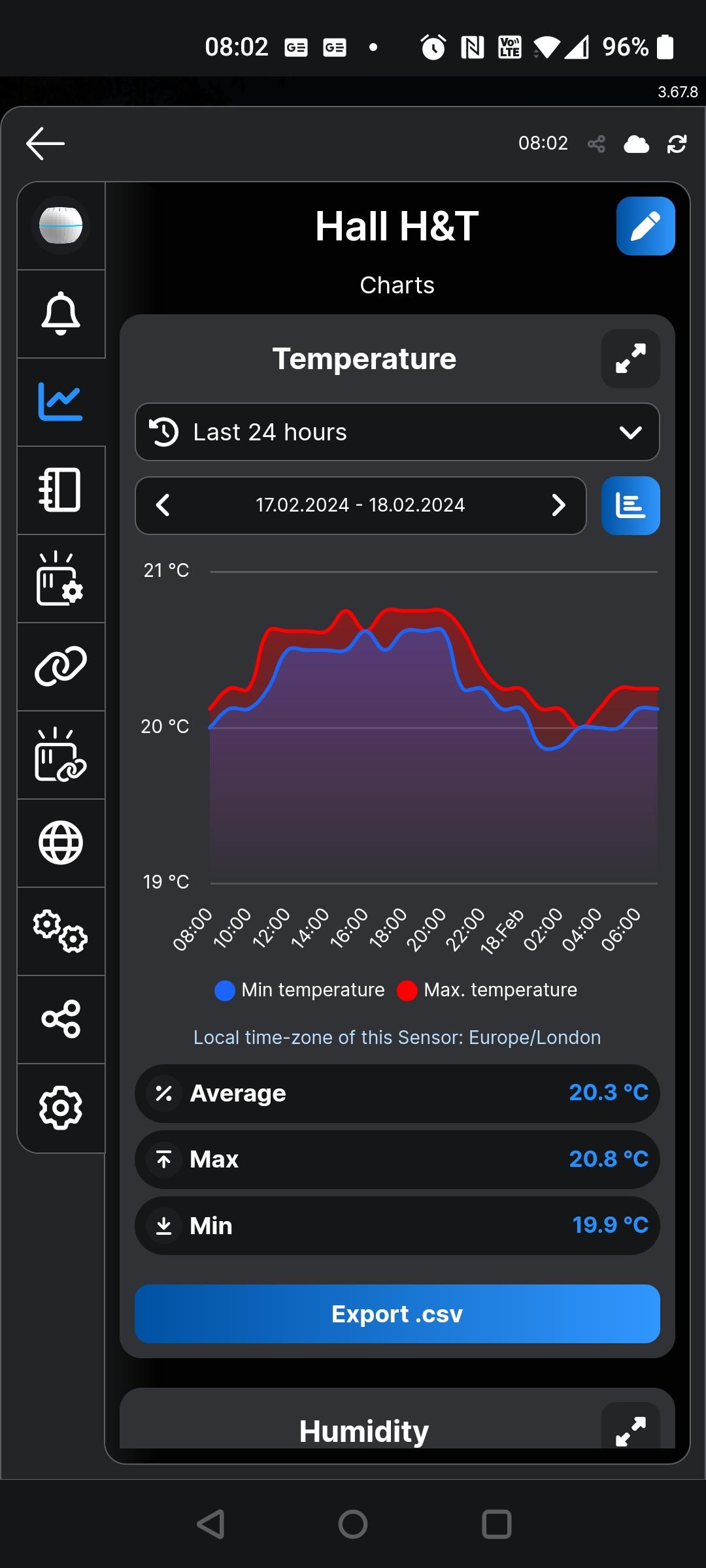

JohnMo Posted March 25 Share Posted March 25 56 minutes ago, SteamyTea said: interested in how stable the room temperatures stay? This is a sensor in the hall, had to go back in time to find a day not affected by solar gain. So get about 0.5 Deg fluctuation over a 24 hr period. Link to comment Share on other sites More sharing options...
SteamyTea Posted March 25 Share Posted March 25 3 minutes ago, JohnMo said: This is a sensor in the hall, had to go back in time to find a day not affected by solar gain. So get about 0.5 Deg fluctuation over a 24 hr period. I obviously don't have a room stat as such, just input and output stats are in the storage heater, but they are not brilliant for sensing actual room temperature. It did cross my mind that as the ΔT decreases, the heat pump can modulate the power downwards a bit. Link to comment Share on other sites More sharing options...
JohnMo Posted March 25 Share Posted March 25 13 minutes ago, SteamyTea said: did cross my mind that as the ΔT decreases, the heat pump can modulate the power downwards a bit. The way mine seems to work is Target temperature and dT Starts up maintains dT first, as dT decreases over time, it add more heat to increase flow temp to maintain dT. Once target flow temp is reached, it reduces load (modulates down) to keep flow temp and dT within limits. Link to comment Share on other sites More sharing options...

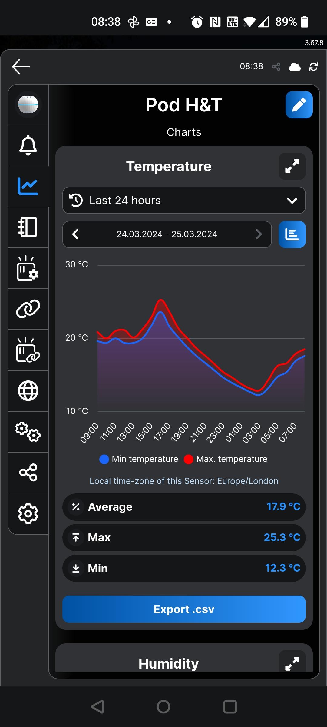

JohnMo Posted March 25 Share Posted March 25 I have two shelly H&T's for monitoring, one in the hall the other in the garden room. So comparison to the above post Different type of building, summer house (200mm polystyrene floor and roof insulation, plus multifoil, with air gaps, 70mm thick wood walls with 140mm mineral wool insulation). Inside temperature profile, very different. Fan coil, thermally light weight building, heating goes off at midday. All driven from the same heat pump as the house, this is yesterday and this morning, the big peak is solar gain. 3am fan coil starts up, with a flow temp that slowly ramps up to about 32/33 degs, takes 5 hrs to increase room temp from 12 to 20 degs., then maintains it till midday. Once solar gain stops the heat drops around a degree per hour. Outside temp at 5pm was about 5 degs and 10pm zero. Yesterday house temps Big dip in the blue was windows and doors open, we closed the door at 5pm and temp recovers quickly. But lounge window stays open for a further couple of hours. Bedroom was warm and we kept the window open all night (zero overnight outside). Link to comment Share on other sites More sharing options...
