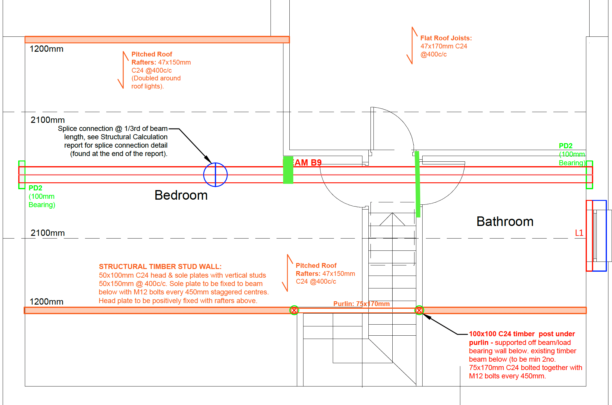

NandM Posted March 19 Share Posted March 19 My SE has spec'd a fairly hefty ridge beam for a 9.6m span @ 254x254x89UC. This will be supporting either 9x2 or 10x2 rafters with clay roof tiles and in-roof solar. A couple of builders I've had over were surprised by the size of the beam and the challenge of getting it up. I could hire a crane, but I'm wondering if it has been over spec'd and/or whether I can build in some additional support to take some load and reduce the beam size.. I've emailed the SE with my query, but it would be great to get your thoughts as well. I proposed a load bearing wall in the bathroom and, if it helps a lot, a column or pier in the bedroom. Both would be on top of existing load bearing walls. Link to comment Share on other sites More sharing options...

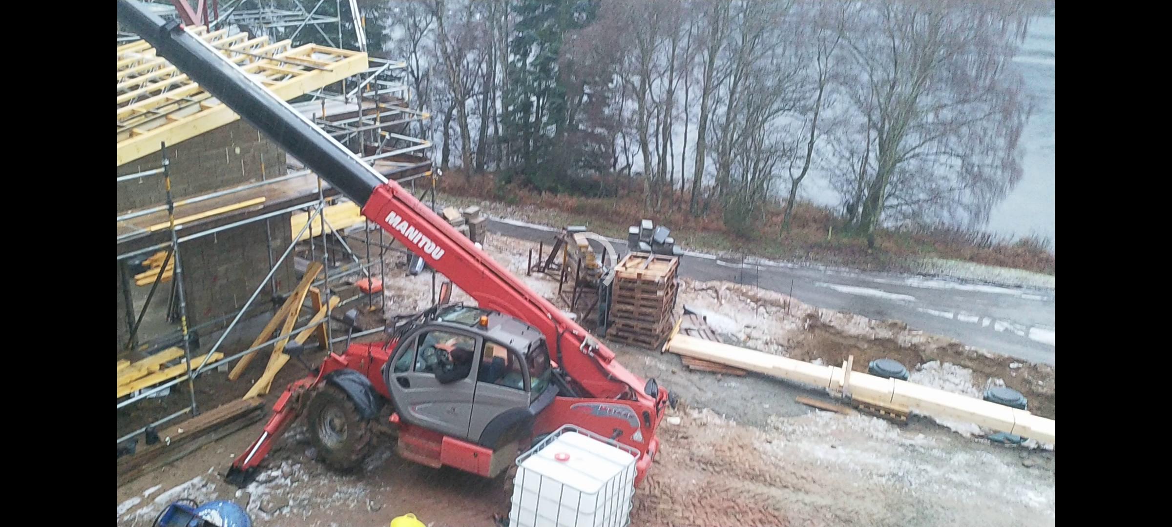

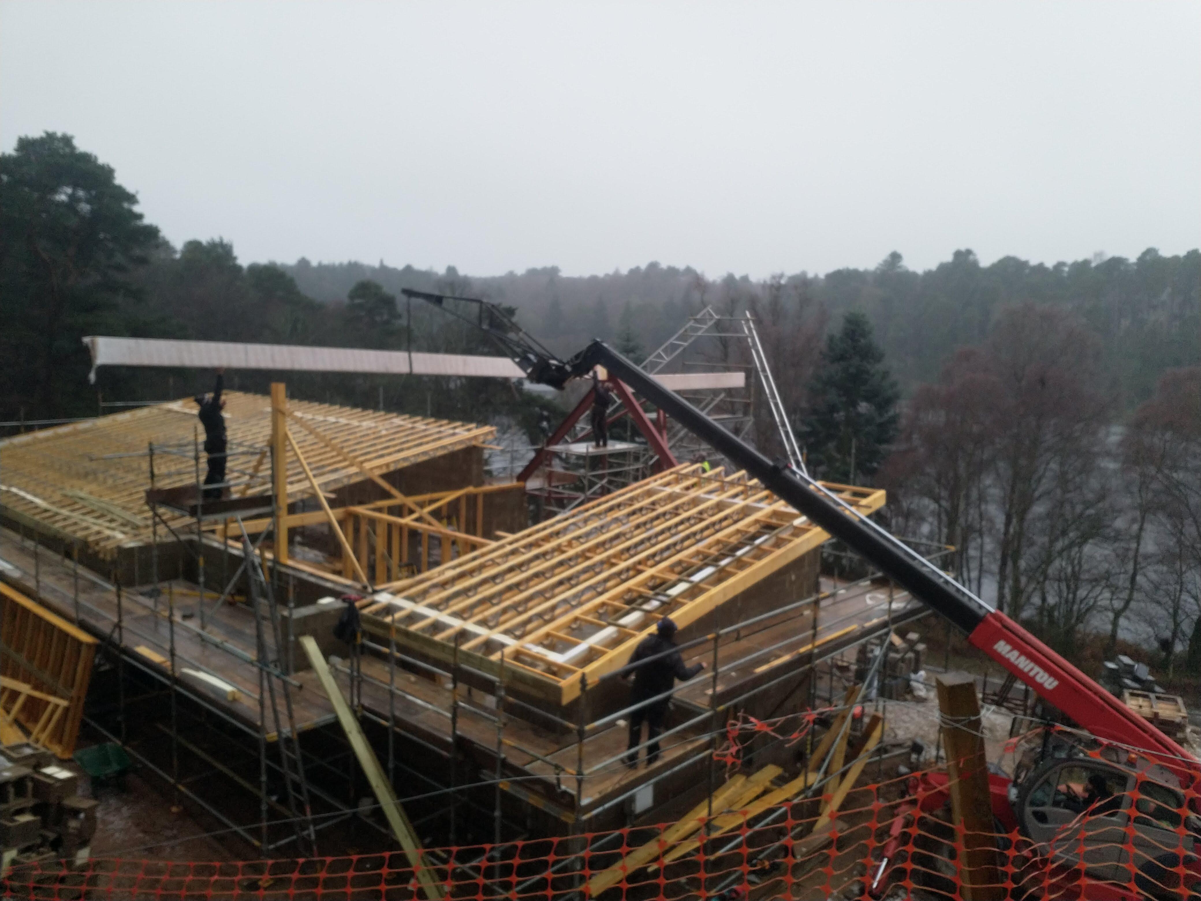

JohnMo Posted March 19 Share Posted March 19 7 minutes ago, NandM said: 254x254x89UC Ask why not a glulam beam (or similar), at least you don't get a massive thermal bridge. This is mine being lifted in with a pretty small tele handler, think that beam is about 11-12m long. 1 Link to comment Share on other sites More sharing options...
saveasteading Posted March 19 Share Posted March 19 9 minutes ago, NandM said: builders I've had over were surprised by the size of the beam It's a very long span taking a lot of load. It looks right to me . The weight would reduce if you used a deeper beam (perhaps about 450 or 500 deep) instead of that chunky section. But deeper will likely interfere with your headroom/ aesthetics. 1 Link to comment Share on other sites More sharing options...

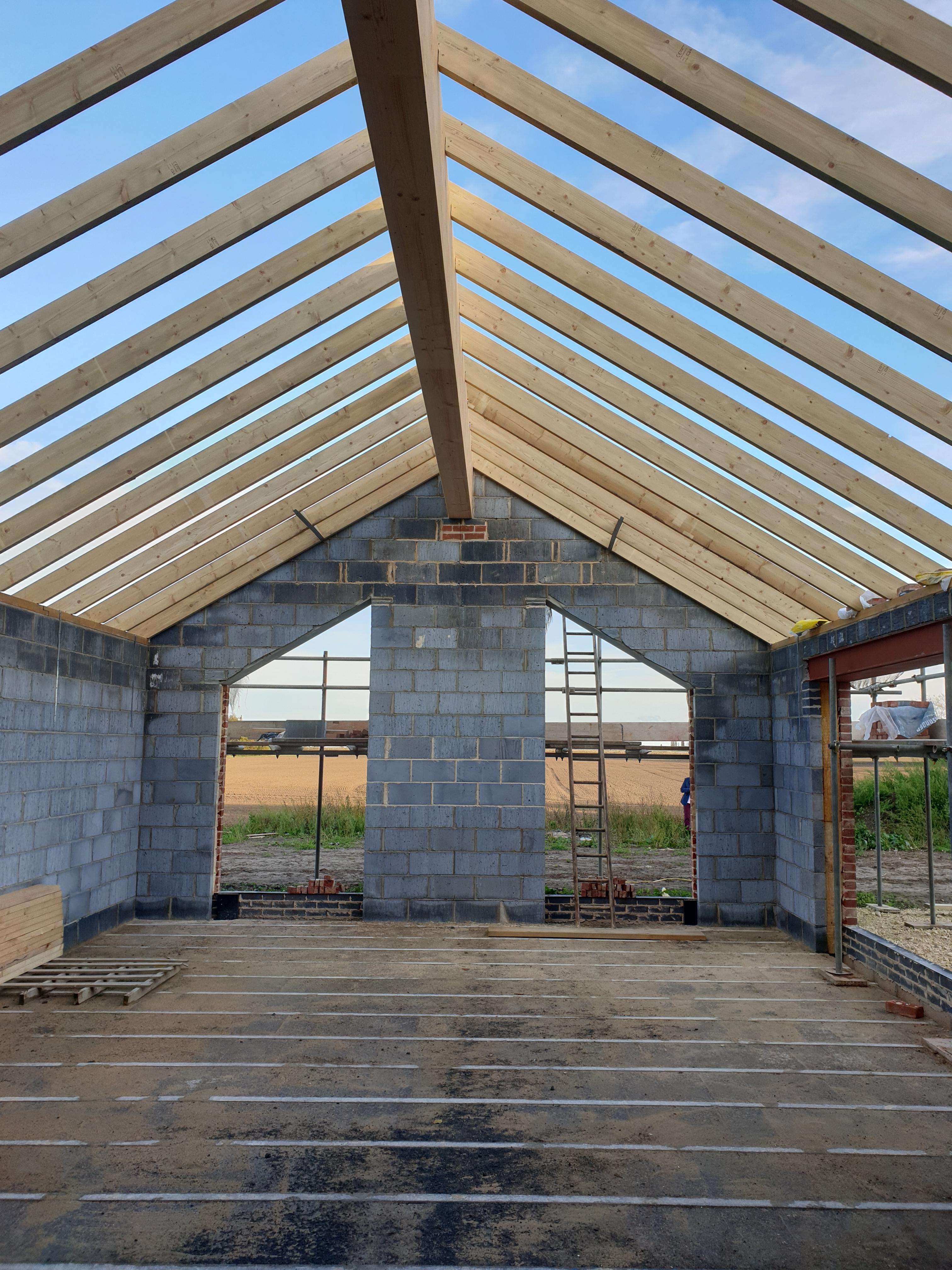

Buzz Posted March 19 Share Posted March 19 17 minutes ago, JohnMo said: Ask why not a glulam beam (or similar), at least you don't get a massive thermal bridge. This is mine being lifted in with a pretty small tele handler, think that beam is about 11-12m long. Another fan of glulam beams here , this one was just over 12m and tele handler friendly , you can leave some of it on show rather than boxing around steels. 1 1 Link to comment Share on other sites More sharing options...

George Posted March 19 Share Posted March 19 21 minutes ago, saveasteading said: Good question. The building regs may imply yes. The reality is it won't burn down until the rest is already gone. Don't need to protect roof structural elements in normal two storey house. Beam span is quite large so agree unless you put in a deeper beam then it is about right. I note it isn't a simple pitched roof, there is a flat section so something else is going on which might explain the size. They've also allowed for a splice which may help installation. Glulam is an option but end up being pretty big over 6m or so. Link to comment Share on other sites More sharing options...

Russell griffiths Posted March 19 Share Posted March 19 @NandM why are you bothered and why are you questioning it. my point. unless the beam in question is made of unobtainiam and it’s a cost point you are arguing then. you will need some sort of beam, that’s a definite a timber kerto beam or laminated gluelam will not be cheaper than a steel beam. whatever you use you won’t be picking it up by hand, so it’s a telehandler or a crane, that’s for sure. the only thing I can see in your drawing that I think is pointless is the splice joint, a 10m beam can be made in one piece, it can be delivered on a normal truck, it doesn’t require an artic, so unless you are really tight for space I see no reason to make it in two parts. a splice joint could add £250-400 depending on number of holes and bolts used. all I would say is if you can go deeper with the size it could get lighter, maybe 45-55 kg a metre, so it ends up 500kg instead of 900kg. still needs a crane or a forklift though. 1 1 Link to comment Share on other sites More sharing options...
saveasteading Posted March 19 Share Posted March 19 1 hour ago, Moonshine said: Could the same not be said for steel structural support Yes. At a certain chunkiness they don't need any (or partial) protection. The one here for example is unlikely to need any. There is no occupation above it. At 300+ degrees it will soften a bit. @NandM Re the splice, and the rest, Russell is right. Ask the supplier for 2 options, in case it happens to suit manufacture or delivery costs (small lorry) But lift it in one piece. If the builder hasn't seen beams this heavy, he either hasn't much experience of beams....or some cash and no regulations clients have unstable houses. Either way, discuss the proposed method for lifting and fixing it.....a 'risk assessment'. 1 Link to comment Share on other sites More sharing options...
NandM Posted March 19 Author Share Posted March 19 @Russell griffiths - I wanted to see if we could get to a size/weight that could be manhandled and avoid the expense of a crane. If the beam sizing seems fine, then a crane would be needed whether spliced or not....which would then bring to the question of the point of the splice if I was to crane it in. I didn't realise spliced joint would add that much cost....it now makes sense why I had one fabricator suggest seven splices "as that's how lots of lofts are done". Good point re manufacturer delivery @saveasteading - I'll keep that in mind and ask for two quotes. Link to comment Share on other sites More sharing options...
NandM Posted March 19 Author Share Posted March 19 Re deeper ridge beam, it looks like the current height is around 2.8m, so I could loose 20cm and still have a very decent head height. I'll explore this with the SE as well. Link to comment Share on other sites More sharing options...
Russell griffiths Posted March 19 Share Posted March 19 Regarding splice cost. I haven’t a clue about current costs, but basically they charge by the hole, so a plate with 6 holes in both sides would be 12 holes @ £10 a hole ( just a guess) plus the two or 4 steel plates. Regarding lifting it in one piece your beam is 854kg in two it’s 427 kg. in three it’s 284kg. so cutting it in 3 it’s still over a quarter of a tonne. if I was on a budget and doing it myself I would lift them up through the first floor and then get them up to the final point. however if you are paying a builder and his two lads to do this the time you have payed out £450-600 for a day of messing about you could have paid to have it lifted up mechanically and been finished by 11am. it’s all a bit of save a quid in one hand and pay it out in another. if I was doing this I would look for a local company with either a large hijab lorry or a mobile tracked crane. 1 Link to comment Share on other sites More sharing options...
LiamJones Posted March 19 Share Posted March 19 Have a look at spider cranes. I just paid £350 for half a days lifting a 11m ridge beam, 2 posts to sit it on and a ground floor steel. 5 pieces in total. Don’t mess around trying to do it by hand, your brickies are far slower, so will work out way more expensive and more risky. 1 Link to comment Share on other sites More sharing options...
