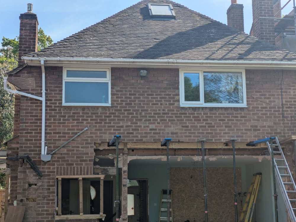

I was hoping to leave most of the demolition work until the brickies were ready to build the gable walls, and minimise the risk of rain damage. But now I'm thinking the old structure is getting in the way too much. I need to get services in the ground and start levelling the oversite etc. In the picture it's the whole left hand side that will need to go and also around the side about the same width. I was thinking about removing the roof tiles to minimise pressure on the walls and use something like dpm as a temp covering. Then to add series of hefty cross beams, before removing that corner of the roof and working down. The three chimneys will also need to be removed. Would removing the tiles from the roof be sufficient to reduce the spreading force of the roof into the walls?

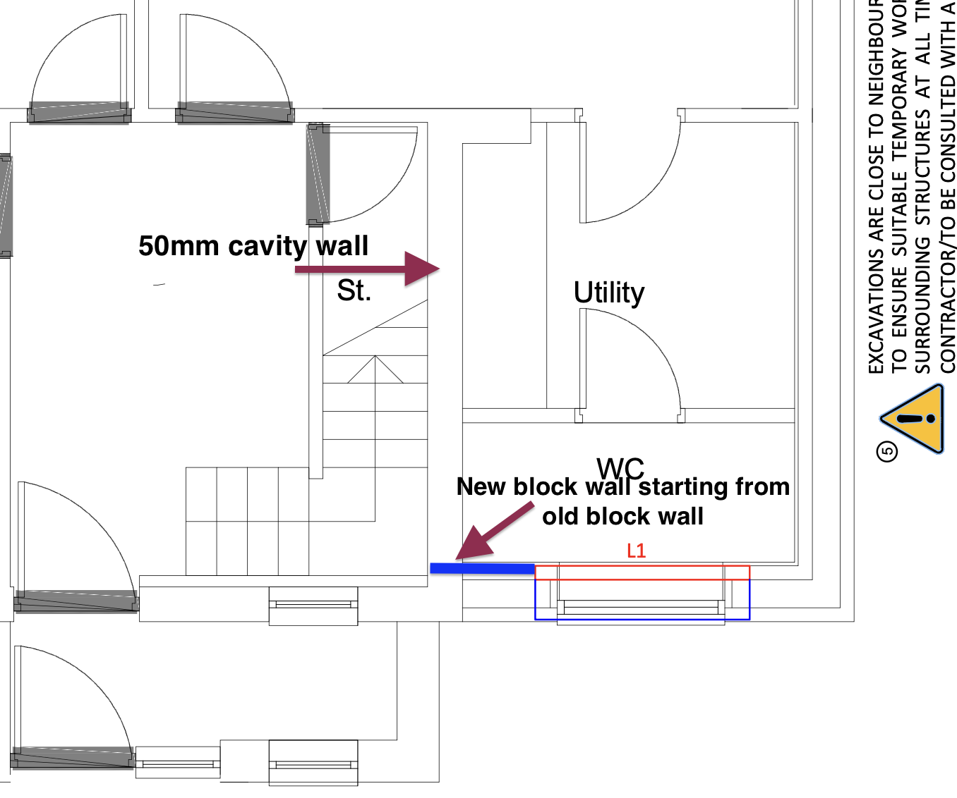

As part of our proposed extension work, a current external cavity wall will become an internal wall. The current brick wall will have a 100mm slit to act as a thermal break, but I will still have a approx 4m length of cavity that is still "connected" to the outside. Do you see this causing any issues with heat loss? I can wet plaster both sides to help with airtightness - but I really don't want to add insulation to the walls on both sides (although I could fill with eps beads). The one idea I have in mind is to start the new block work from the old block work by having an approx. 250mm opening down the entire side of the wall and joining the two. This will result in a separation between the" internal" cavity and the external one. There are two challenges I see here: 1) with the 250mm opening, could it be done from bottom up without the need for any lintels. Google tells me this should be OK. Otherwise, we could do it top down. 2) the new block that will connect to the old would have to use whatever the current foundation depth is - at least for 150mm of the block. Would this be a problem?

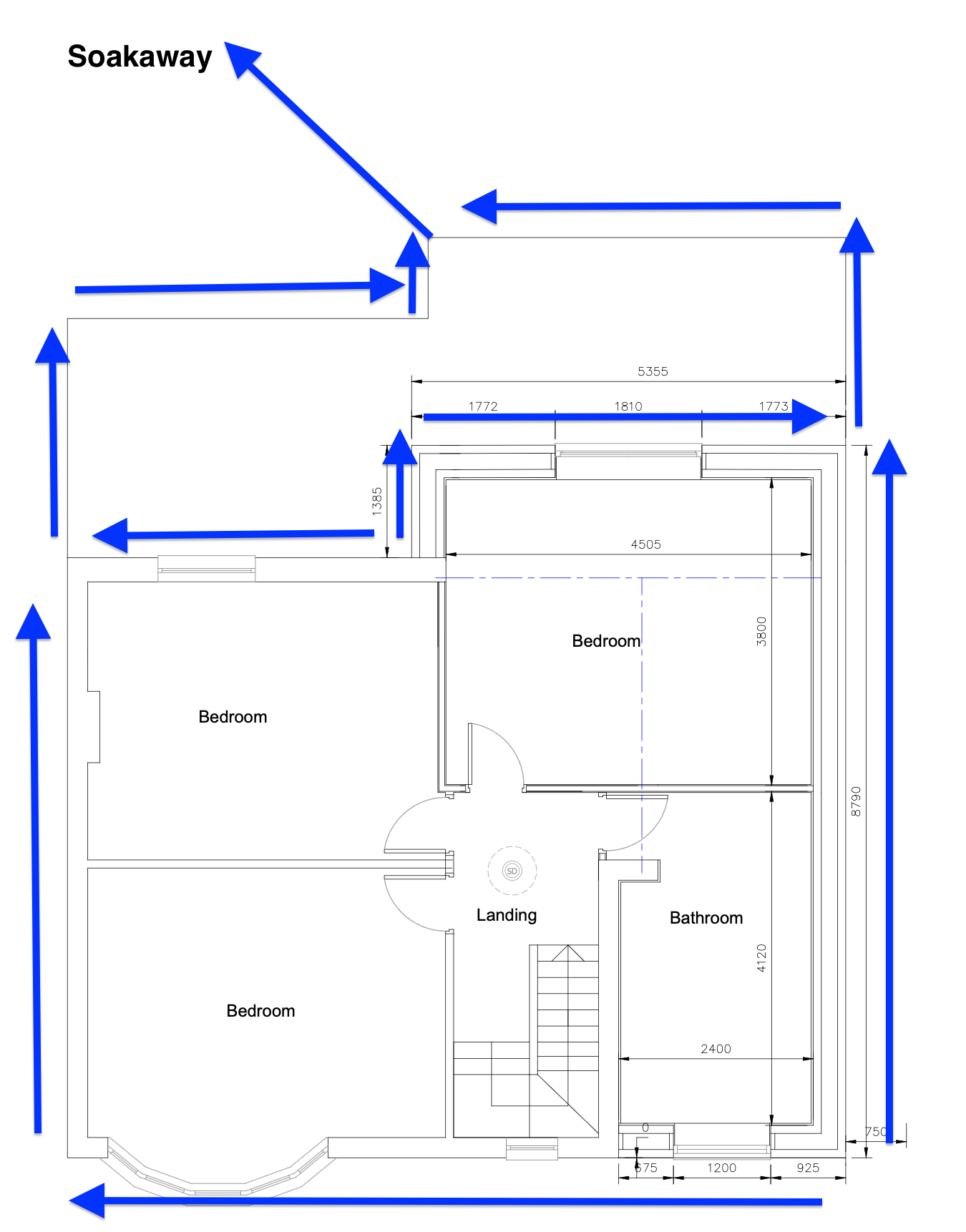

I'm finally about to start the groundwork (yay!) and am thinking about the best way to get the rainwater to the soak away. I'm hoping my simple design by routing all the pipes to one outlet would work? In effect the pitched and dormer roof to route down to the flat roof pipes on ground floor and from there to one gulley and then to the soak away at a distance of 5m, and under 4m of patio.
