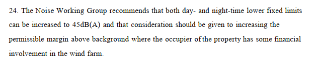

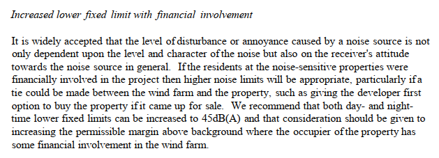

Moonshine Posted March 6, 2024 Posted March 6, 2024 (edited) 26 minutes ago, GrantMcscott said: Non-interference -The Householders will acknowledge and agree that they are financially involved in the Energy Project for the purposes of the ETSU Noise Guidance. Are you financially involved? will you get money as part of the development. If you a financially benefited from the scheme you will have a reduced noise criteria applied to you (i.e. the turbines can be louder at your premises compared to someone not financially benefitted). I can't recall of the top of my head if its 3 or 5 dB. Edit i was wrong, it varies but is 45 dB during the day and night. Edited March 6, 2024 by Moonshine 1
GrantMcscott Posted March 6, 2024 Author Posted March 6, 2024 (edited) 33 minutes ago, Moonshine said: Are you financially involved? will you get money as part of the development. If you a financially benefited from the scheme you will have a reduced noise criteria applied to you (i.e. the turbines can be louder at your premises compared to someone not financially benefitted). I can't recall of the top of my head if its 3 or 5 dB I live in a valley and most likly will not see the turbines so and 2 km away so would it matter about noise? We are also upwind of the turbines. yes that is what I am deciding if I am going to be finacially involved as it is not a lot of money Edited March 6, 2024 by GrantMcscott

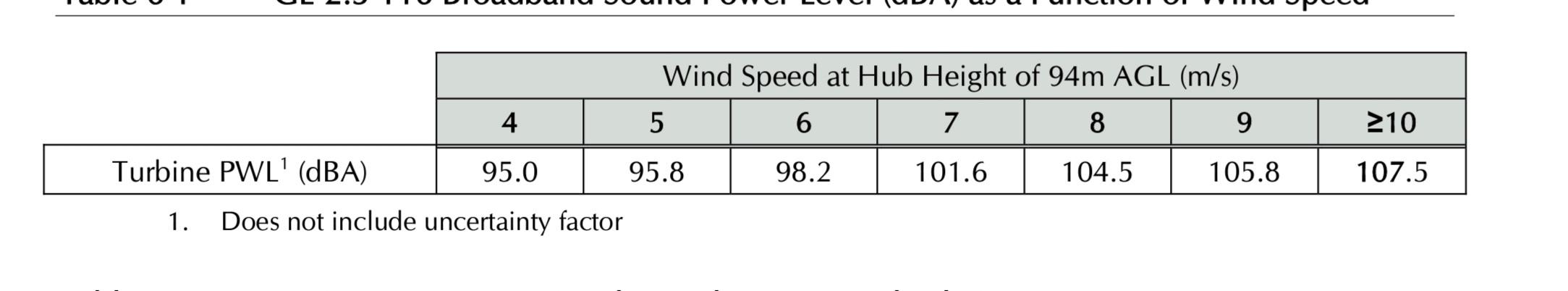

Moonshine Posted March 7, 2024 Posted March 7, 2024 The noise assessment will be based on manufacturers sound power data for the turbine at different wind speeds, something like below The turbine generally gets noiser at higher windspeeds, until it hits it cut off windspeed to avoid damage. Also the noise criteria gets higher at the receptor as wind speeds get higher as the background noise level increases. However as there is a financial tie, it's a flat 45 dB whatever the wind speed. In this example the wind turbine has a sound power level of 108 dB at 10 m/s. Assuming a simple point source radiation and no other losses or wind propigation effects its 34 dB at a receptor 2km away. There will be more than one turbine operating, so you get a culmative effect but need to account fot thier spatial distance. Say 4 turbines are equally spaced to the receptor, the result of all 4 is 40 dB. 8 equally spread turbines is 43 dB. However the losses due to met and atmospheric can be large, so these levels can only get lower. When the wind is howling at 10 m/s the ambient levels at you house may mask the noise. However personally I would want a chunk of cash before I start to give up my rights in relation to noise.
