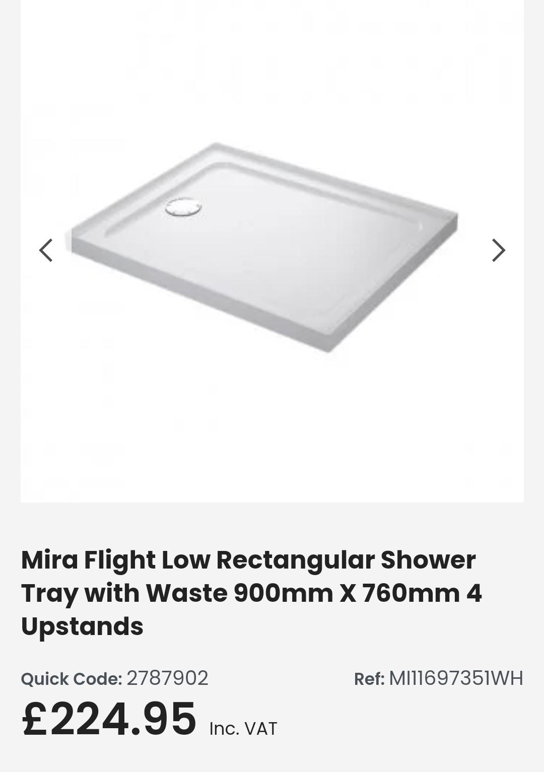

Iceverge Posted January 20 Share Posted January 20 I would consider a shower tray with an upstand too. Should make the floor to wall junction more robust. 1 Link to comment Share on other sites More sharing options...
SimonD Posted January 20 Author Share Posted January 20 27 minutes ago, Iceverge said: I would consider a shower tray with an upstand too. Should make the floor to wall junction more robust. Thanks, good shout, you've anticipated my next step and question. I have one stone shower tray for the guest bathroom already so will need to remind myself of the best waterproofing process - I know it's been covered to death so I'll try and do a search before asking for a repeat😊 Link to comment Share on other sites More sharing options...
