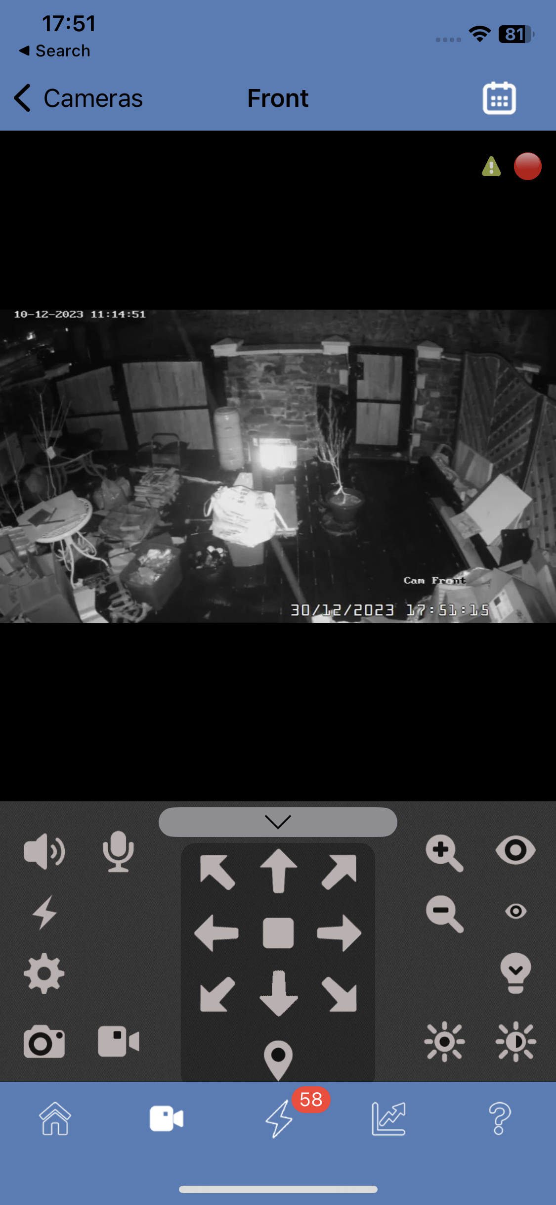

Pocster Posted December 30, 2023 Posted December 30, 2023 Put loads of shit in your front garden - deters the burglars…
Mr Punter Posted December 30, 2023 Posted December 30, 2023 On 30/12/2023 at 17:52, Pocster said: Put loads of shit in your front garden - deters the burglars… Expand That camera looks like it is to track anyone trying to leave...
Ferdinand Posted December 30, 2023 Posted December 30, 2023 On 30/12/2023 at 17:52, Pocster said: Put loads of shit in your front garden - deters the burglars… Expand Is this the @Pocster garden? And is the stuff previously nicked and thrown back over the fence in disgust? 🤠 1
Pocster Posted December 30, 2023 Posted December 30, 2023 On 30/12/2023 at 18:28, Mr Punter said: That camera looks like it is to track anyone trying to leave... Expand I have multiple cameras . I can see you leave , I can see you arrive . I can see you perform .
