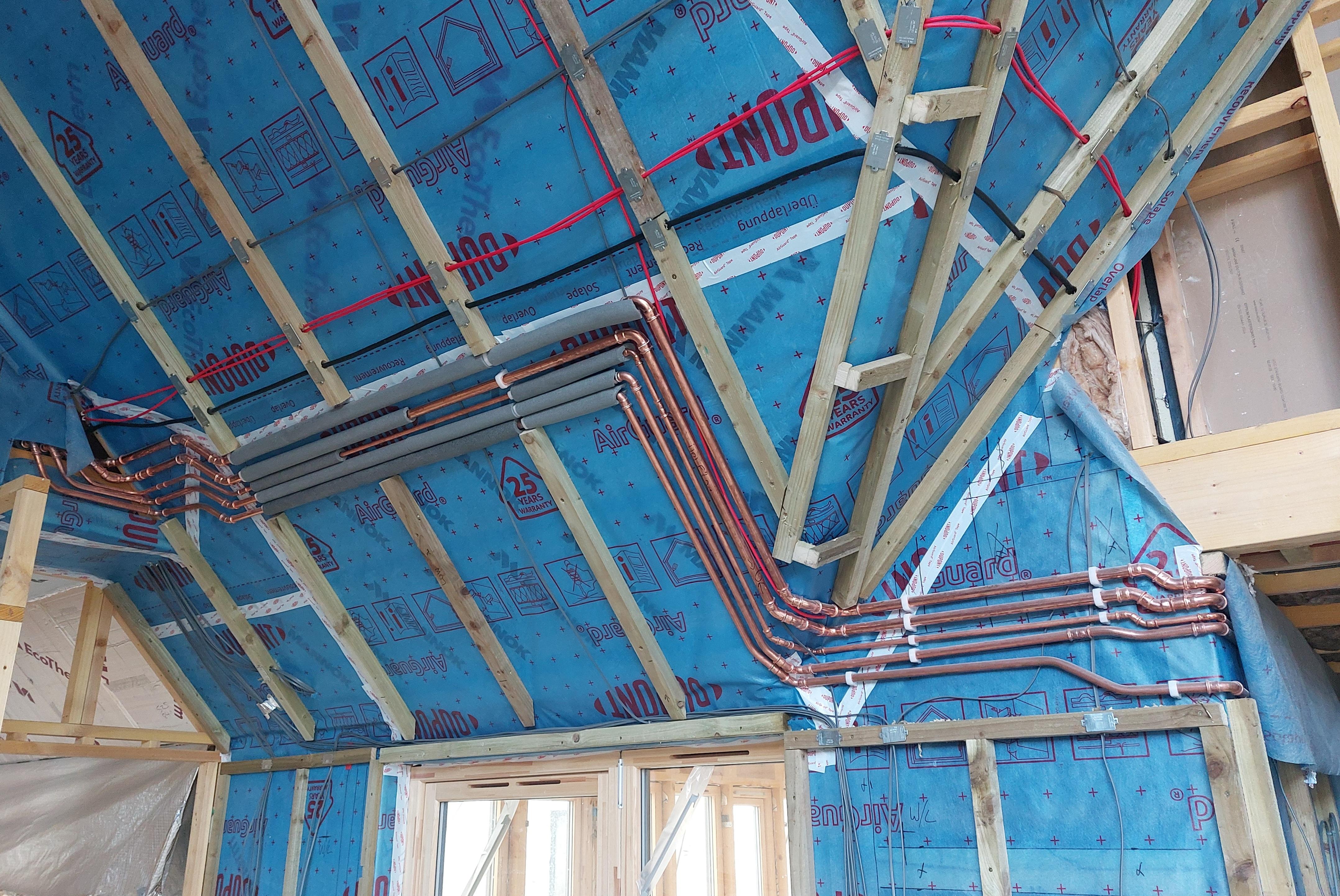

saveasteading Posted November 29, 2023 Posted November 29, 2023 The plumber is reluctant to insulate these hot and cold (and hot loop) pipes, although they have done in the cold attic. He says it isn't necessary in the warm side of the wall. They will be contained in the service gap. We think there will be condensation on the cold pipes, so they must be insulated as a minimum. Also heat exchange from hot to cold which is wasting energy, and not desirable anyway. And it will heat the service gap unnecessarily. 1. Are we wrong? 2. Is there a published standard to quote to hasten agreement?
markc Posted November 29, 2023 Posted November 29, 2023 I would say insulating makes perfect sense, hes right they won’t freeze but if they aren’t done it will grate on you for a very long time
JohnMo Posted November 29, 2023 Posted November 29, 2023 Building regs states you should insulate hot water recirculation. (Or pretty sure it does). Hope you do a good leak check on all these joints prior to plasterboarding.
Conor Posted November 29, 2023 Posted November 29, 2023 I'd be wanting a few more pipe clips up there. If it's a hot water recirculation system you absolutely would want to insulate. And insulate well. They are wasteful enough systems to start off with. 1
Andehh Posted November 29, 2023 Posted November 29, 2023 100% insulate the hot circulation pipe at the very least, otherwise it's basically a radiator dumping valuable heat in a non valuable space!! Im also 90% sure it's in the building regs to do it as well.... 1
saveasteading Posted November 29, 2023 Author Posted November 29, 2023 There appear to be recent stricter rules on the subject, which perhaps our plumber hasn't noticed. It's not easy reading so I will have to print and get the magic marker working. This commercial one is easier than the nhbc https://insulation-more.co.uk/blogs/the-pipe-duct-lagging-expert/new-guidance-on-pipe-insulation-for-domestic-heating-systems-2023?utm_source=shopsheriff&utm_medium=amp&utm_content=cookie-consent&_gl=1*1bkzay0*_ga*bHUwZUNCQnc0UnJOT21meGxKd2haYklyM3RkclhxcUhSRktweUtHWlJhU0tFYVpKdWVMWHFwLUV6NUF0Zl9tQw..# It seems that the rules were crazily relaxed and now are sensible, but still not strict enough to my mind.

Iceverge Posted November 29, 2023 Posted November 29, 2023 I would insulated the hot recirculation only. If you have a handle on the internal humidity the cold won't condensate. Insulating any other hot's is a bit of a waste of time. Tried to insulate my way out of an issue with 50mm pipe insulation but it still lost all it's heat in 15-20 mins.
Andehh Posted November 29, 2023 Posted November 29, 2023 6 minutes ago, Iceverge said: If you have a handle on the internal humidity the cold won't condensate. Insulating any other hot's is a bit of a waste of time. Tried to insulate my way out of an issue with 50mm pipe insulation but it still lost all it's heat in 15-20 mins. I did exactly the same, and have exactly the same loss. It still bugs me, massive insulation around the pipe, fastidiously applied... Nigh on bugger all difference! Grrr 1
Iceverge Posted November 29, 2023 Posted November 29, 2023 A new house might have a 1:1.25 ratio on internal volume:surface area with 200mm insulation. Running at a delta T of 15 deg maybe. A 15mm pipe will have an internal volume:surface ratio or over 1:400 and runs at a delta T of 30 with 10mm insulation. The pipe has proportionately 380 times more surface area to loose heat, twice the heat difference and 20 times less insulation. The numbers explain it all.

Thorfun Posted December 2, 2023 Posted December 2, 2023 I've read 'insulate the recirculation pipes' a lot but no one has every said why? if the HRC is turned on by some automated means, e.g. when someone walks in to a bathroom, then surely the insulation is not needed as the pump will turn on and get hot water to the tap for when the person who entered the bathroom needs it. unless that person is spending 15 minutes doing their business surely the water will still be hot by the time they need it?
SimonD Posted December 2, 2023 Posted December 2, 2023 2 hours ago, Thorfun said: I've read 'insulate the recirculation pipes' a lot but no one has every said why? if the HRC is turned on by some automated means, e.g. when someone walks in to a bathroom, then surely the insulation is not needed as the pump will turn on and get hot water to the tap for when the person who entered the bathroom needs it. unless that person is spending 15 minutes doing their business surely the water will still be hot by the time they need it? It's because the hot water is circulated around the pipework, usually at programmed times of high usage. It doesn't get pumped when someone opens the tap. Therefore, if it weren't insulated you lose a load of heat from the hot water circulating around the house and then going back into your hot water cylinder and cooling that down too. So you could in theory end uplosing all your hot water. Think of the recirculation pipework being an extension of your hot water cylinder.
Thorfun Posted December 2, 2023 Posted December 2, 2023 1 hour ago, SimonD said: It's because the hot water is circulated around the pipework, usually at programmed times of high usage. It doesn't get pumped when someone opens the tap. Therefore, if it weren't insulated you lose a load of heat from the hot water circulating around the house and then going back into your hot water cylinder and cooling that down too. So you could in theory end uplosing all your hot water. Think of the recirculation pipework being an extension of your hot water cylinder. but as @Iceverge said he'd tried insulating hot pipes and it didn't really help. so I still fail to see the point as the water in the HRC pipes still won't stay 'hot' for long, although obviously longer than without. I get that the cool water is recirculated back to the tank which could cool the water in the tank but in a 300l tank how much effect would the little in the pipes have on the large amount of water in the tank? I didn't bother insulating my HRC so I might've made a mistake but, tbh, I only ran the HRC as a 'just in case' scenario as most of my hot runs are relatively short so my dead cold leg might not be too bad. I will only find out once we're in and have lived with it for a while. and then if it is bad we can get the HRC working. if that means I have to run the ASHP a bit extra to top up the DHW cylinder then so be it.
JohnMo Posted December 2, 2023 Posted December 2, 2023 Think the insulation of hot water return piping is a bit of a historic issue or if you install without proper controls. If you run on a timer and thermostat at a time period you are likely to use the hot water, not much of an issue without insulation. If you want it running hot all the time, the heat loss us going to be ridiculous without insulation. Horses for courses really, use common sense. 1
Thorfun Posted December 2, 2023 Posted December 2, 2023 1 hour ago, JohnMo said: Think the insulation of hot water return piping is a bit of a historic issue or if you install without proper controls. If you run on a timer and thermostat at a time period you are likely to use the hot water, not much of an issue without insulation. If you want it running hot all the time, the heat loss us going to be ridiculous without insulation. Horses for courses really, use common sense. that was what I thought. and as we're having presence sensors in every bathroom I'm confident I can get our HA system to circulate the HRC when someone enters the bathroom so that hot water is ready once they've finished their business. it might work, it might not! at the end of the day it's not a massive issue if it doesn't and not something I will lose sleep over.
saveasteading Posted December 2, 2023 Author Posted December 2, 2023 All interesting. I think all hot pipes must be insulated. It used to be only outside the insulated envelope, but now it is everywhere, unless exposed pipes are intended to heat the room. I take people's points about the energy loss being small but that it depends on control. However, there is also comfort to be considered. When hot and cold are sitting together, they will average out and so the user of a shower may get surges of average temperatures that are uncomfortable, and perhaps even upsetting. Plus, people run a tap until it is the temperature they want, wasting water and energy, so if it is already warmer, then there is less waste. The NHBC document "technical guidance 8.1/35 is rather vague or ambiguous (to me) upon first and second readings. A paper on the subject by "Insulation and More" interprets it as saying we must "insulate almost everything....and buy it from us." 3. Hot Water Pipes Must be Insulated Whereas previous guidance focused mainly on space heating pipes, the new guidelines specifically mandate insulation on domestic hot water pipes. This includes hot water flow and return pipes, as well as primary circulation pipes connecting to hot water storage tanks. So i have now read 'the domestic building services compliance guide for Scotland (2022)' Section 9.3 is applicable. I think it is also saying to insulate all hot pipes wherever they are, except when it is exceptionally impracticable...(.and we designers should not allow it to be so) my italics Here is a bit of it: Direct hot water and heating pipework Pipework serving space heating and hot water systems should be insulated in all areas outside of the heated building envelope. In addition, pipes should be insulated in all voids within the building envelope and within spaces which will normally be heated, if there is a possibility that those spaces might be maintained at temperatures different to those maintained in other zones. The guiding principles are that control should be maximised and that heat loss from uninsulated pipes should only be permitted where the heat can be demonstrated as ‘always useful’. In a new system, all of the following new pipework should be insulated. a. Primary circulation pipes for heating circuits where they pass outside the heated living space, including where pipework passes into voids. b. All primary circulation pipes for domestic hot water. c. All pipes that are connected to hot water storage vessels, for at least 1 metre from the point at which they connect to the cylinder. d. All secondary circulation pipework that is kept hot by that circulation. Where a new boiler or hot water storage vessel is installed, or where existing systems are extended, new or existing pipes, ducts and vessels that are accessible or exposed as part of the work should be insulated as for new systems. Replacement hot water storage vessels should be insulated as for new systems. It is recognised that complete insulation will sometimes not be possible, where such services pass through or around structural building components, floor joists, for example, or where Domestic Building Services Compliance Guide for Scotland 2022 Edition 61 existing systems are wholly or partially retained as part of conversion works. In such cases, insulation should be fitted as for new systems as far as is reasonably practicable. Somewhere I read that similar rules will apply in England later this year, or next.

Thorfun Posted December 2, 2023 Posted December 2, 2023 1 hour ago, saveasteading said: unless exposed pipes are intended to heat the room most pipes will be behind plasterboard. I'd be interested to know how much heat from an uninsulated hot pipe would actually get through plasterboard and a skim! surely minimal, right? 1 hour ago, saveasteading said: When hot and cold are sitting together, they will average out and so the user of a shower may get surges of average temperatures that are uncomfortable, and perhaps even upsetting. is this really the case? we've used plastic throughout anti was my understanding that these lose less heat than copper and so even with a cold pipe sitting next to a hot pipe I'd be amazed if either had a noticeable effect on the other. and for showers in a new build surely the showers would have thermostatic valves in them so as to regulate the temperature and stop the fluctuations? 1 hour ago, saveasteading said: Plus, people run a tap until it is the temperature they want, wasting water and energy, so if it is already warmer, then there is less waste. agreed. this is why I was suggesting using a PIR to run the HRC when someone enters a room. I guess as is argued above if the HRC is uninsulated then the tank temp could be affected by putting cool water back in the tank but if the tank is being heated twice a day then I still think we're talking minimal impact on energy use to maintain the tank temperature. btw, I have absolutely no data to back up any of my points! I'm just hypothesising. I'm also not that fussed. if I have to run my ASHP a little extra each day then so be it. during the summer it'll be powered by solar and in the winter it'll be on most the day keeping the ufh at temp anyway. 🤷♂️
