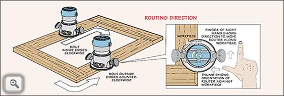

cherryfountain Posted November 10, 2023 Share Posted November 10, 2023 If it’s worktop you are cutting and the edge is on show ,cut it 10mm approx from line with jigsaw then finish with router and clamped straight edge.You then have an edge you can laminate . 1 Link to comment Share on other sites More sharing options...
joe90 Posted November 10, 2023 Share Posted November 10, 2023 19 minutes ago, cherryfountain said: If it’s worktop you are cutting and the edge is on show ,cut it 10mm approx from line with jigsaw then finish with router and clamped straight edge.You then have an edge you can laminate . Yes, only way to get a perfect edge is with a router and guide or clamped straight edge. Circular saw and fine (many) teeth second best and sanded with block. You must cut it face down if using a circular saw. 1 Link to comment Share on other sites More sharing options...
Alan Ambrose Posted November 12, 2023 Share Posted November 12, 2023 p.s. routers need to run in a particular direction. I only realised this a year or so ago, duh... Link to comment Share on other sites More sharing options...
