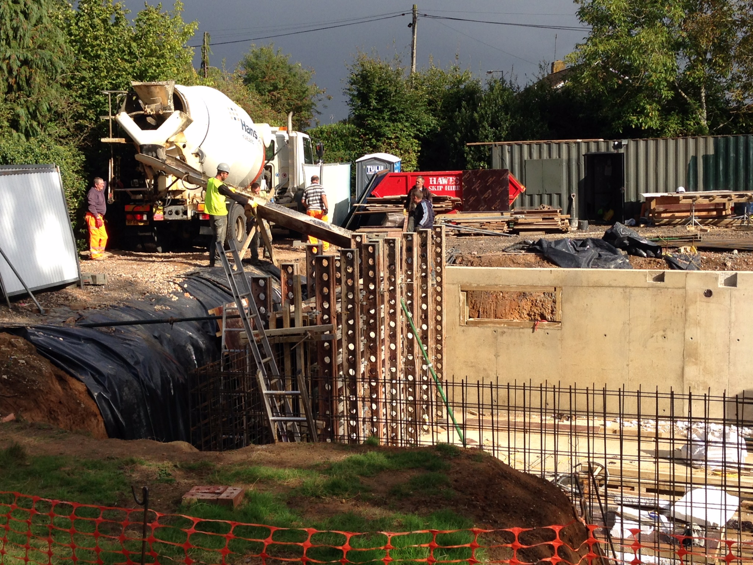

Bitpipe Posted September 8, 2017 Posted September 8, 2017 (edited) I was amazed at the amount of work that our basement team put into the formwork construction. The panels were very heavy duty (needed craned into position) and each one was custom made for the given pour, the steel threads & nuts that tied the panels together were also sizeable. For reference, each pour was about 2.7m high and about 2-3m wide. Ridges were built into the end sections to leave channel grooves to take the water-bar for the next section. Guys probably spent two days building the formwork for each pour (they did 2 sections simultaneously, a corner and a central panel). Not saying that you and your mate are not competent but I guess it a question of materials, time and the cost (and liability) if any pours go wrong - either a burst or a wall that is not true or waterproof etc. Edited September 8, 2017 by Bitpipe Better pics

mvincentd Posted September 8, 2017 Posted September 8, 2017 As Bitpite suggests, do not underestimate the complexity of shuttering and the heavy duty-ness of it. Part of my construction was 'single-sided' shuttering.....in other words too near a boundary for them to be able to form their usual shuttering so I had to create a sacrificial face to cast against. I used 18mm osb on vertical 4x2's which i concreted into the ground....then I added horizontal 4x2's...then i chocked it against the chalk face with more wood...and added more bracing where I could. The rc guys just laughed...well, rolled their eyes. When we'd done all we could with wood they added metal soldiers to tie my rear shutter to their front shutter....then they added huge diagonal push-pulls so they could wind the whole structure back during the pour to keep it vertical. Their front shutters are also held in place by captive bolts that were cast into the kicker along with the slab...helping to fight the lifting forces that the poured concrete exert on the shuttering. This is the tip of the iceberg as far as the complexity and intricacy of the shuttering work goes. They were on a fixed price...i don't think they'd do all this stuff if it wasn't necessary. One of my vertical 4x2's still snapped during the pour, thankfully to no significant effect.

Simplysimon Posted September 9, 2017 Posted September 9, 2017 @Triassic, i'm sure you're aware, as the formwork goes higher the pressure at the bottom increase. if you do it yourself you will need steel formwork, yes it can be done with timber as @mvincentd did and has been done for years before steel came along, but it is a big job, and shuttering is a specialised trade. if it were me i'd go with icf, shutter it and insulate it in one go. simon

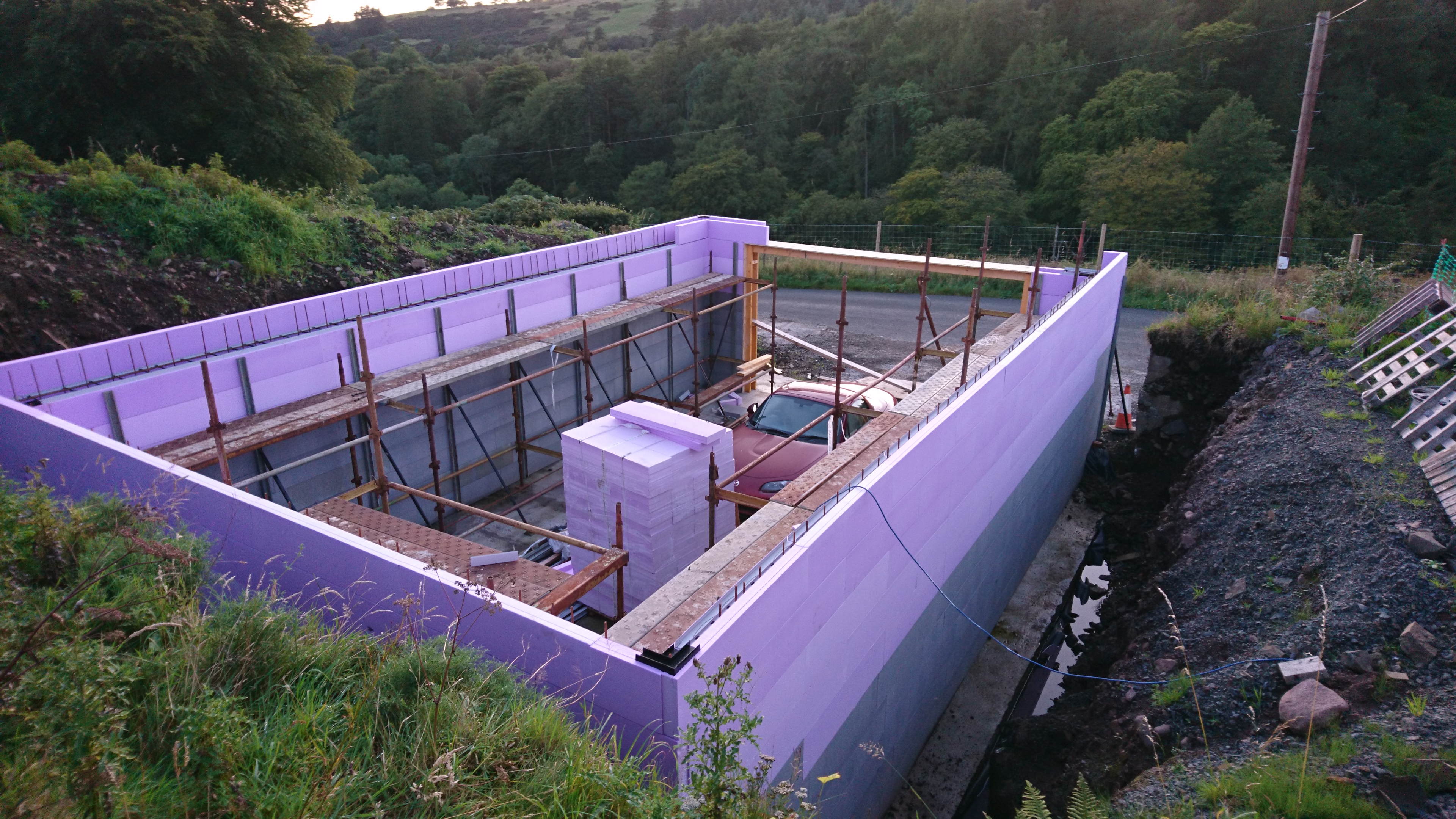

Triassic Posted September 10, 2017 Author Posted September 10, 2017 So if I went down the ICF route, which product is the best, in terms of easy of use and value for money etc?

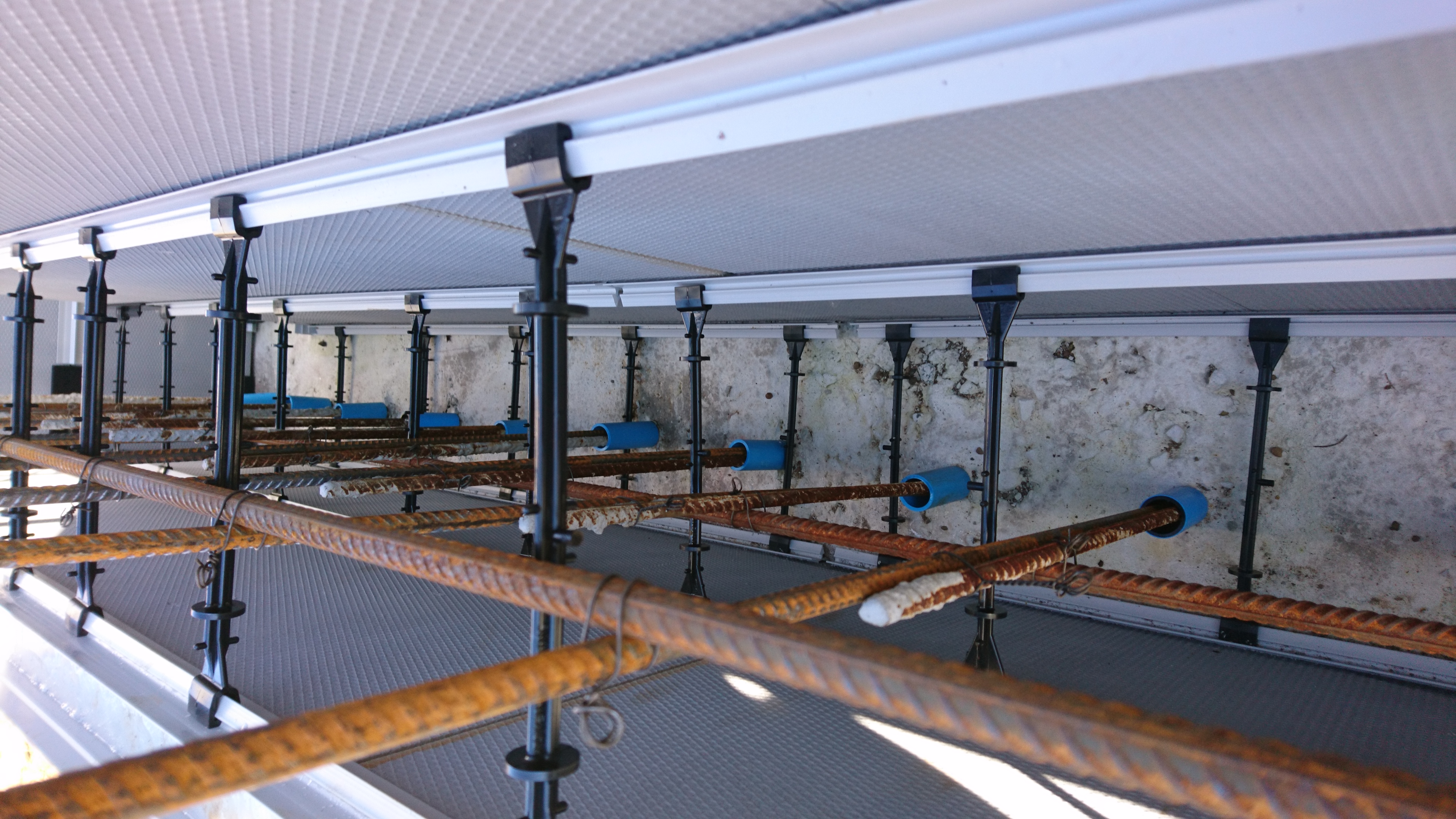

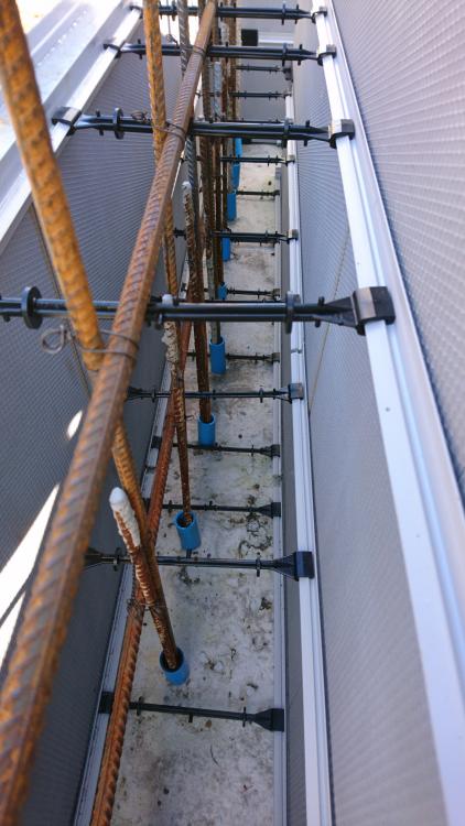

PeterW Posted September 10, 2017 Posted September 10, 2017 Polarwall, Nudura and Beco are pretty much the only ones I've seen with decent technical credentials for basements although Beco seem to be fallout by the wayside. The others can have variable core widths to allow for structural support to be correctly calculated.
Triassic Posted September 10, 2017 Author Posted September 10, 2017 8 minutes ago, PeterW said: Polarwall, Nudura and Beco are pretty much the only ones I've seen with decent technical credentials for basements although Beco seem to be fallout by the wayside. The others can have variable core widths to allow for structural support to be correctly calculated. The SE has calculated a core width of 200mm, I assume I just send my drawings to the ICF companies, along with Insulation requirements and they do the rest.
Alexphd1 Posted September 10, 2017 Posted September 10, 2017 We used nudara and as long as there still price competitive we will be using them again in build 2.
ToughButterCup Posted September 10, 2017 Posted September 10, 2017 36 minutes ago, Triassic said: Now that I'm getting back the full swing of self Build, I'll take you up on that offer. I'm busy this week, so maybe sometime next week if possible PM me. I'm around most of the time.
jamiehamy Posted September 10, 2017 Posted September 10, 2017 14 minutes ago, Triassic said: The SE has calculated a core width of 200mm, I assume I just send my drawings to the ICF companies, along with Insulation requirements and they do the rest. Pretty much. Has the engineer provided the details of the reinforcements? Or just a 200mm core? We've just about finished our garage walls with mesh up inside the 250mm core. Was very straightforward. Rather than try build with mesh itself, we used rebar and tied it as we went up. The slowest part was the tying - lesson for next time is to hire or by a tool for it as it was very slow. Attached pic shows how we did it - braced from inside. We had rebar sticking out the slab 500mm. I put. down three courses of Polarwall before sticking the vertical bars in and tying. Then we laid bars on each course of icf ties as we went up. The ladders slipped over the top of the rebar and down. Financed permitting we will pour in the next few weeks. 1
