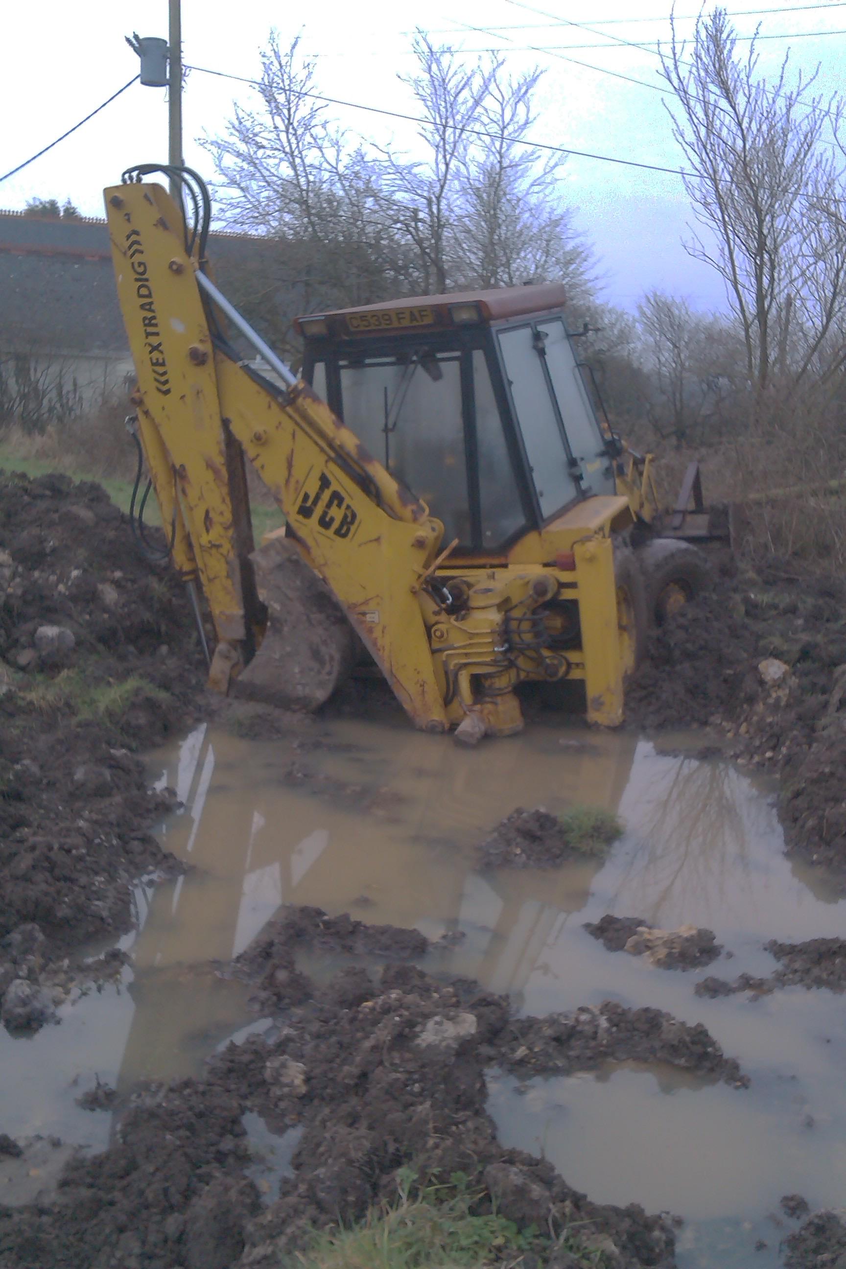

ProDave Posted October 22, 2023 Share Posted October 22, 2023 What do you mean by a "backhoe loader" and "Seems like best of mini digger and dumper in one?" Any pictures or examples of what you mean? Or do you mean a simple JCB C3X etc? JCB's are good, but heavy and being wheel drive rather than track will chew up a soft / wet site in no time. 1 Link to comment Share on other sites More sharing options...
joe90 Posted October 22, 2023 Share Posted October 22, 2023 I bought a 3cx fir my build, cheap and luckily didn’t go wrong (much), yes it’s heavy and chews the ground up and we had the room. In addition to that it was the greatest fun to drive and always on site so available at short notice for multiple jobs from unloading pallets with the forks, digging trenches as a crane and I had a fair bit of ground to level. Not sure if it was cost effective re hiring but I loved owning it 😎. 1 Link to comment Share on other sites More sharing options...

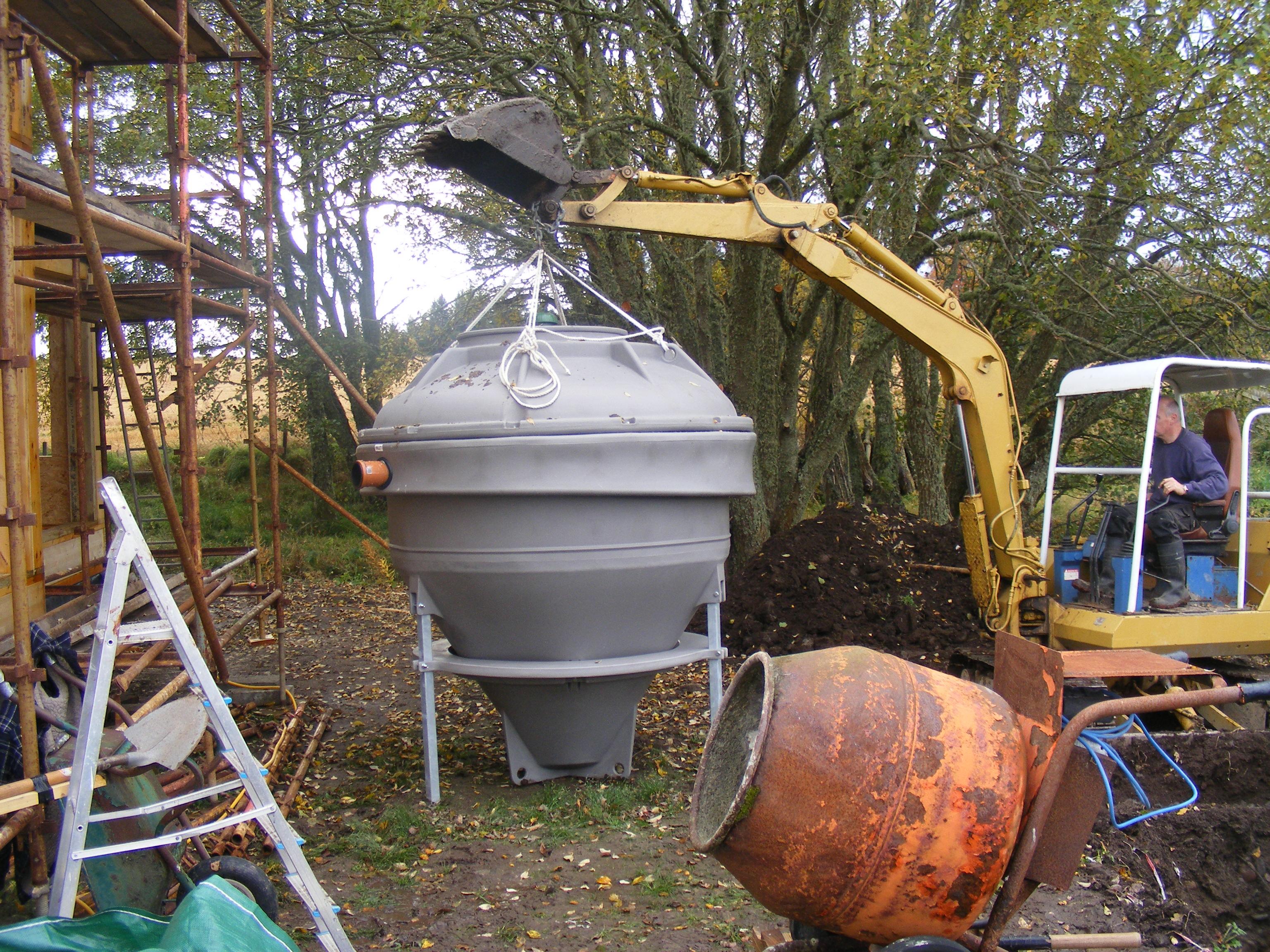

ProDave Posted October 22, 2023 Share Posted October 22, 2023 I bought a very old Kumatsu 3t 360 on steel tracks for my build. I was looking for anything that was cheap and local and bid a silly low price on this one, then went out and blow me down when i got back I found i had won it. It was old, all the joints were worn and it had a Peugeot car engine bodged in in place of the original. But it worked and did everything I asked it to, and i sold it for exactly what i paid for it. 1 Link to comment Share on other sites More sharing options...
Duncan62 Posted October 22, 2023 Author Share Posted October 22, 2023 (edited) 1 hour ago, Mr Punter said: I think it is often better to hire a decent sized (4-8 tonne) tracked excavator if it you are doing a one-off house. About £500 a week for a machine worth about £50k. You could do foundations and drains for most self builds in 2-3 weeks. If anything goes wrong the hire firm will sort it. This is the best attempt at talking me out of it so far @Mr Punter. All makes perfect sense. Spend £2k and have a BIG digger for a month. Everyone else, please stop showing me pictures of your machinery... It's not talking me out of it =p Edited October 22, 2023 by Duncan62 Link to comment Share on other sites More sharing options...
ProDave Posted October 22, 2023 Share Posted October 22, 2023 The best bit of buying your own digger is it is there, all the time. I had mine about 3 years, not only did it get used for all the digging tasks, foundations, drainage, treatment plant, landscaping, it was damned handy having it there to be used any time you wanted it. Often it would just get 5 minutes work to move something, you can't hire a digger in for that. 2 Link to comment Share on other sites More sharing options...

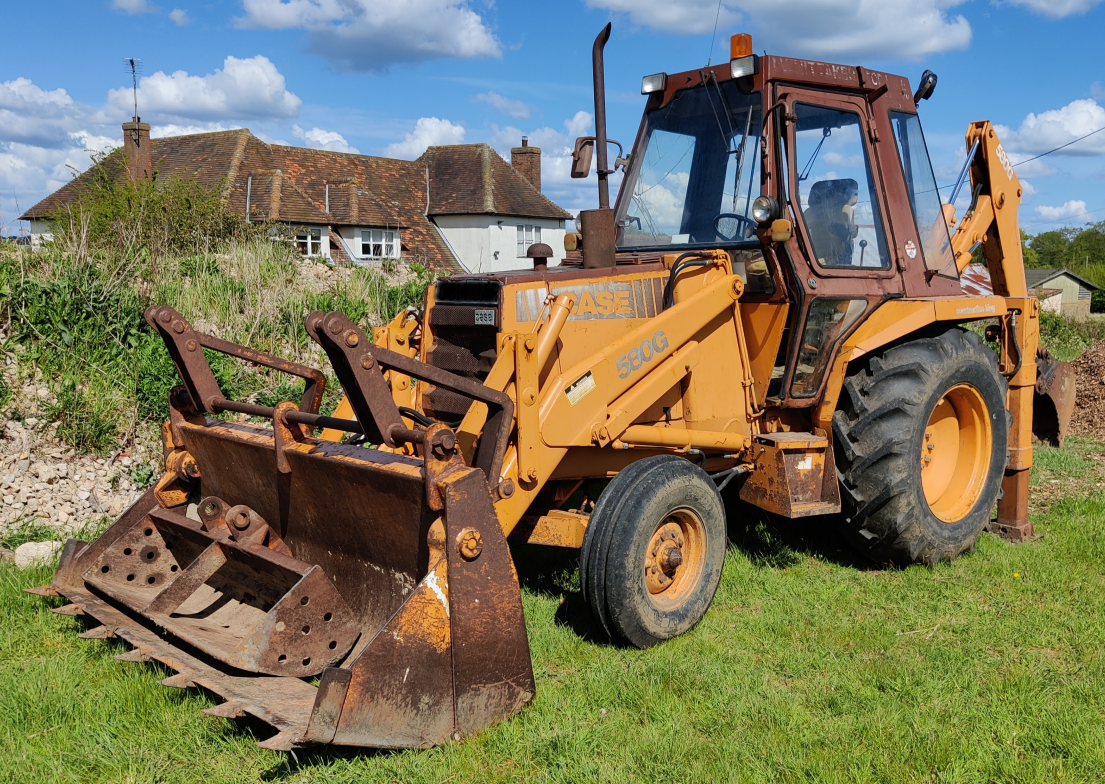

IanR Posted October 22, 2023 Share Posted October 22, 2023 I felt a cheap Backhoe loader was very handy to have around, although I still brought in the right size 360 machine for quite a few jobs. For the same age and condition the Case 580 are a little cheaper than the JCB 3CX and the Ford 550 are cheaper again. I paid £4.5K for mine, and it has needed a few hoses replacing. Smokes a bit but still loads of power. Good for clearing and grading as well as moving stuff around, but mine has very worn pins. If I was to buy again I'd go for 4 wheel drive, extending backhoe and a £10K budget. I can't tell you if they're easy to sell as I've always got another job in mind for it, but it seems there're are plenty of people looking for them, as I've had a couple of locals try and buy it off me. Link to comment Share on other sites More sharing options...
