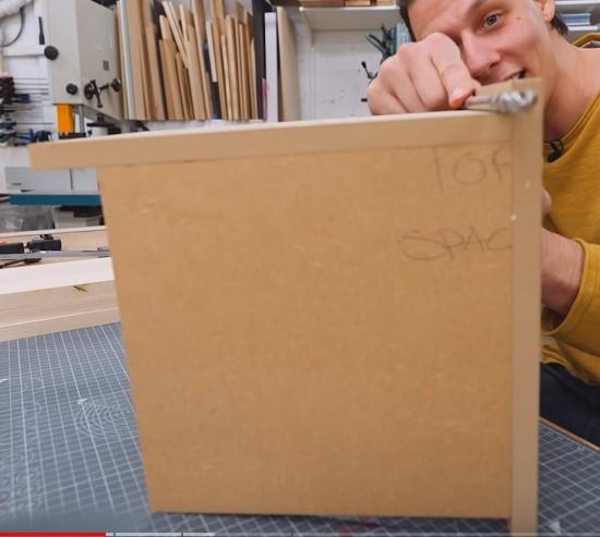

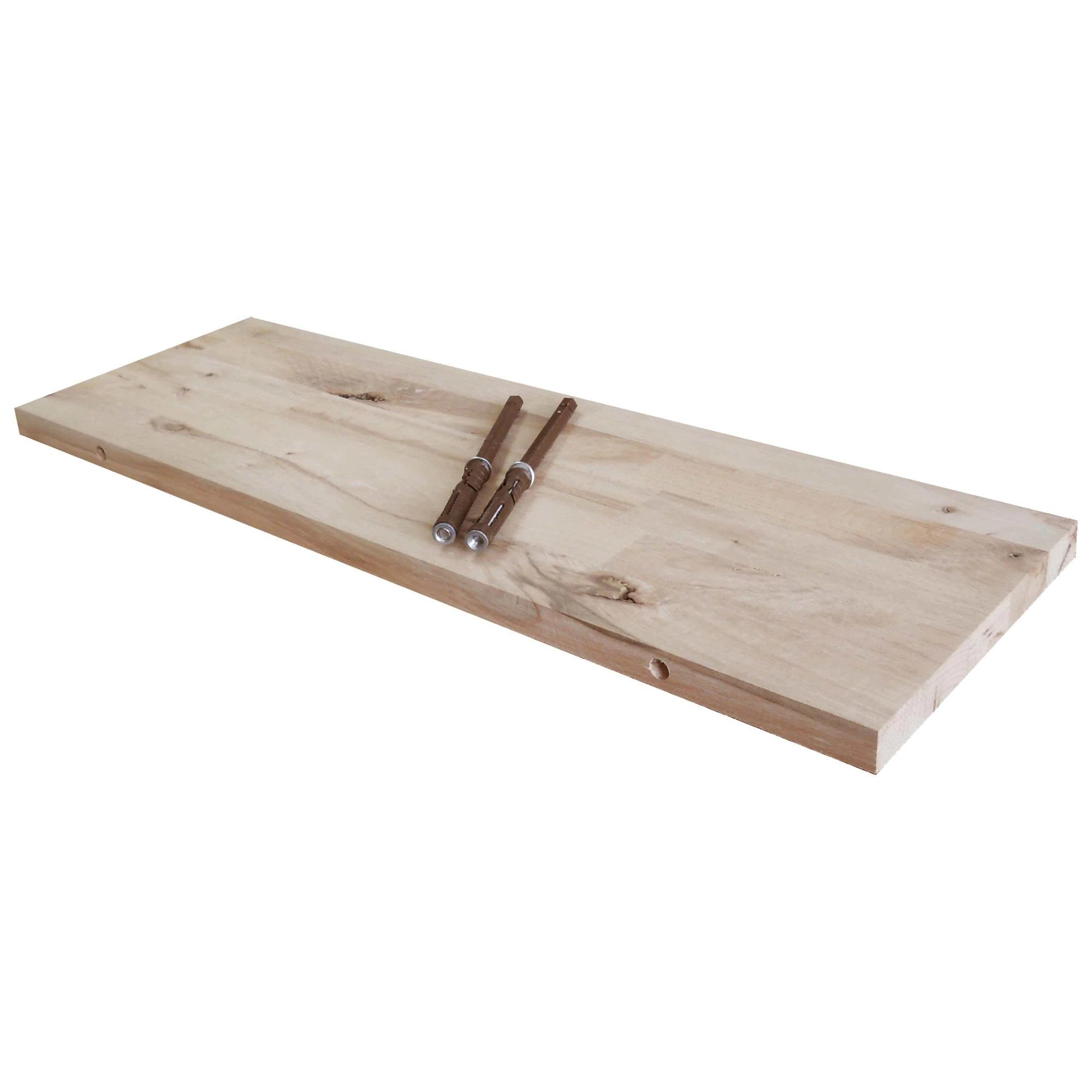

DanBog Posted October 21, 2023 Share Posted October 21, 2023 My walls are made of concrete and AAC. Until now, I never really needed much precision. However, my holes are never parallel or straight. I’ve got some floating shelves that I need to attach. I figured I’d put together a jig like this guy from YouTube (though upon rewatching, I noticed he’s only using glue). As I was trying to drill through these boards, I realized that I’m not very good at measuring accurately through wood also. I feel a bit overwhelmed by this. It can’t be that hard; many people do it. Now, I’m just sitting here, looking at the shelves and waiting for ideas on how to install them without them being crooked. Link to comment Share on other sites More sharing options...

ProDave Posted October 22, 2023 Share Posted October 22, 2023 Has nobody mentioned making a jig? You want to drill 2 holes in the shelf, and 2 holes in the wall, exactly the same distance apart and level. So take one bit of scrap wood, at least as long as the distance between the to holes plus a bit. Mark the holes on that bit of wood and drill a hole the size you want. Making sure the marking is accurate, and before starting to drill the hole make a centrepunch mark, ideally with a centrepunch failing that a nail, hold the point exactly on your pencil park then hit it gently with a hammer to make a dent to stop the drill wandering. Then use the jig to drill the holes in the shelf and the holes in the wall, getting an assistant to hold the jog dead level on the wall before drilling. 2 Link to comment Share on other sites More sharing options...

DanBog Posted October 23, 2023 Author Share Posted October 23, 2023 17 hours ago, ProDave said: Has nobody mentioned making a jig? This is a great idea, I actually have a longer piece of OSB that I can use for this, it'll also help me drill at the same distance for all my shelves. Link to comment Share on other sites More sharing options...
