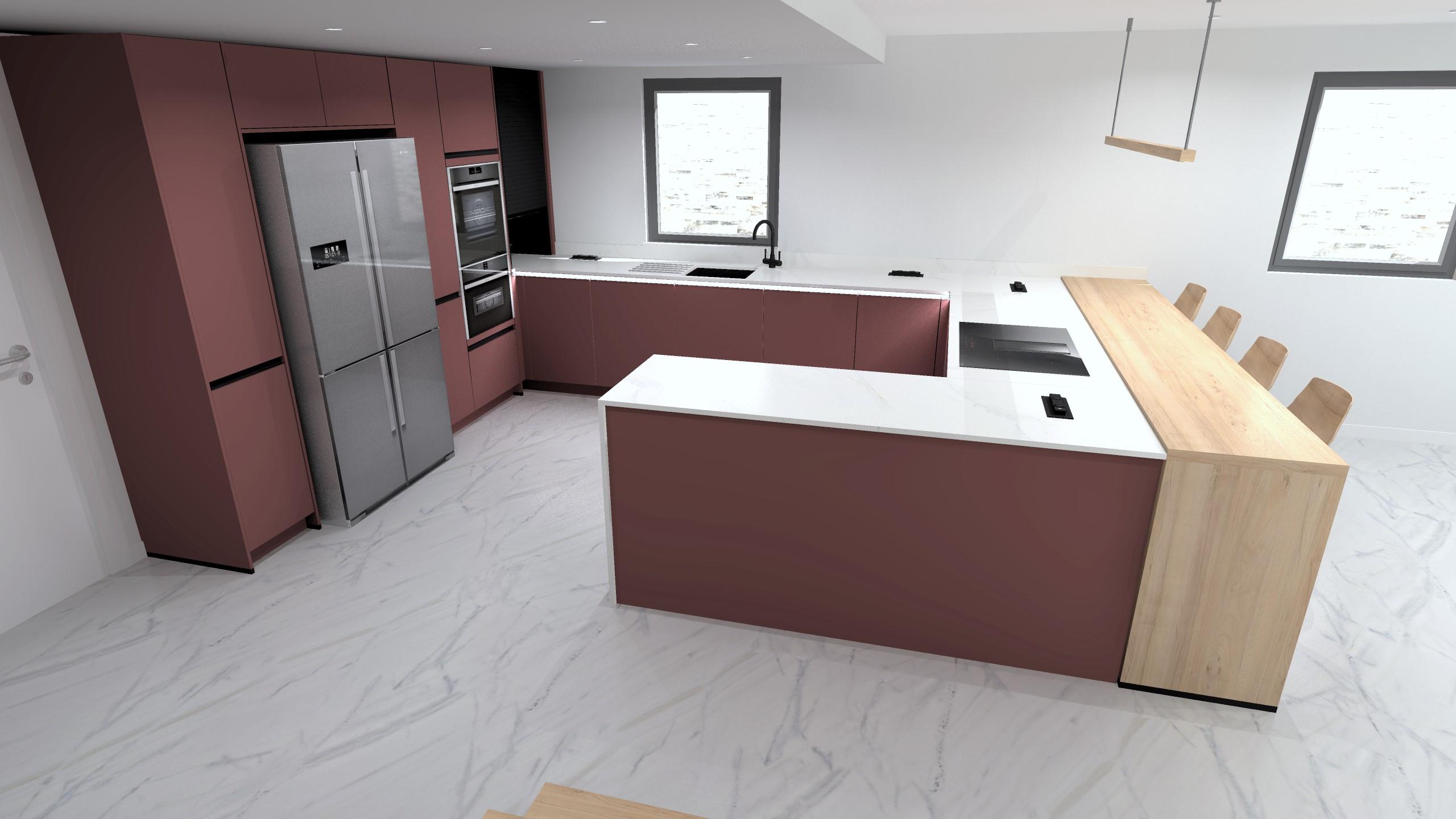

Pocster Posted October 7, 2023 Share Posted October 7, 2023 Getting ready ( ok it’s months away ) to fit the kitchen . All easy enough I think but there is a long worktop run around 3m with a return of around 1m Right in the middle of the room so not a lot to fix to . Can’t bolt to the floor as ufh . Was thinking of some kind of timber brace that runs under this run - but not sure of best approach. Appreciate once quartz worktop is on it ain’t moving anywhere but feel much happier if this L shaped set of units is mofo solid without worktop . Link to comment Share on other sites More sharing options...
Pocster Posted October 7, 2023 Author Share Posted October 7, 2023 Easier I guess with a piccy Link to comment Share on other sites More sharing options...
joe90 Posted October 7, 2023 Share Posted October 7, 2023 4 of these (one in each corner) of every cabinet join https://www.screwfix.com/p/inter-screws-m4-x-10-pack/65152 perhaps a length of 3x2 screwed underneath along the front (behind where the feet will go) and one along the back underneath 🤷♂️. 1 Link to comment Share on other sites More sharing options...
ProDave Posted October 7, 2023 Share Posted October 7, 2023 I would not rely on the standard plastic cabinet feet to secure a peninsular unit like that. Okay when the units are along and fixed to a wall, the feet just take the weight. A joiner I know and respect never uses the standard plastic feet, instead he makes a rigid "box" for the cabinets to sit on, far more stable. Link to comment Share on other sites More sharing options...
Pocster Posted October 7, 2023 Author Share Posted October 7, 2023 32 minutes ago, joe90 said: 4 of these (one in each corner) of every cabinet join https://www.screwfix.com/p/inter-screws-m4-x-10-pack/65152 perhaps a length of 3x2 screwed underneath along the front (behind where the feet will go) and one along the back underneath 🤷♂️. The inter screws come with it . But yeah some timber box underneath sounds good Link to comment Share on other sites More sharing options...

Mr Punter Posted October 7, 2023 Share Posted October 7, 2023 2 hours ago, ProDave said: I would not rely on the standard plastic cabinet feet to secure a peninsular unit like that. Okay when the units are along and fixed to a wall, the feet just take the weight. A joiner I know and respect never uses the standard plastic feet, instead he makes a rigid "box" for the cabinets to sit on, far more stable. I like the plastic feet. Makes the units easy to adjust and often the plinth clips on. Once adjusted, two small screws stops them moving. Also you have lots of space to run cables, dishwasher feeds etc. I like to have sockets under units on flex, which makes appliances easy to install. Link to comment Share on other sites More sharing options...

FuerteStu Posted October 7, 2023 Share Posted October 7, 2023 (edited) What about using a chaser set at 30mm just back from the kickboard, and set a 25x50mm timber in resin in floor. Would stay clear of the UFH, and give you a substantial fixing point. Both vertical and horizontal Edited October 7, 2023 by FuerteStu Link to comment Share on other sites More sharing options...
Big Jimbo Posted October 7, 2023 Share Posted October 7, 2023 What ever you do, don't drill the bloody floor. Unless the plastic feet are complete cheap shite, they will be fine. 100 plus kitchens fitted with granite on plastic feet. Never had a problem bud Link to comment Share on other sites More sharing options...

Pocster Posted October 8, 2023 Author Share Posted October 8, 2023 I’m not worried about the plastic feet . Just don’t want the L of units to move . Link to comment Share on other sites More sharing options...
joe90 Posted October 8, 2023 Share Posted October 8, 2023 13 hours ago, Big Jimbo said: What ever you do, don't drill the bloody floor. Unless the plastic feet are complete cheap shite, they will be fine. 100 plus kitchens fitted with granite on plastic feet. Never had a problem bud We’re any freestanding? It would worry me, having fitted many kitchens, i find the plastic adjustable feet fine in compression but unsure about their stability without a wall 🤷♂️ Link to comment Share on other sites More sharing options...
TonyT Posted October 8, 2023 Share Posted October 8, 2023 Built up the underside of they it’s with timber, will give the deco panel something to fix to, do the same behind the kick plate muse the feet to level off first then apply timber infill Link to comment Share on other sites More sharing options...
Bozza Posted October 8, 2023 Share Posted October 8, 2023 We had exact same issue with an island unit 1800x1200, also with quartz worktop. No nails was my friend, to fix the plastic legs to the floor. The island hasn’t moved. Frankly it was heavy enough that it probably wouldn’t have moved anyway. Your peninsular will additionally be braced by the the worktop. if still worried other option would be to construct a timber underneath, no nailed to floor and bottom of cabinets. no nailed legs will be fine though unless your units / legs are poor quality/wobbly. 1 Link to comment Share on other sites More sharing options...
