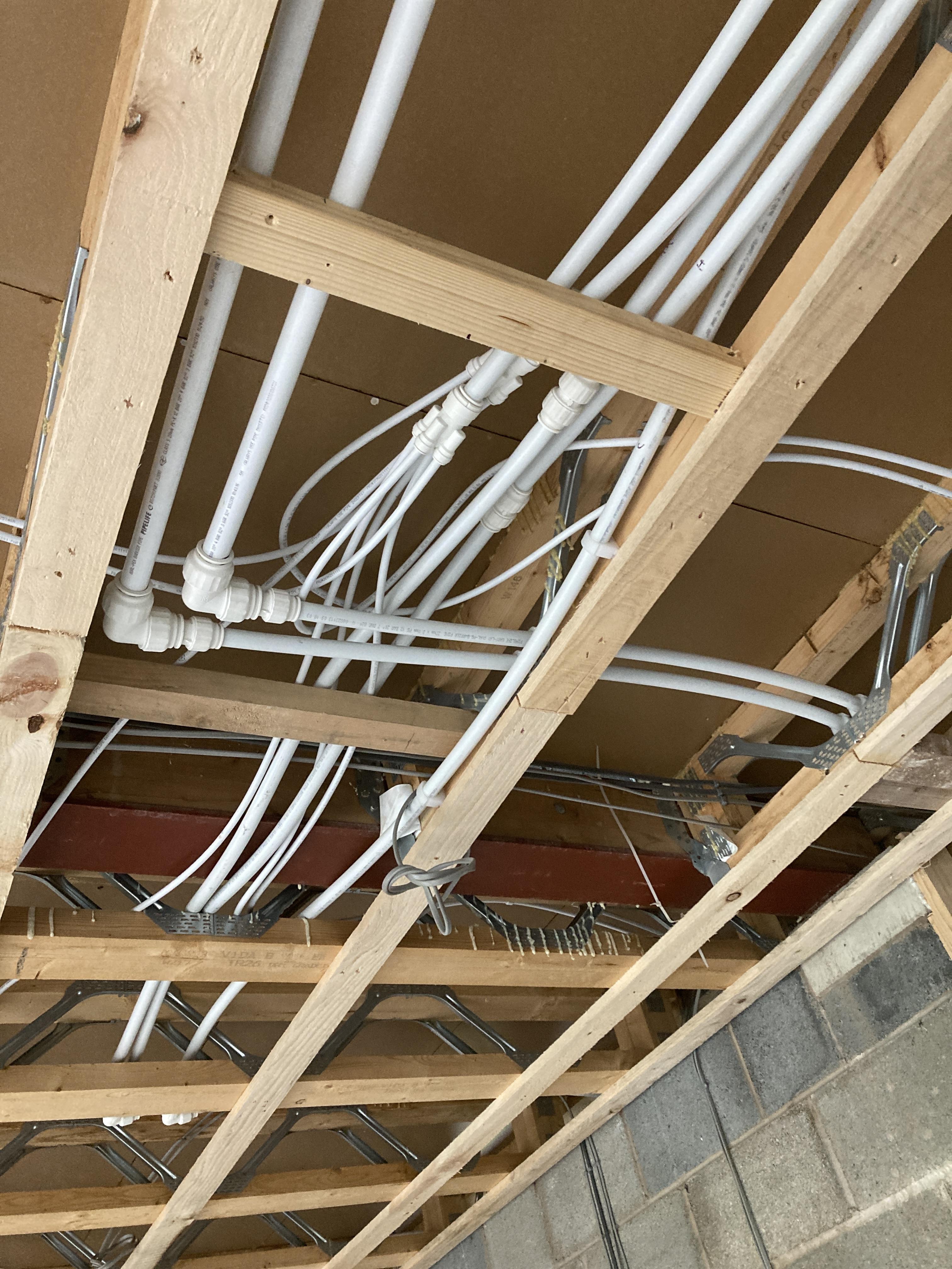

nod Posted September 24, 2023 Share Posted September 24, 2023 1 hour ago, BotusBuild said: It's time to fit my hot and cold water pipes. I've decided on the manifold and plastic pipe approach. I like the idea of coloured pipe (red/blue). Which suppliers can you recommend please. Cheers Stuart While I’m not a plumber I’ve been doing ours for the last couple of weekends The manifolds make things much easier can’t help you on the coloured pipes 1 Link to comment Share on other sites More sharing options...

nod Posted September 24, 2023 Share Posted September 24, 2023 1 hour ago, Big Jimbo said: @nod Don't forget that the new building regs require that all the hot pipe, (even within the heated envelope) are lagged now. Yeah cheers Once I’ve air tested I’ll get my wife on it 😁 1 2 Link to comment Share on other sites More sharing options...
Pocster Posted September 24, 2023 Share Posted September 24, 2023 1 hour ago, nod said: Yeah cheers Once I’ve air tested I’ll get my wife on it 😁 If that a euphemism???? - asking for a friend . 1 Link to comment Share on other sites More sharing options...
dpmiller Posted September 24, 2023 Share Posted September 24, 2023 @nod will all those JG pushfits be hidden behind PB? The Welshman may have a view on that. Link to comment Share on other sites More sharing options...
nod Posted September 24, 2023 Share Posted September 24, 2023 1 hour ago, dpmiller said: @nod will all those JG pushfits be hidden behind PB? The Welshman may have a view on that. As with our previous build everything hidden The only thing have done differently is Put 28 mil piping in for the heating Ill be honest I first put 22 mil in then removed it and replaced with 28 As I’ve said I’m not a plumber 😁 Only one fitting dripped last time and never showed up til the heating went on Link to comment Share on other sites More sharing options...

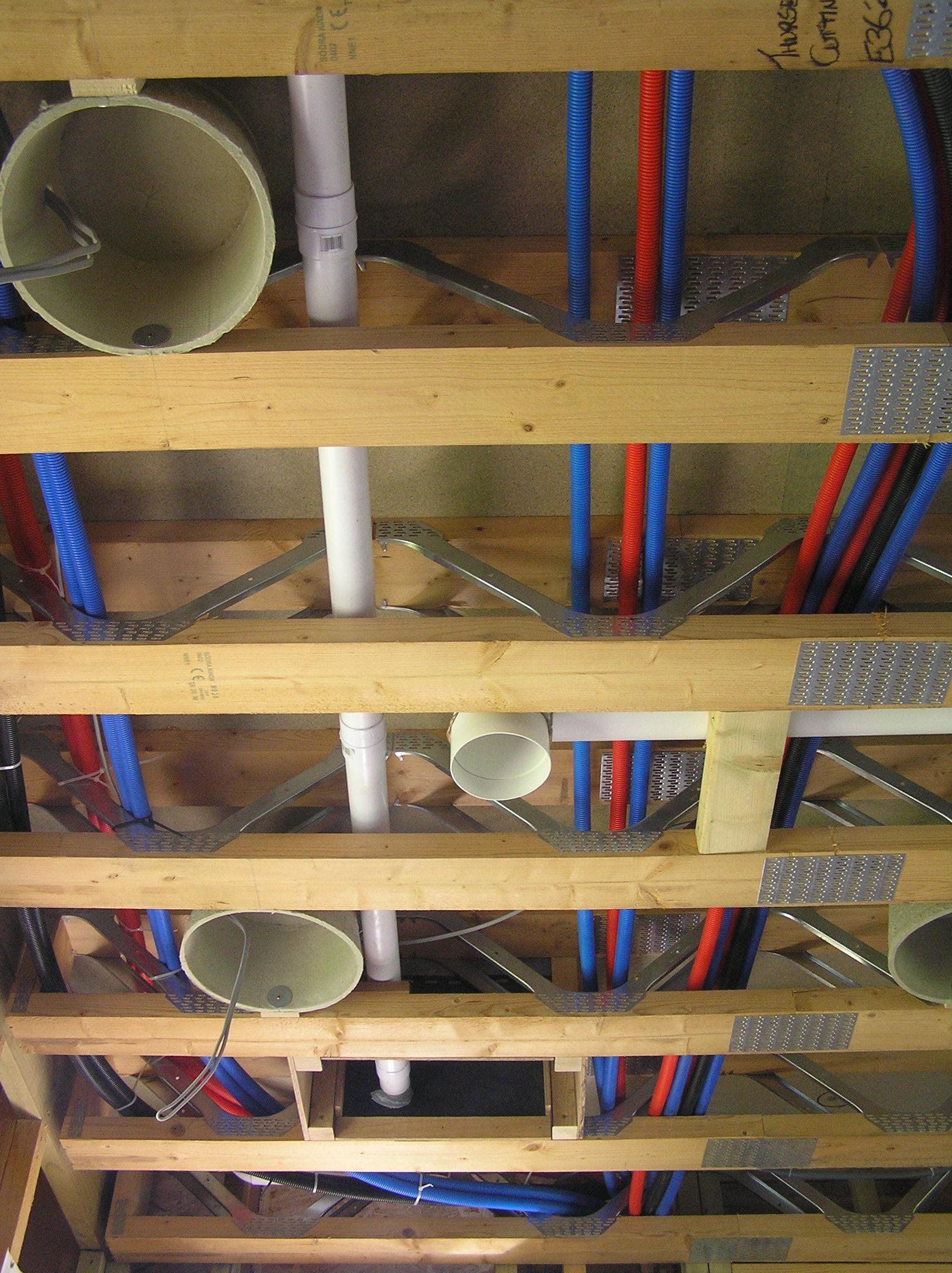

Gone West Posted September 25, 2023 Share Posted September 25, 2023 I used red and blue conduit for my water pipes, so it was easy to check my first fix was ok. 2 Link to comment Share on other sites More sharing options...
Nickfromwales Posted September 26, 2023 Share Posted September 26, 2023 On 24/09/2023 at 19:46, dpmiller said: @nod will all those JG pushfits be hidden behind PB? The Welshman may have a view on that. I’ve been planning a suitable punishment lol. @nod, please tell me that you’re going to put all the locking collets onto every SINGLE fitting?! If not, the punishment will have to be quite severe, sorry. 1 Link to comment Share on other sites More sharing options...
Gone West Posted September 26, 2023 Share Posted September 26, 2023 5 minutes ago, Nickfromwales said: please tell me that you’re going to put all the locking collets onto every SINGLE fitting It is the only way 😃. 3 1 Link to comment Share on other sites More sharing options...
