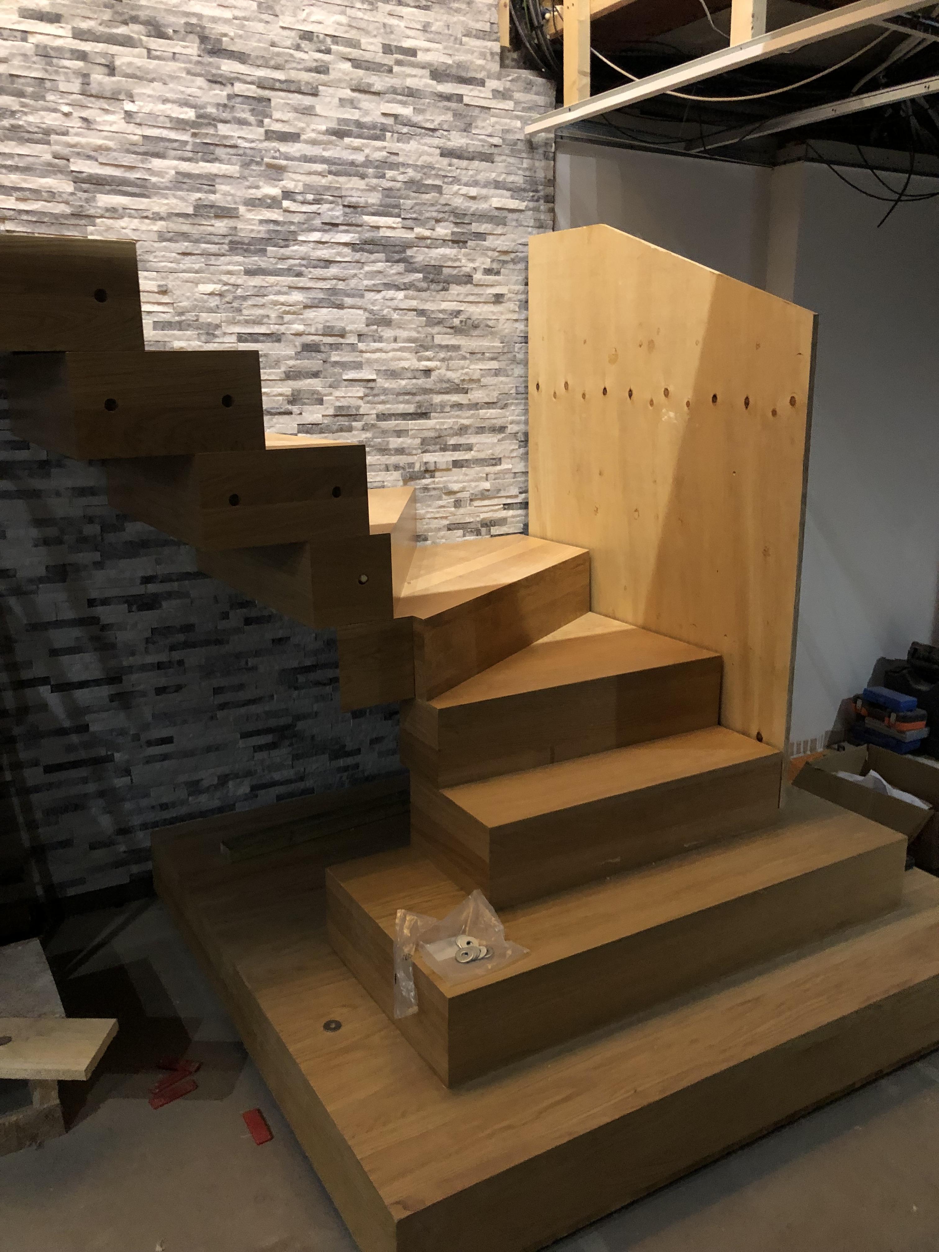

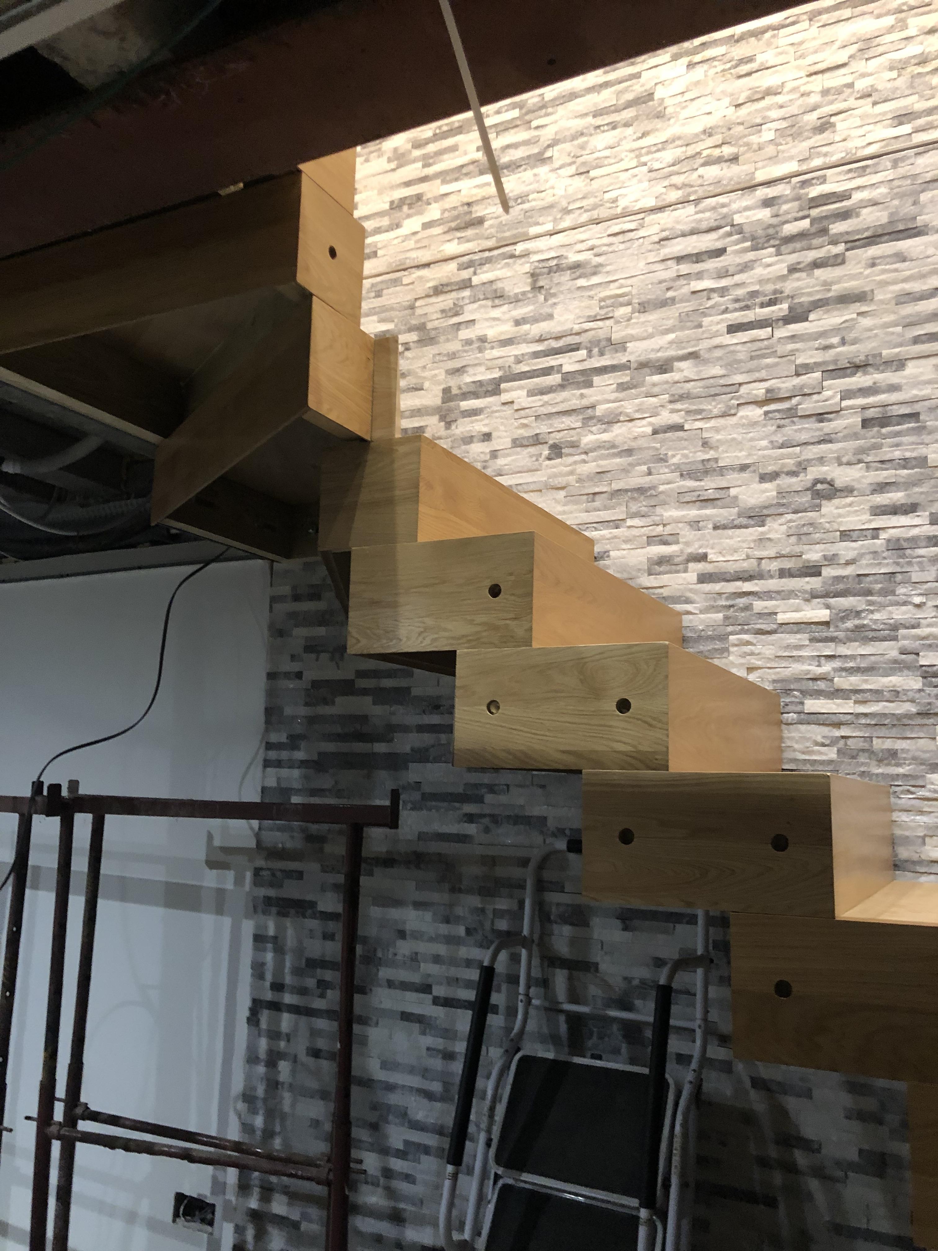

Pocster Posted September 6, 2023 Share Posted September 6, 2023 Not complete . Glazing on sides to go in later - very happy with it so far . 13 Link to comment Share on other sites More sharing options...
Pocster Posted September 6, 2023 Author Share Posted September 6, 2023 4 Link to comment Share on other sites More sharing options...
joe90 Posted September 6, 2023 Share Posted September 6, 2023 How are those parts/steps held together? Link to comment Share on other sites More sharing options...
Pocster Posted September 6, 2023 Author Share Posted September 6, 2023 7 minutes ago, joe90 said: How are those parts/steps held together? I’d say magic but it’s not true ! . There’s a steel frame on the far side ( between tiled wall and stairs . They are effectively cantilevered . But each box rests on the previous so ultimately the ‘strain’ is taken from the big bottom step ( has a good chunk of timber and steel in it ) 1 1 Link to comment Share on other sites More sharing options...

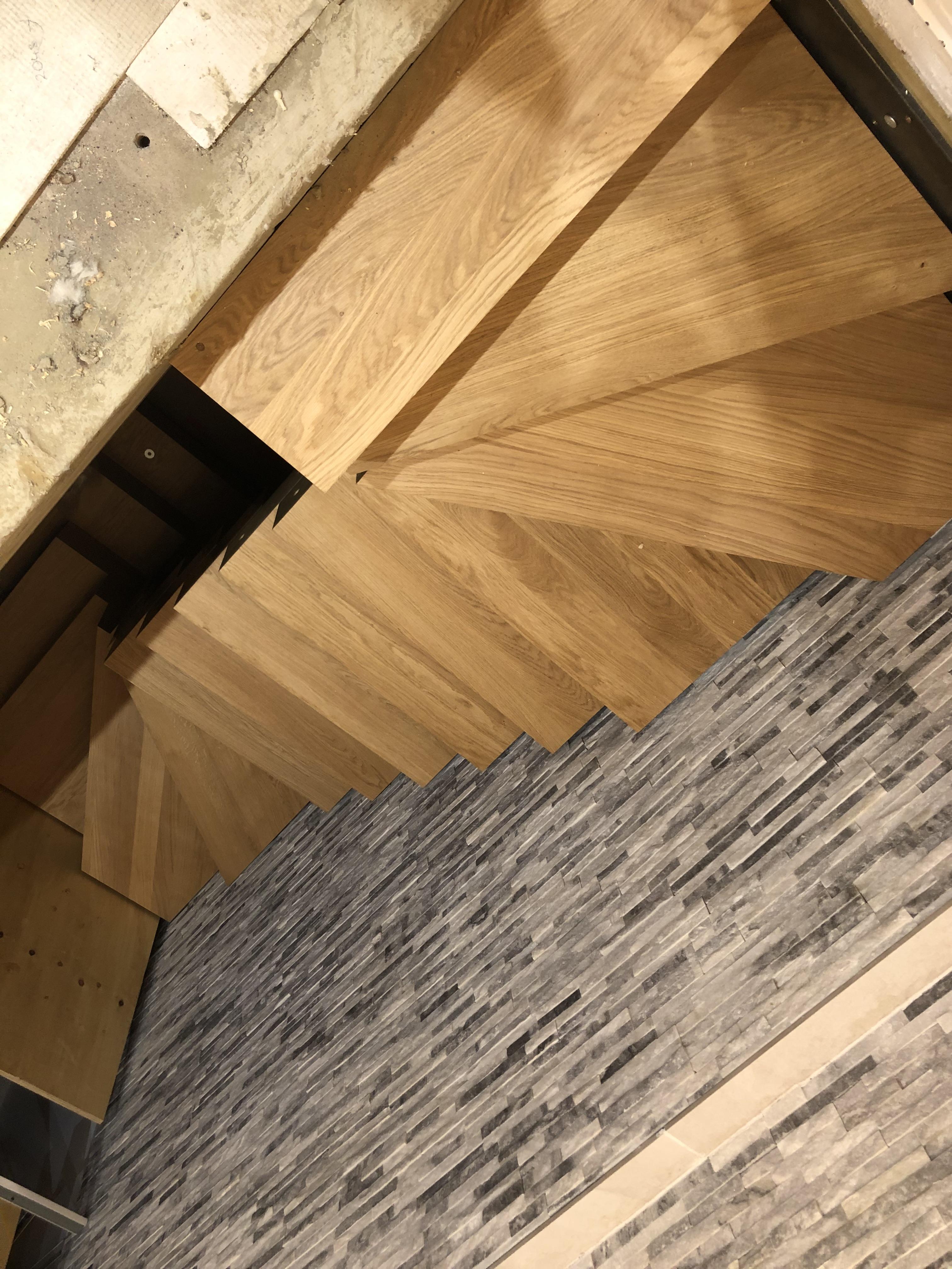

ToughButterCup Posted September 7, 2023 Share Posted September 7, 2023 13 hours ago, Pocster said: ... For UcksSake @Pocster, what , how, where, were you when you took this photo? Upside down and hanging from your perch? Despite that, they look gorgeous. 2 Link to comment Share on other sites More sharing options...

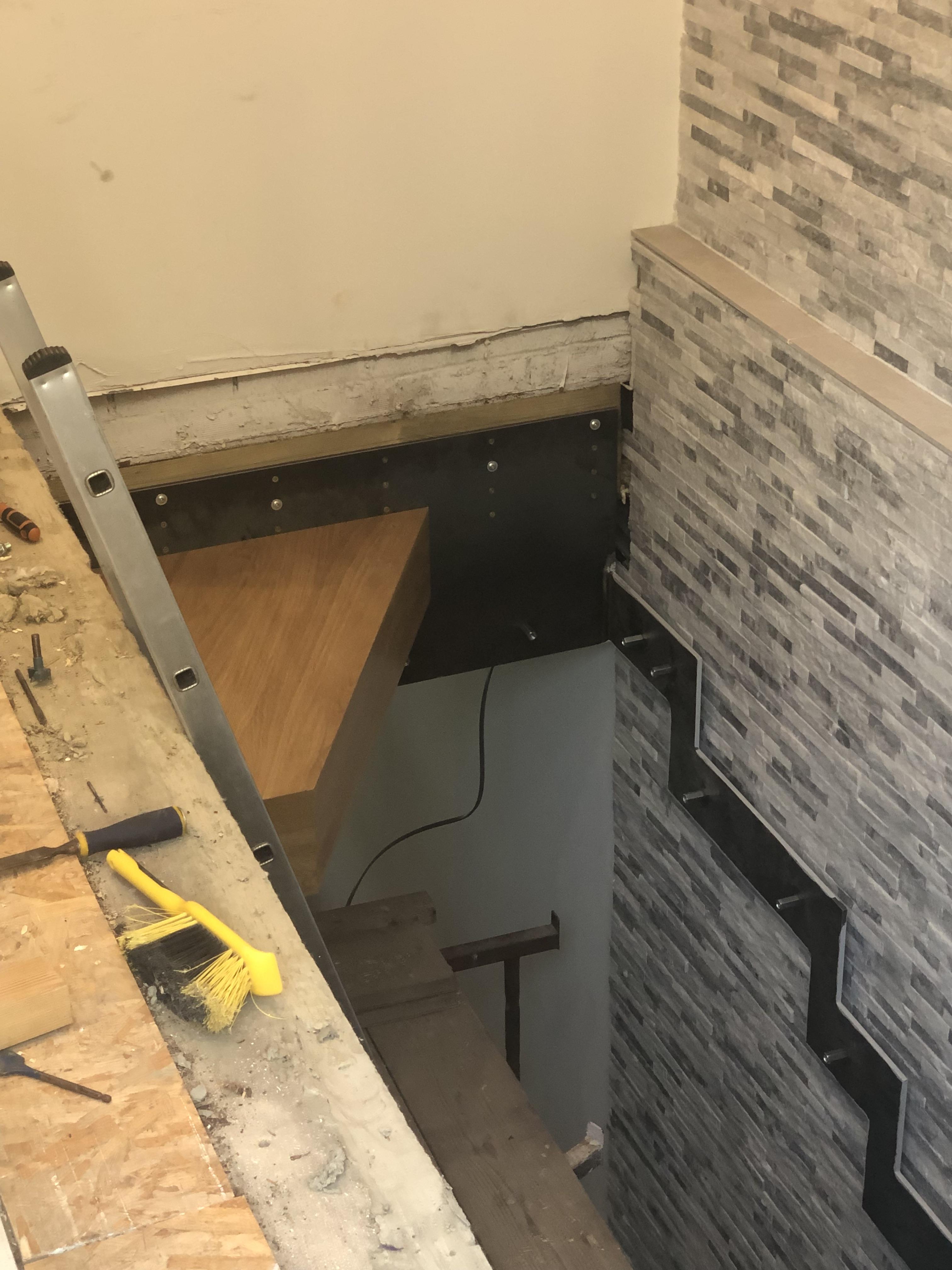

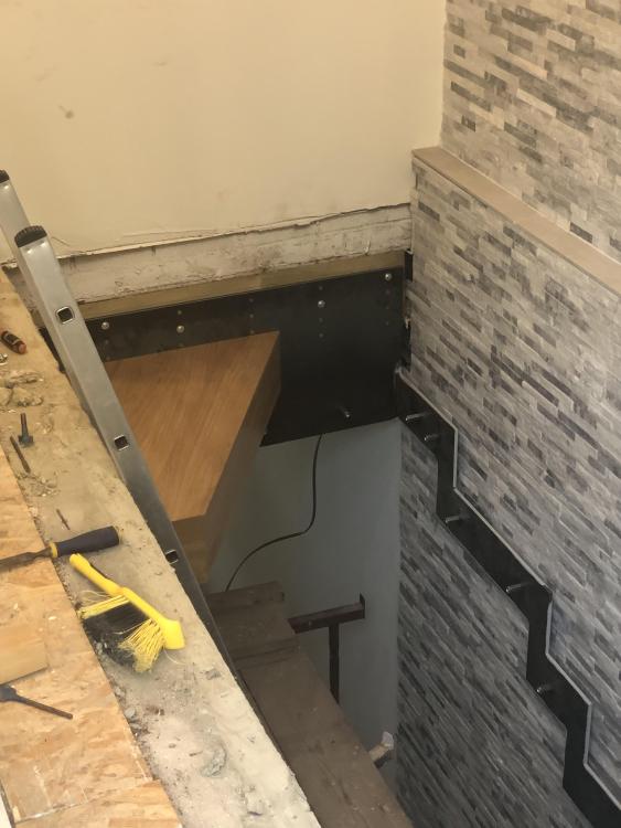

Pocster Posted September 8, 2023 Author Share Posted September 8, 2023 Forgot ! I had a photo of the steel before the tread went in 1 Link to comment Share on other sites More sharing options...
