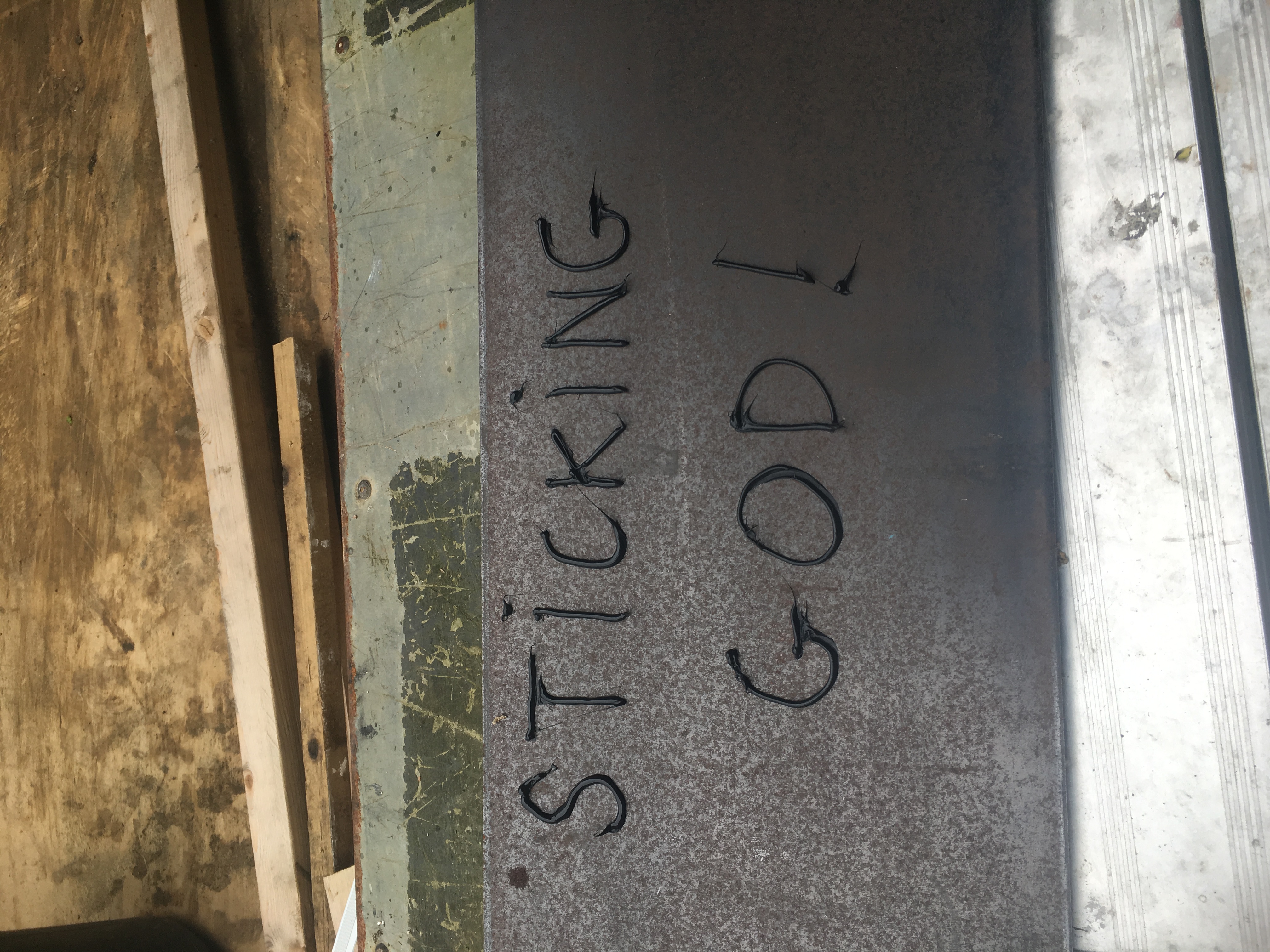

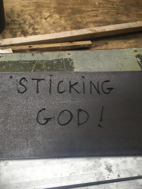

ToughButterCup Posted August 30, 2017 Author Share Posted August 30, 2017 7 hours ago, Nickfromwales said: Agreed. Only a welding God could weld a foot to a boot. ? ? Blistering up nicely now. Never mind. @Russell griffiths will get his comeuppance; revenge best served cold eh? Link to comment Share on other sites More sharing options...

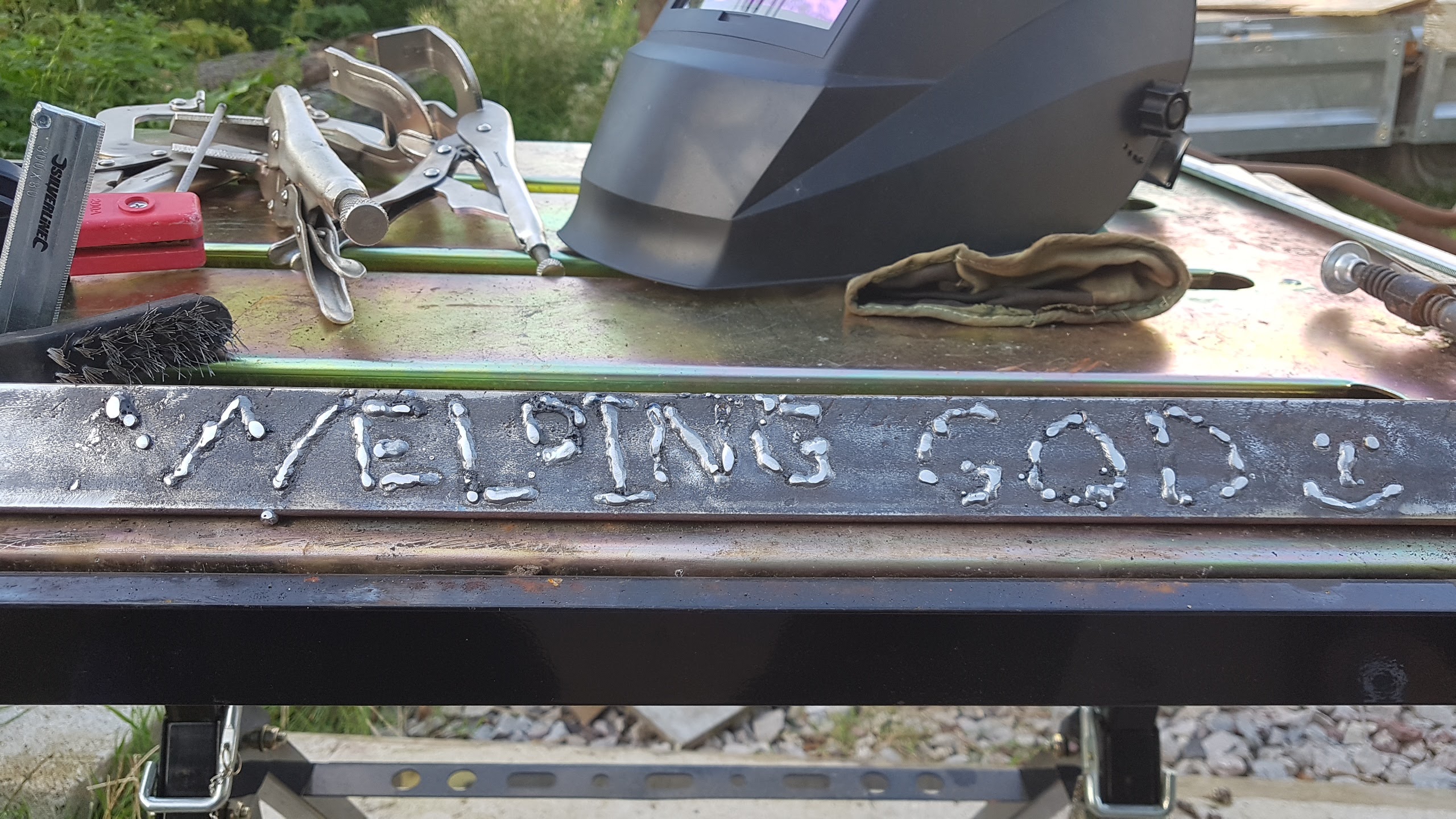

ToughButterCup Posted August 30, 2017 Author Share Posted August 30, 2017 18 hours ago, Russell griffiths said: being a welding god you should be able to knock something up in a jiffy. Harumph..... If proof were needed here it is @Russell griffiths I am indeed a welding God after all! So there. Let that be a lesson to ya! (We all gotta start somewhere) 4 Link to comment Share on other sites More sharing options...
Russell griffiths Posted August 30, 2017 Share Posted August 30, 2017 Good on ya mate, smashing job?You can have a diploma ?? Link to comment Share on other sites More sharing options...
Russell griffiths Posted August 30, 2017 Share Posted August 30, 2017 I hope your going to put it up in your workshop. 1 Link to comment Share on other sites More sharing options...
ToughButterCup Posted August 30, 2017 Author Share Posted August 30, 2017 I'd be ashamed if I put that up. I'll post it to you though as an official BH trophy IF you can show me (on BH) that you can weld any better. Stick welder, any old bit of angle iron.... Weld the words Welding God, you may within the rules use any stick welding kit, any welding rod any angle iron grind off any black bits Prize? Recognition of The Honour and the Glory of welding something well. And @PeterW will buy you a pie. 1 Link to comment Share on other sites More sharing options...
Declan52 Posted August 30, 2017 Share Posted August 30, 2017 13 minutes ago, recoveringacademic said: Harumph..... If proof were needed here it is @Russell griffiths I am indeed a welding God after all! So there. Let that be a lesson to ya! (We all gotta start somewhere) Is that in Braille!! 1 Link to comment Share on other sites More sharing options...

ToughButterCup Posted August 30, 2017 Author Share Posted August 30, 2017 OK, ok, ok, I'm the first official braille welder.... Who can say that they are an official braille welder eh? You? Nahhhh, See. 1 Link to comment Share on other sites More sharing options...
Russell griffiths Posted August 30, 2017 Share Posted August 30, 2017 I would cut a patch larger than affected areas, clean area and prime stick patch on with stickaflex or ct1 smear around edges and smooth off with a paintbrush dipped in appropriate thinner, prime and paint over the whole patch. Go to pub with money saved from all those bent twisted welding rods. Ca Ching. if you remember my original answer to your dilemma regarding the container roof you will recall I recommended STICKING a patch on. So if you had followed this advice you would now be a. 2 Link to comment Share on other sites More sharing options...

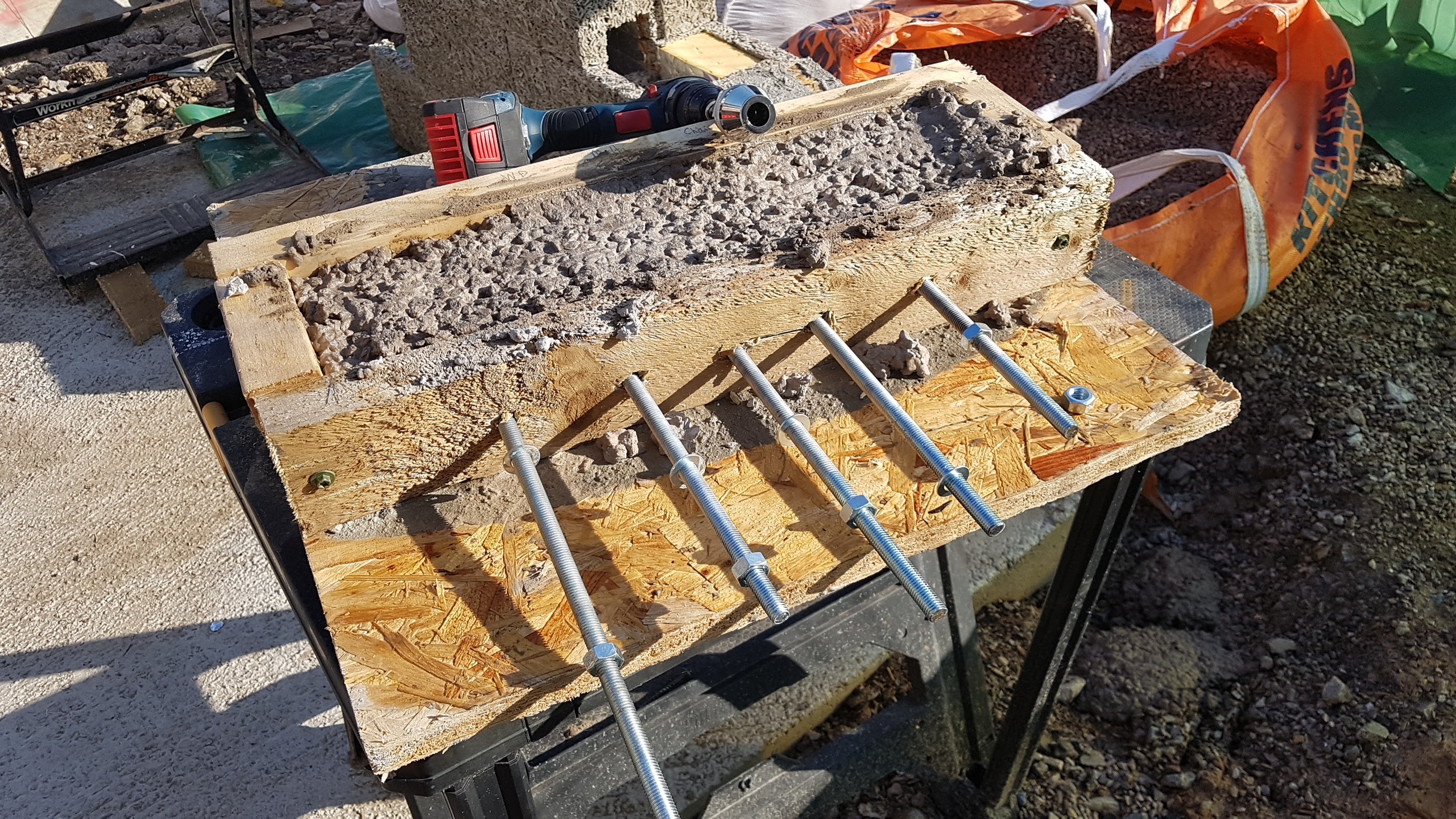

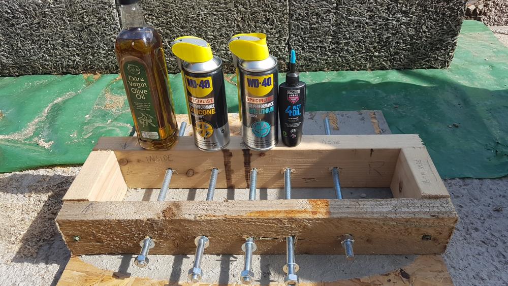

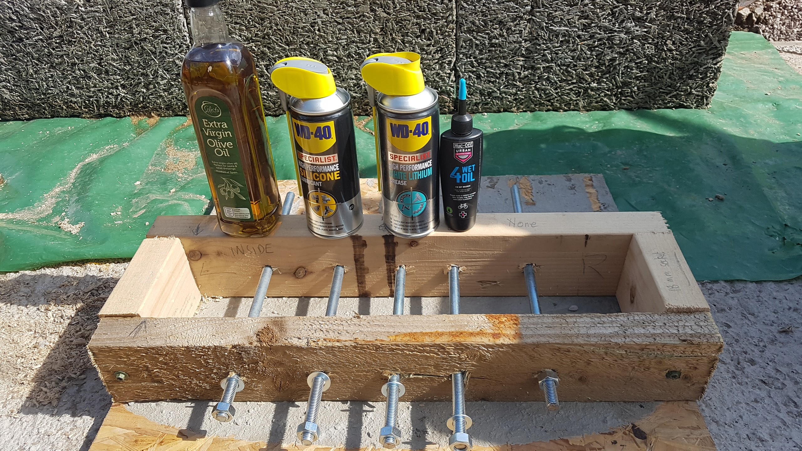

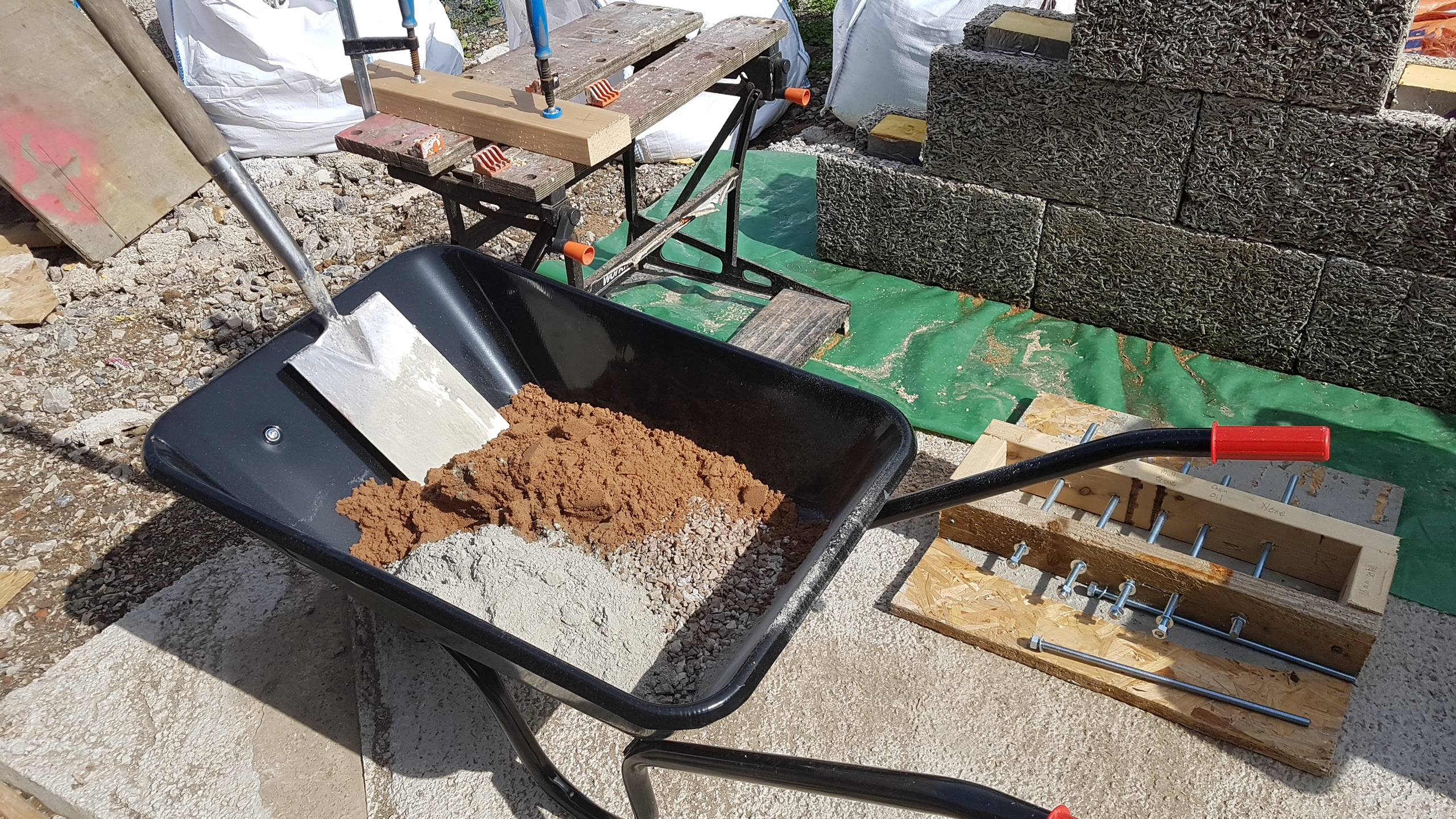

ToughButterCup Posted September 2, 2017 Author Share Posted September 2, 2017 Here's the experiment; the aim is to reduce the risk of the threaded bar being stuck in the concrete - and thus eliminate the cold bridges that would have been formed by the bar being stuck. This is how I set the experiment up As simple box with a few threaded bars, each exposed to the same size gap as the one in the Durisol blocks Each bar except one was coated with a 'release agent' illustrated; except one (as a control) I used a standard 1:3:3 concrete mix and after mixing appropriately, filled the box After 4 hours (when back from the pub) it was easy with @JSHarris set up (see earlier post) to withdraw (unscrew) the bars: the one with no release agent was noticeably more 'sticky' And the same effect was obvious just now (0920 the following day) This isn't anything like a scientific test: more a 'quick and dirty indication' I'm encouraged that there is at least the likelihood of being able to withdraw the bars, and so to eliminate the cold bridges. The job now is to get the release agent into the bars that have already been fitted. A job for tomorrow. Today's our wedding anniversary, so we're off to St Annes Kite Festival, and fish and chips on the sea front. I know how to treat a girl right! 2 Link to comment Share on other sites More sharing options...

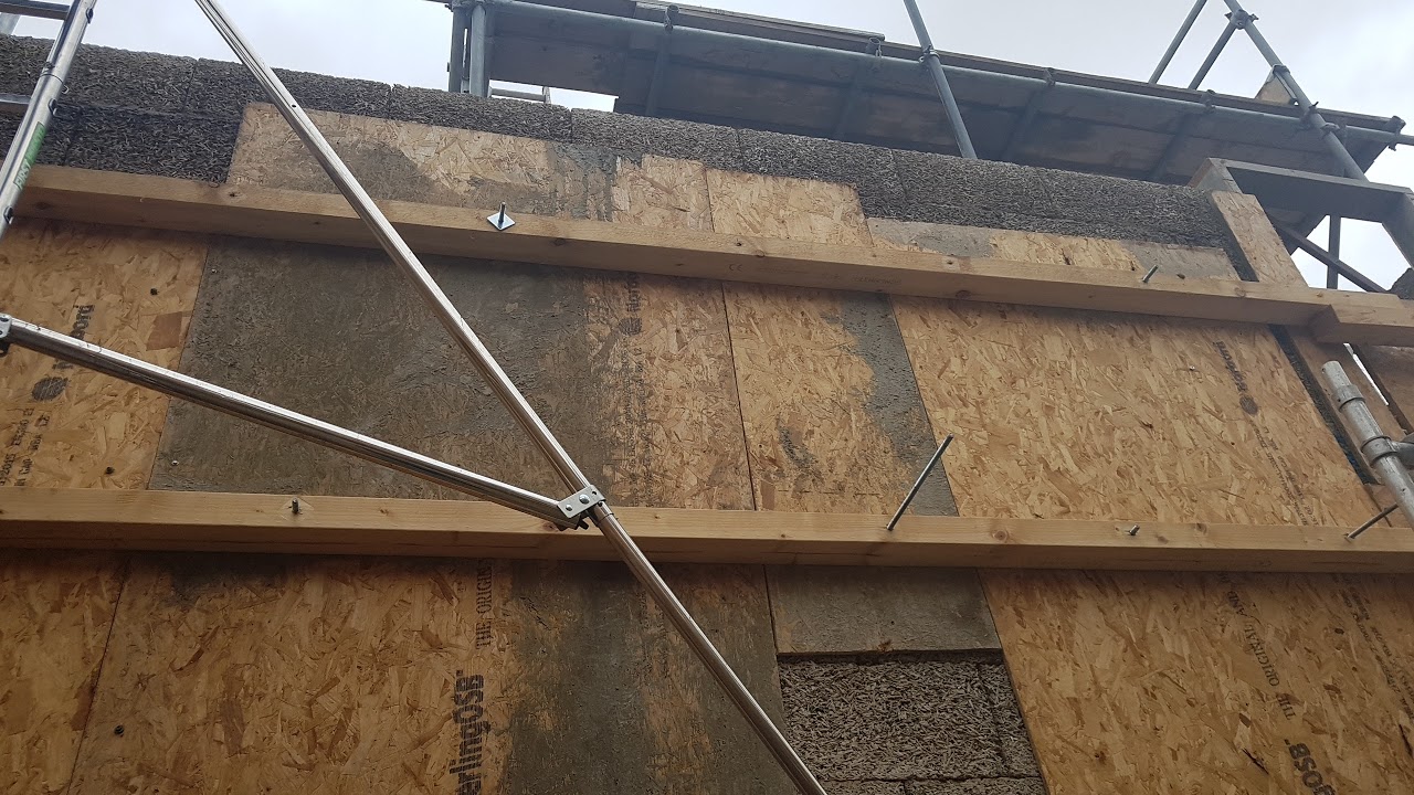

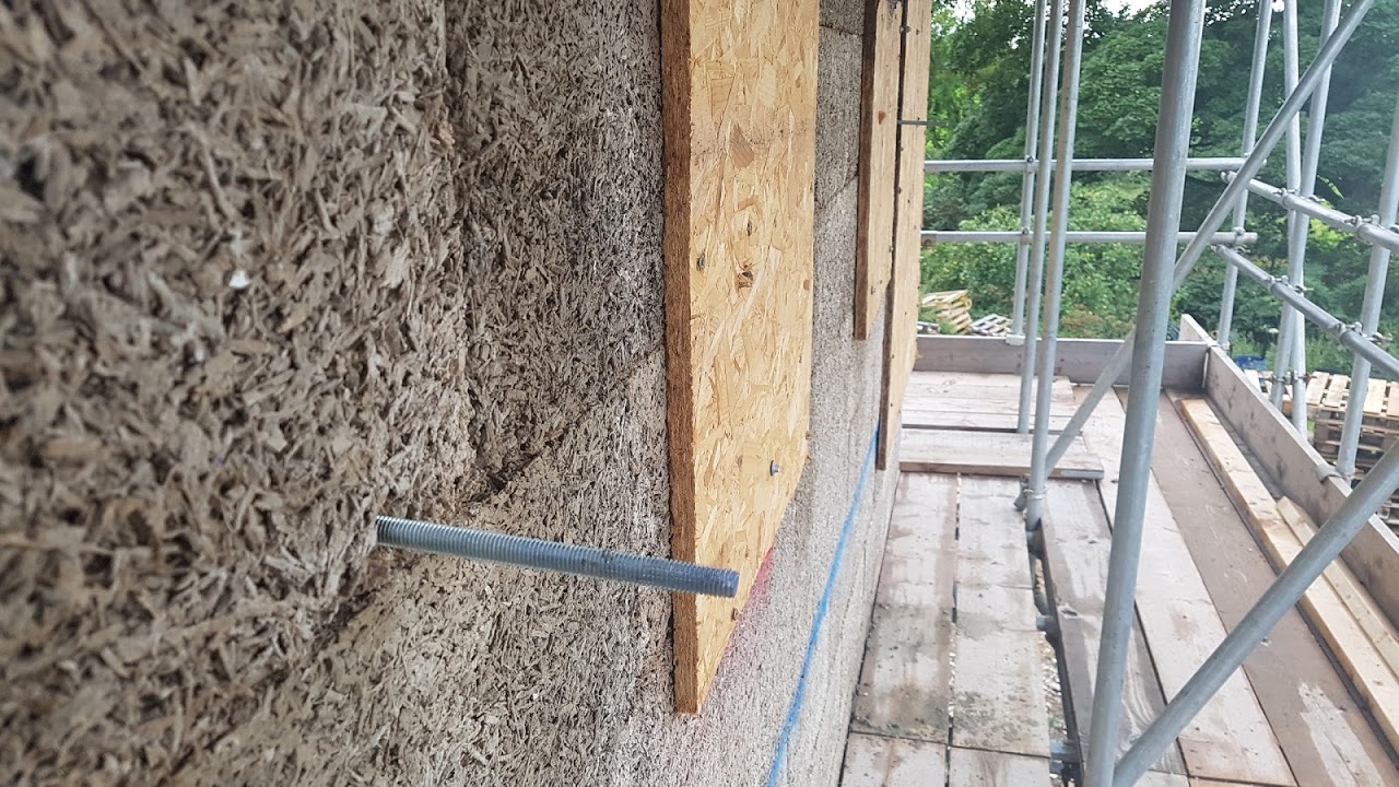

ToughButterCup Posted September 6, 2017 Author Share Posted September 6, 2017 Well.............. Mostly it went well. Mostly. A combination of swearing, sneezing (ManFlu: I'm in bed today, but not yesterday) and heroism got over a hundred of the bloody things out successfully (130 bars in all) But; well have a look: On the North face of the house I managed to partially extract these So annoying when the impact driver and stud puller are working their nuts off extracting the rod slowly, and then for an indecipherable reason the extraction process runs out of steam. I tried at least two methods of extraction on the dozen or so recalcitrant bars from both inside and outside: have a look This photo is from the inside, (the previous from outside). Since the end in mind is to prevent cold bridges, if (as immediately above) I have withdrawn a good 400 mm or more of bar, then all that needs to happen is for it to be cut and sealed with insulation foam from the outside. Its the pesky bars which have sulked in their sockets that concern me. I recon that the falling wet concrete during the filling process bent the bar, and so the impact driver hasn't been able to turn it at all. And by now the concrete has a vice-like grip on it. Strategies in no particular order For those that have partially extracted 'out' of the building: drill a hole in the corner of a hefty bit of angle iron, bolt it onto the bar, get the digger bucket up to that level, connect up with a shackle and strop ; yank (Dangerous?) For those that have partially extracted 'in' to the building: leave them in, chop them off at the inside wall, fill with low expansion foam from outside, and forget them For those sods which just sat there leering at me, drill in from both sides (200mm) and seal them into their tomb. Bastards. Grind two flats on each bar. Use a spanner to unwind (or wind - whichever works) by hand the bar in (or out) Time consuming. What do you all think? Ian (It's OK, I don't need any sympathy about Manflu. What a bloody time to get it) Link to comment Share on other sites More sharing options...
A_L Posted September 6, 2017 Share Posted September 6, 2017 17 minutes ago, recoveringacademic said: Grind two flats on each bar. Use a spanner to unwind (or wind - whichever works) by hand the bar in (or out) Time consuming. - or add a nut, weld, use spanner etc...? Link to comment Share on other sites More sharing options...
Onoff Posted September 6, 2017 Share Posted September 6, 2017 TRY.....add two nuts to the end of the stud and lock them together with spanners. Crank out with a bfo adjustable for leverage. Or a suitable socket on these and try whizzing out with the drill: https://www.toolstation.com/shop/p31432?table=no Link to comment Share on other sites More sharing options...
Construction Channel Posted September 6, 2017 Share Posted September 6, 2017 Don't use the digger. Too much potential for a huge disaster IMO. I assume you tried drifting them out? What about a big assed washer. Then just keep tightening a bolt up against it. "Should" pull the bar through if you can get enough torque on it. How big is your biggest hammer? Link to comment Share on other sites More sharing options...
Jeremy Harris Posted September 6, 2017 Share Posted September 6, 2017 I'm with couple of nuts on the end and a quick blob of weld on the end of the stud. You can then get a decent spanner on them too try and screw them out. 1 Link to comment Share on other sites More sharing options...
ToughButterCup Posted September 6, 2017 Author Share Posted September 6, 2017 2 hours ago, Construction Channel said: Don't use the digger. Too much potential for a huge disaster IMO. [...] Debbie likes you. Link to comment Share on other sites More sharing options...
ToughButterCup Posted September 6, 2017 Author Share Posted September 6, 2017 1 hour ago, JSHarris said: I'm with couple of nuts on the end and a quick blob of weld on the end of the stud. You can then get a decent spanner on them too try and screw them out. Hmmm, well since your answer to the previous question was (118/130)% correct, and I'm a 'blob-of-weld-on-the-end-of-a-stud-competent-welder', looks like I'm going with this one. 2 hours ago, Onoff said: [...] Or a suitable socket on these and try whizzing out with the drill: [...] I've tried that, I really have. I recon the core issue is that they were bent during the process of filling the ICF with concrete. And so even under ideal conditions (well lubricated and free of the concrete grip) would have been almost impossible to withdraw any type of drill, impact or otherwise. I don't hold out much hope: I'm as weak as a drink of water at the moment (did I mention ManFlu?), so by the time I get to it, tomorrow - all will be in the vice-like grip of the concrete. Can't take a joke? Shouldn't have started. BTW did I mention I have ManFlu? Link to comment Share on other sites More sharing options...
Onoff Posted September 6, 2017 Share Posted September 6, 2017 For what it's worth I don't reckon there's a cats chance in hell of wet concrete bending those to the extent you cant get them out. I'd have wrapped them in DPM AS WELL AS "greasing" them. You'd have just been pulling through a well lubed tube and not had the threads to catch on anything. Can you, in some cases draw them out so far as to get say an M10 stud in from the other side to use to drift the M12 out and not get stuck itself? Link to comment Share on other sites More sharing options...
