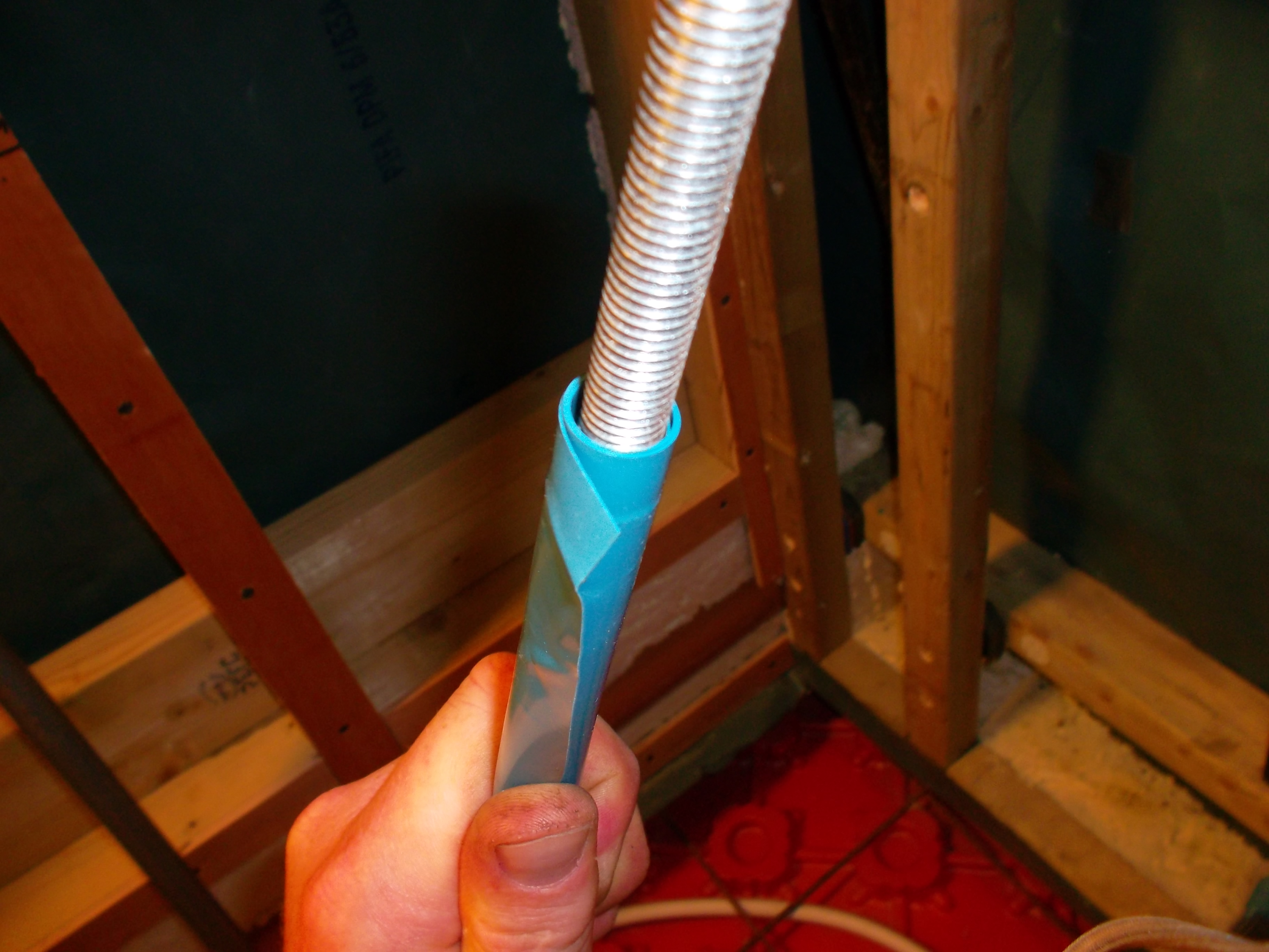

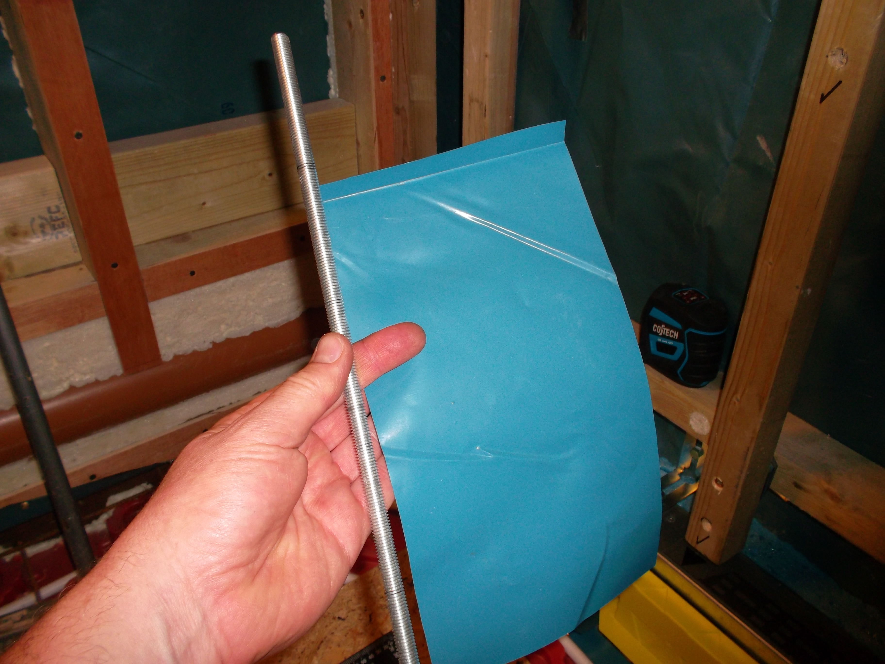

Onoff Posted August 29, 2017 Posted August 29, 2017 14 OD / 12 ID, so a 1mm wall thickness...in plastic? Need to be strong to be of any practical use other than a drinking straw for an off the shelf product. There's always carbon fibre, HOW MUCH??? http://www.easycomposites.co.uk/#!/cured-carbon-fibre-products/carbon-fibre-tube/woven-finish-carbon-fibre-tube/glossy-3k-woven-finish-14mm-12mm.html Heatshrink, nah, it'd bite into the thread. I wonder if you would be better with Denso tape? Reckon you might still be able pull the stud thru that once the concrete has gone off as it's squishy. Messy stuff btw, you need your wits about you to handle it. So...Onoff to the rescue... A wrap of h.duty DPM, cheap too:
Jeremy Harris Posted August 29, 2017 Posted August 29, 2017 (edited) I still reckon it's a lot easier to just grease the studding and unscrew it afterwards. I've done this when fitting cast-in anchor bosses, with threaded inserts. I just greased up the threaded studding, screwed it into the cast-in anchor plate welded on nuts, poured the concrete, then unscrewed the studding a few hours later. No problem at all, the most tedious part was unscrewing the studding, as even with a power drill it took a while to unscrew a foot or so of 12mm studding set down into a concrete anchor block. Edited August 29, 2017 by JSHarris
