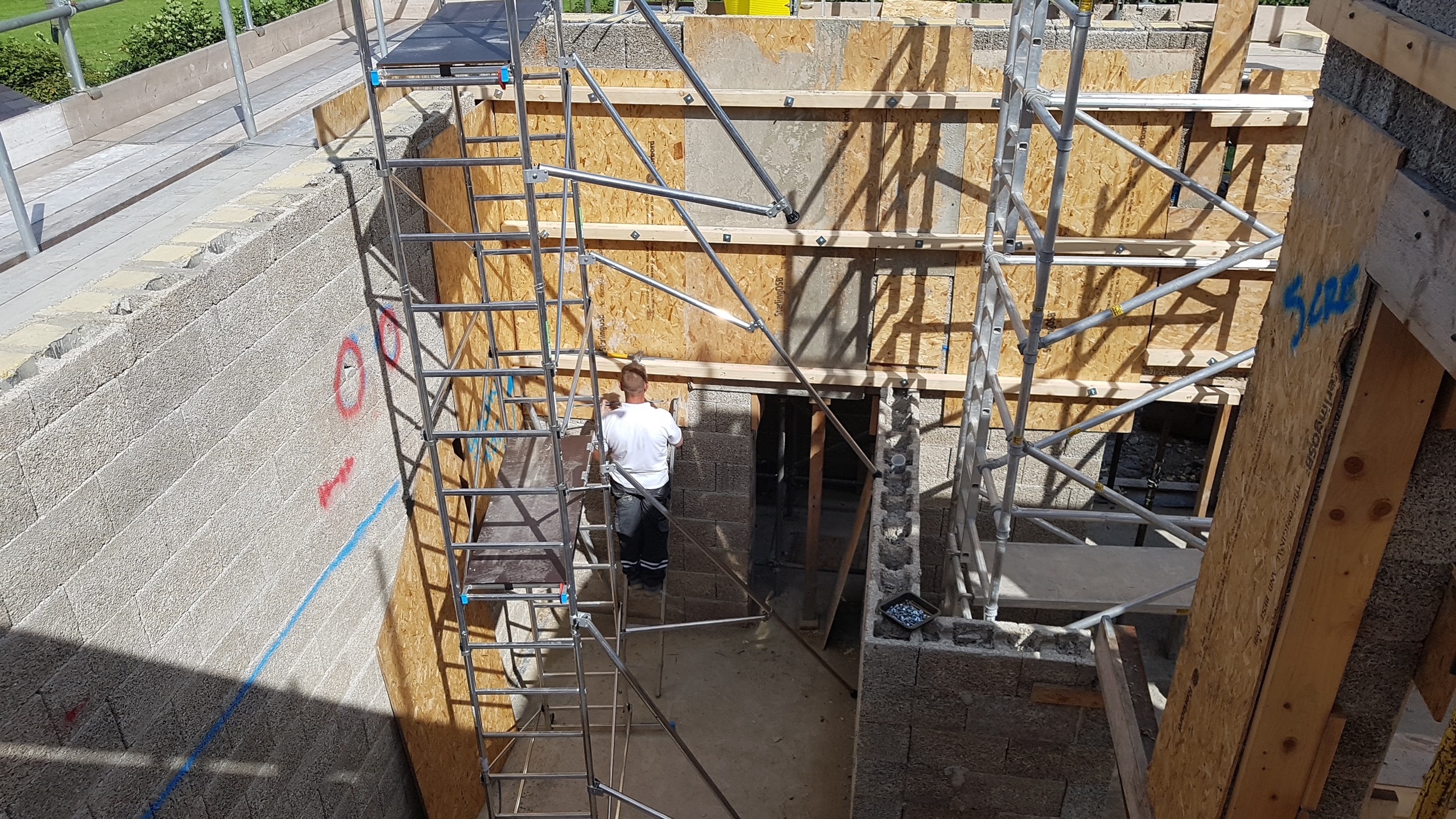

ToughButterCup Posted August 29, 2017 Posted August 29, 2017 Meanwhile, back at the ranch, we decided not to trust even one block laid by the original builders. And that means treating the Durisol like, well, the wall at Blackpool sea front. I know, it's tantamount to an admission of defeat. But do we want a wall we can trust or not? Short of scanning each block for integrity (well nigh impossible) there's nowt else we can do. Have a look at those lovely lengths of threaded bar fastening the OSB to a similar support structure the other side of the wall. My God I can cut and trim threaded bar to size at speed now. And in doing so have presented myself with 60 cold bridges. Poo. Here are two ideas that we have come up with to fettle the issue. A few hours after the pour, undo the nut on the outside (insulation side of the ICF) and tap the threaded bar back in (say) 60 mm, and fill with foam. Allow the concrete to cure. Remove the sheeting, and drill back the bar from the inside this time. Fill with foam. Leave it. Allow to cure. Drill out 120 (both sides of 60 bars) to a depth of 60 mm, fill with foam Has anyone got any bright ideas? Please? Hope so Ian
Jeremy Harris Posted August 29, 2017 Posted August 29, 2017 (edited) Grease the studding before fitting. Pour the concrete. Unscrew the studding from the concrete after it has partially (not fully) cured. Fill the holes with slow expansion foam. Make sure you remove the greased studding before the concrete has fully cured. Concrete shrinks in the final stage of the cure, and will grip tightly around anything inside it. This is why rebar ends up gripped very tightly inside cured concrete. However, at the "green" stage, where the concrete is solid, but still weak, it hasn't yet started to shrink, so won't have gripped the studding tightly. To get the studding out, either use a stud remover that tightens on the stud itself as you unscrew it, or just lock two nuts together and use the inner one to unscrew the studding. If it were me, then I would sacrifice the ends of the studs and use one of these to unscrew them: http://www.halfords.com/workshop-tools/tools/hand-tools/laser-impact-stud-extractor-1-2-drive Don't get this one from Halfrauds though, there are much better made ones. This was just a quick image I grabbed from a search to show the tool I mean. Edited August 29, 2017 by JSHarris

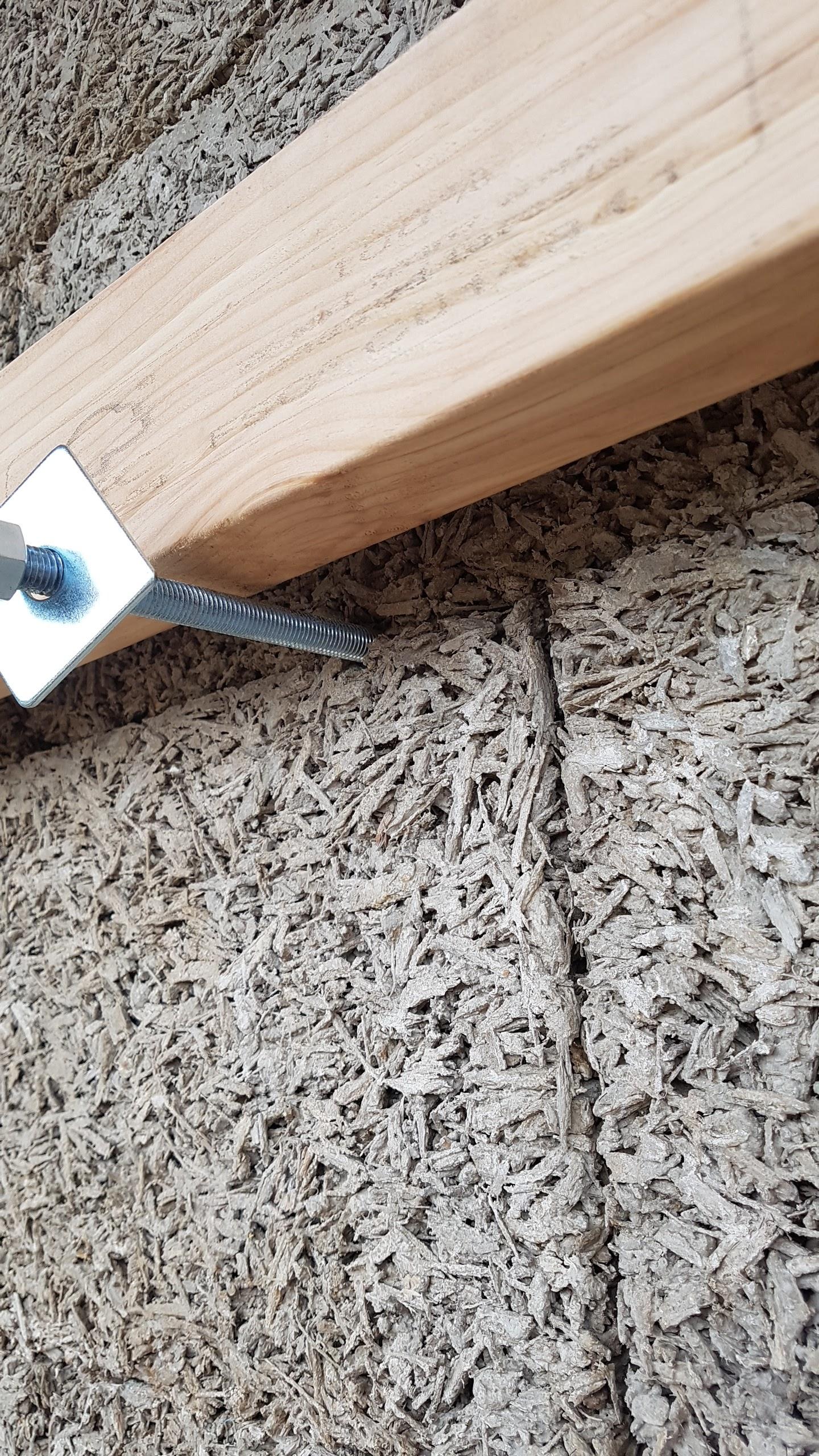

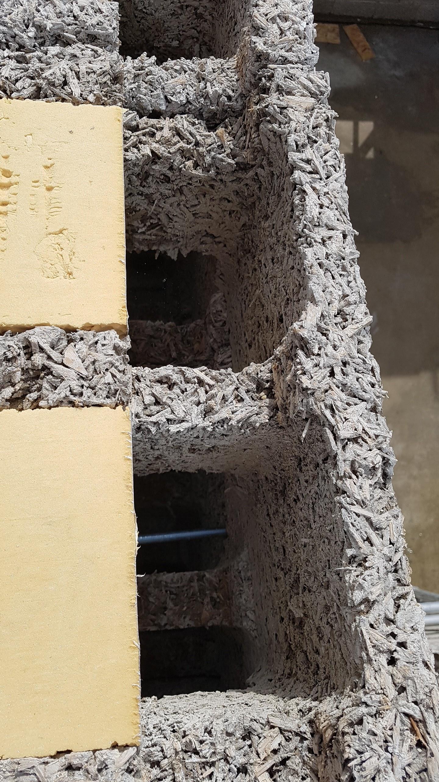

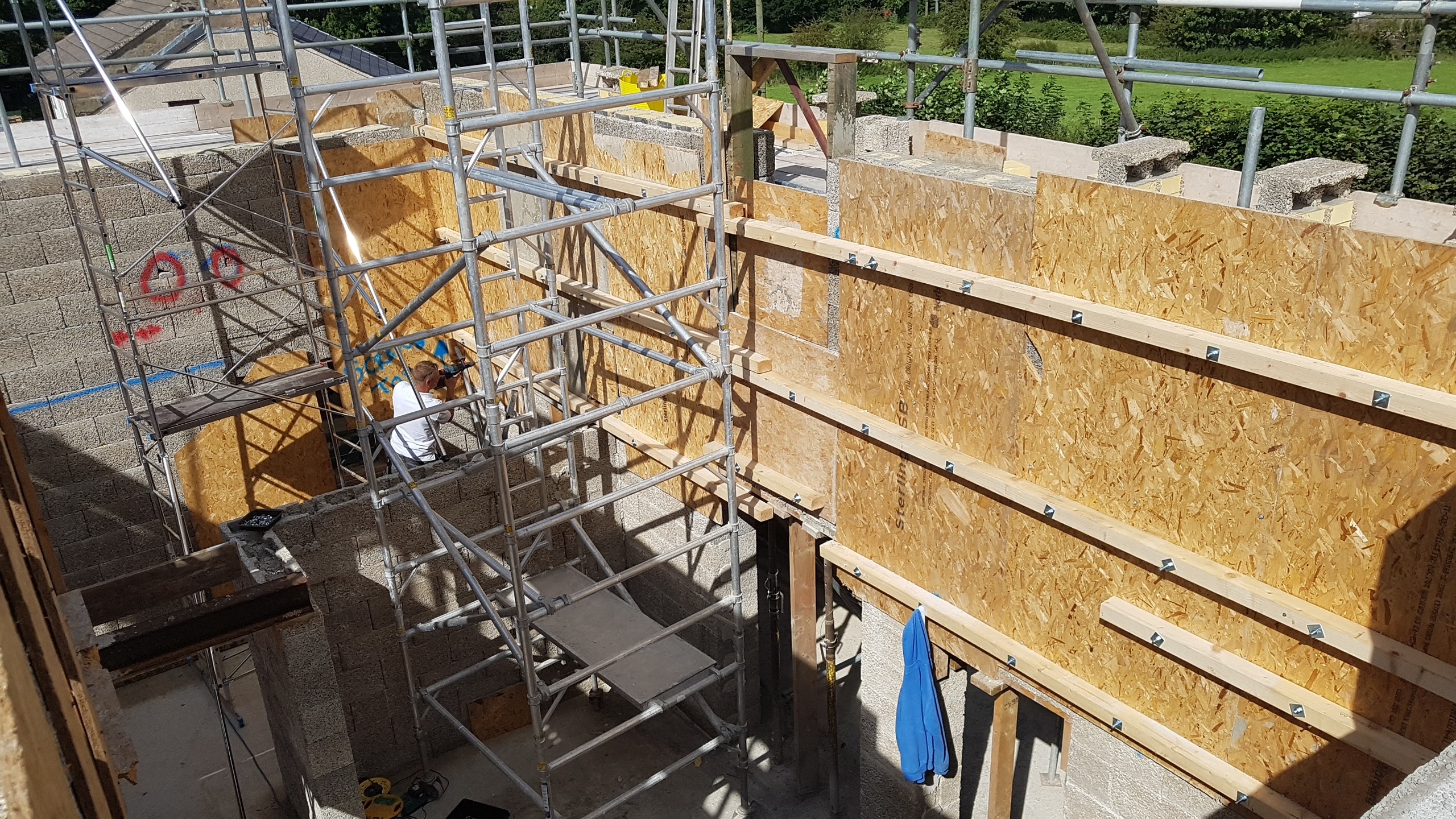

ToughButterCup Posted August 29, 2017 Author Posted August 29, 2017 As you can see from the following pics: There are three layers of reinforcement, each tied by threaded bar into a parallel set of timbers the other side of the wall The top layer is easy to see and so to get to thus; Then, some of the threaded bar in the middle layer is exposed because it hasn't been tightened up yet, so I stand a good chance of getting some silicone grease or vegetable oil or something like that to worm its way along the metal; ... a good squirt or two of whatever might well make its way along the bar... And the bottom row of fastening points are driven through concrete that has already set for a month (the layer on which Mark is working in the top photo..... and so should be easy to withdraw, and squirt foam through. Which leaves a fighting chance of being able to withdraw most of the bars. @JSHarris, How long can I leave the bars in before concrete grips too hard to withdraw the bar?
