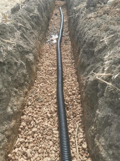

joe90 Posted January 24 Share Posted January 24 Well with my treatment plant I discharged to a ditch that was dry a couple of months a year and the pipe (10m) to the ditch was a “rumble drain” which is a partial drain, I.e. perforated pipe in a stone filled trench to the outlet in the ditch. Link to comment Share on other sites More sharing options...
