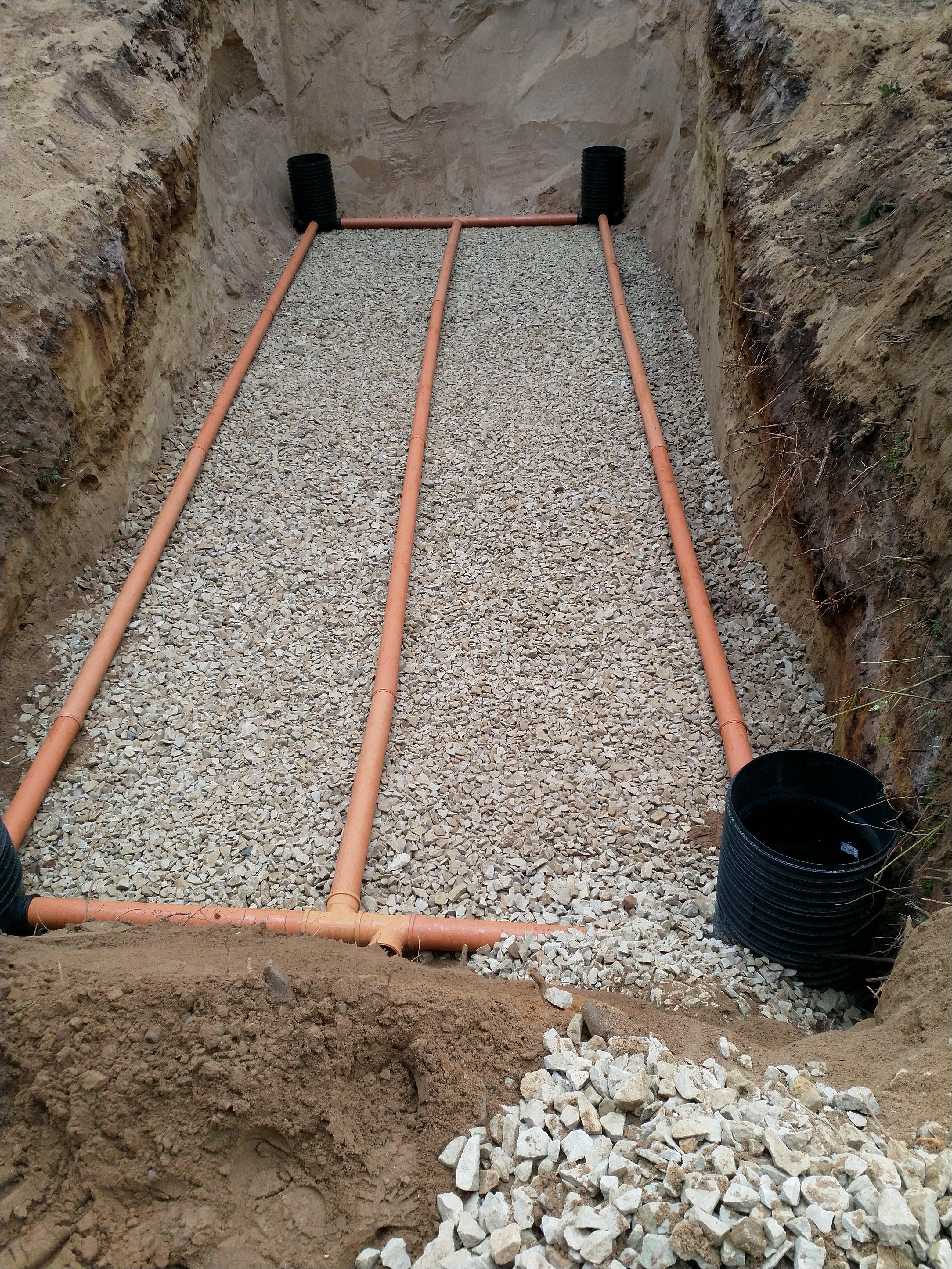

We had a similar issue although on a much smaller scale. That said we had to dig a trench through the farmers neighbouring field. [We too bought the land from him so we waited until he had harvested his crops before doing so. He was happy with this arrangement] - We dug a trench probably 100 m out into his field and joined the perforated pipework, which we laid onto an existing land drain, which was buried in the field. By doing so the discharge was then carried on to the water course some 150m away.
Could this work for you @Dunc ?
Total cost of this was around £2.5k 4 years ago.
