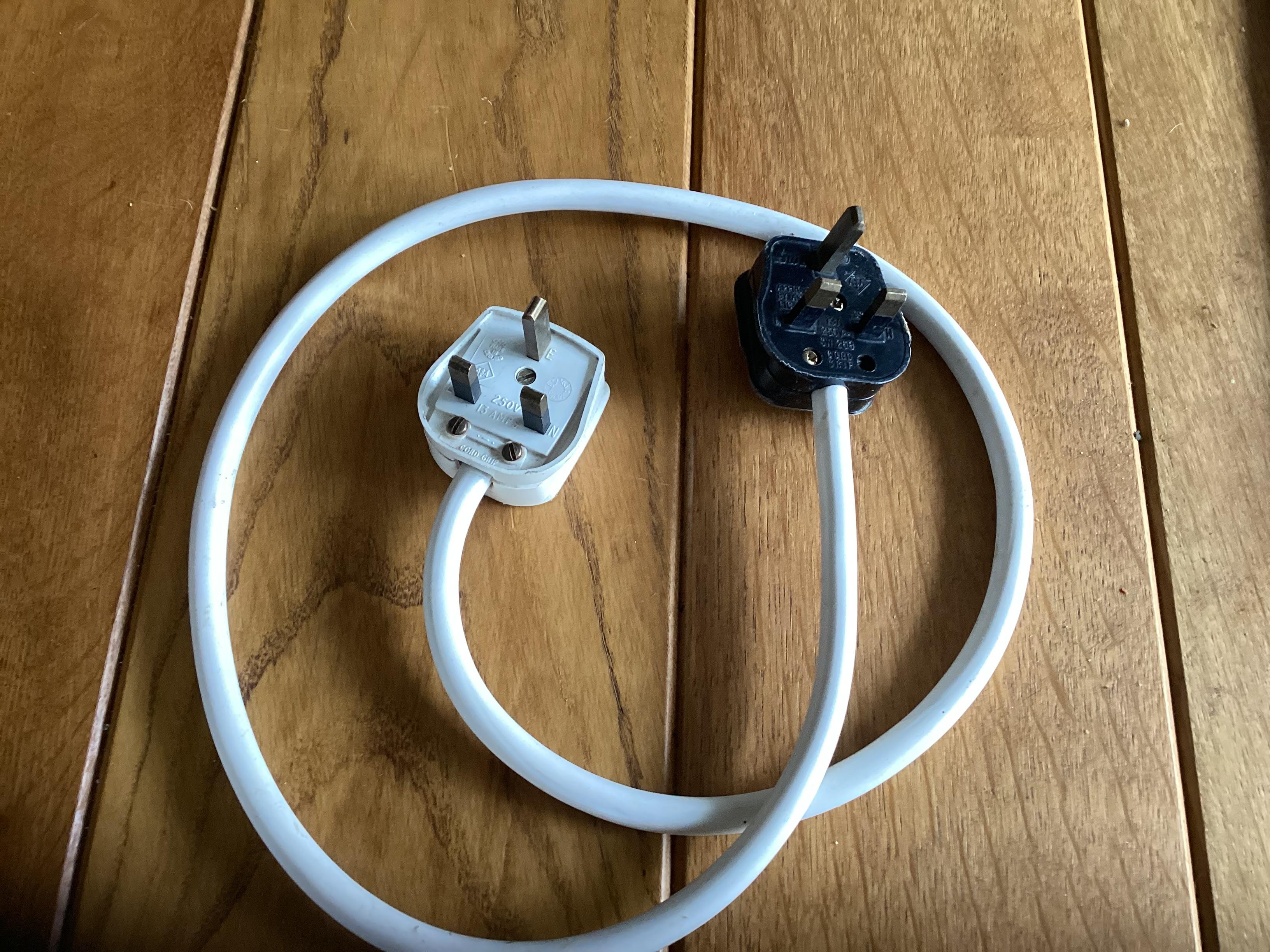

joe90 Posted August 8, 2023 Share Posted August 8, 2023 Just checking the electrics to my new workshop and I came across this in an outhouse, wiring to the workshop STARTS in a socket, then it’s fed from an existing socket in the outhouse and connected by this…… beggars belief. Trust me I am all for DIY as long as you have some basic knowledge at least. No wonder there are regs. It stops people being killed. 1 1 1 Link to comment Share on other sites More sharing options...
Mattg4321 Posted August 8, 2023 Share Posted August 8, 2023 Come across a few of these over the years. Commonly known in the trade as a widow maker. Link to comment Share on other sites More sharing options...

markc Posted August 8, 2023 Share Posted August 8, 2023 Also known as a generator power cut adapter 1 1 Link to comment Share on other sites More sharing options...
ProDave Posted August 8, 2023 Share Posted August 8, 2023 At least my own one has a switched plug at one end. (cough) 1 1 Link to comment Share on other sites More sharing options...
TonyT Posted August 8, 2023 Share Posted August 8, 2023 Fool proof, 1 black plug, 1 white plug follow the SOP and away you go, it’s even got new fancy sleeved pins! I should rip out my changeover switch😁 1 Link to comment Share on other sites More sharing options...
joe90 Posted August 8, 2023 Author Share Posted August 8, 2023 Oh, just found the first socket is supplied by a 3 pin plug in the kitchen (13 amp fuse) and a fancy consumer unit in the workshop has a 63 amp incomer 🙄. I liked my new build, at least I knew it was all wired properly. Link to comment Share on other sites More sharing options...
Big Jimbo Posted August 8, 2023 Share Posted August 8, 2023 Several times i have found the "added extra socket" cut into an existing ring. One end into One ring, and the other into a different ring. Turn the fuse off. Still live. Link to comment Share on other sites More sharing options...

FuerteStu Posted September 5, 2023 Share Posted September 5, 2023 On 08/08/2023 at 16:59, joe90 said: Just checking the electrics to my new workshop and I came across this in an outhouse, wiring to the workshop STARTS in a socket, then it’s fed from an existing socket in the outhouse and connected by this…… beggars belief. Trust me I am all for DIY as long as you have some basic knowledge at least. No wonder there are regs. It stops people being killed. When viewing rental properties a few years back, we found a neighbour has plugged one of these from shed to shed at the bottle of the garden to pinch power. When I asked if there was a condition report done, the agent said "yes of course we've got the same guy checking all our properties".. "then I won't be renting any of your properties" I replied. 😂 1 Link to comment Share on other sites More sharing options...
