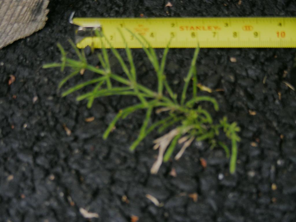

ProDave Posted August 6, 2023 Share Posted August 6, 2023 Tarmac laid about 2 years ago, about 80mm thick that was laid on about 300mm of MOT1 that had been down for many years right from the start of the build. Before laying the tarmac, the MOT1 was re levelled in places and wackered down and there were no weeds growing in the MOT1. Noticed yesterday, this has appeared in 3 separate clumps close to each other on part of the tarmac that does not get much traffic, under our touring caravan. It appears to be growing through the tarmac. I don't think a seed has just landed there and grown. There is nothing else, yet growing through the tarmac and I can't see this weed anywhere else locally. It is getting a daily dose of Glyphosate week killer until it shows some sign of dying. Any idea what it is? I don't think it is JKW but it must be something nearly as determined to grow through tarmac? Link to comment Share on other sites More sharing options...
Bonner Posted August 6, 2023 Share Posted August 6, 2023 Looks like Mares-tail, quite a bugger to get rid of if it is 1 Link to comment Share on other sites More sharing options...
Jilly Posted August 6, 2023 Share Posted August 6, 2023 I was going to say I think it’s horsetail too 1 Link to comment Share on other sites More sharing options...
ProDave Posted August 6, 2023 Author Share Posted August 6, 2023 So will just persistently spraying it with glyphosate kill it? I am bemused how it got there? Has it been dormant in the ground for years? Have it's roots travelled underground for some distance before it decided to pop up there? Link to comment Share on other sites More sharing options...
joe90 Posted August 6, 2023 Share Posted August 6, 2023 Yes I thought mares tail as well, roots go down meters apparently, I had it in a cottage in Shropshire, a right mare (🤣) to get rid of but spraying as you say repeatedly is you best bet I recon. 1 Link to comment Share on other sites More sharing options...
saveasteading Posted August 6, 2023 Share Posted August 6, 2023 22 minutes ago, ProDave said: will just persistently spraying it with glyphosate Yes but you don't get much coating so it will take years for it to kill the roots. You could try putting black polythene or plywood over it so shoots don't get light. And cut them back. I don't know what has to be done with cuttings: segregate in a black bag for an immediate solution. Link to comment Share on other sites More sharing options...
Temp Posted August 6, 2023 Share Posted August 6, 2023 (edited) Put some washing up liquid in the weedkiller. Helps get it past the waxy coating on mares-tail. You might also try walking on it to crack the stems. Let the weedkiller do its thing for a few days before cutting.. Edited August 6, 2023 by Temp 2 Link to comment Share on other sites More sharing options...
Sarah29 Posted August 6, 2023 Share Posted August 6, 2023 Yes nearly certain it's horsetail from that pic. And yes v difficult to get rid off using the usual methods. Best way and most permanent is usually to make the soil less hospitable to it (horsetail loves acidic soil).....so if you can access the soil layer (poss through the side water table), you can introduce lime to increase the pH and permanently get rid of the stuff. I've spent too much time talking about this annoying weed with farmers/ecologists. Glyphosate doesn't really do a great job of getting to the roots but it will certainly weaken it if you pull surface weeds and glypho the green shoots religiously. But would really think about tackling it more fundamentally if poss and adjust that pH in the soil...as Joe says the roots go down the metres. Sarah 1 Link to comment Share on other sites More sharing options...

ProDave Posted August 6, 2023 Author Share Posted August 6, 2023 1 hour ago, Sarah29 said: Yes nearly certain it's horsetail from that pic. And yes v difficult to get rid off using the usual methods. Best way and most permanent is usually to make the soil less hospitable to it (horsetail loves acidic soil).....so if you can access the soil layer (poss through the side water table), you can introduce lime to increase the pH and permanently get rid of the stuff. I've spent too much time talking about this annoying weed with farmers/ecologists. Glyphosate doesn't really do a great job of getting to the roots but it will certainly weaken it if you pull surface weeds and glypho the green shoots religiously. But would really think about tackling it more fundamentally if poss and adjust that pH in the soil...as Joe says the roots go down the metres. Sarah Just how do you expect me to do anything to the "soil" when the only place this weed is present (so far) is coming up through my drive. The soil is nearly 400mm down, and no I am not digging up the drive. This is the baffling thing to me, why is the only place it has appeared through my drive? If the roots had come from next door, where I can't see it, why did they travel so far before coming to the surface? It is just baffling to me. Link to comment Share on other sites More sharing options...

Sarah29 Posted August 6, 2023 Share Posted August 6, 2023 @vfrdave any of the agricultural limes will slowly adjust the soil pH level over time. Use a finer grain for quick release etc. or larger grain for gradual release. Also depends on your soil permeability too etc. Can also pick up one of those simple soil ph meters which will give you a good steer if you're going in the right direction. @ProDave ha no i'm not suggesting a dig up! Liming is a slow/gradual/permanent fix to the issue so you could possibly introduce coarse grain lime along an adjacent flower bed perhaps that naturally drains through the soil under the tarmac....just a thought. Link to comment Share on other sites More sharing options...

SteamyTea Posted August 7, 2023 Share Posted August 7, 2023 14 hours ago, saveasteading said: Yes but you don't get much coating so it will take years for it to kill the roots I thought glyphosate worked by being transported from the foliage to the root. Low concentrations of it work well with Japanese knotweed. Link to comment Share on other sites More sharing options...
saveasteading Posted August 7, 2023 Share Posted August 7, 2023 1 hour ago, SteamyTea said: transported from the foliage to the root. Yes. But knotweed has e flat leaves that hold a lot of spray. Horsetail has these little needle things. Both take many treatments which can be for years. Link to comment Share on other sites More sharing options...

saveasteading Posted August 7, 2023 Share Posted August 7, 2023 I'd have to check but I think it's like fir knotweed...the official way to get rid of it is digging it up. Then you bury it deep. I'm pretty sure there will be a government guidance document. On tarmac. Spray and cover and cut. Repeat. Disposing of the weeded bits? I looked up the RHS guidance so you don't have to. Drown them in a bucket, then use the water as fertiliser. Link to comment Share on other sites More sharing options...

PeterW Posted August 7, 2023 Share Posted August 7, 2023 Burn it off and continue to do so - won’t damage the tarmac but stop it before it can grow back and also occasionally flood the area with a weak glyphosate solution but bear in mind that it is neutralised in the soil in 48 hours Link to comment Share on other sites More sharing options...
ProDave Posted August 7, 2023 Author Share Posted August 7, 2023 I will stick to glyphosate daily for a while and see what happens. 2 new shoots popped through overnight. I always believed when spraying with glyphosate you do not cut the weed, you just leave it. Cutting or burning might kill what you see but won't kill the roots will it? The glyphosate I have is concentrated, Gallup XL. Is there any merit in making up a stronger solution for this job? Link to comment Share on other sites More sharing options...
Barryscotland Posted August 7, 2023 Share Posted August 7, 2023 5 minutes ago, ProDave said: I always believed when spraying with glyphosate you do not cut the weed, you just leave it. Mares tail it helps if you bruise plant before spraying. I normally stamp through it before spraying, then leave it to die off which is normally a few weeks after its rained. 2 Link to comment Share on other sites More sharing options...
saveasteading Posted August 7, 2023 Share Posted August 7, 2023 32 minutes ago, ProDave said: there any merit in making up a stronger solution for this job? My understanding is "no". It is absorbed into the system , and too much might make a chemical layer and prevent the leaf doing its photosythesis. As to trimming any shoots. It is better to trim off any new shoots than do nothing, or leave it a few days, because they will immediately start to build up the roots. Likewise, in wet weather, spraying is no use, so trim. If the killer chemical is ok to leave in solution then a small sprayer could be kept handy. Link to comment Share on other sites More sharing options...
The Reverend Posted October 30, 2023 Share Posted October 30, 2023 Some very good suggestions on here and some no so good. It is Marestail / Horsetail and you do need to keep on top of it. Like Ivy it's best sprayed young before the wax coating hardens, bruising the leaves (weed wiping) is the commercial way of treating it using Glyphosate 360 and an adjudicative like Validate. I have had good results with SBK brushwood killer and Validate but it is suggested to use Kplus(https://www.progreen.co.uk/blog/how-to-get-rid-of-woody-weeds-with-sbk-brushwood-killer/) Burn the weeds and please don't put them in the compost or council green bins as this just spreads the problem. 1 Link to comment Share on other sites More sharing options...
