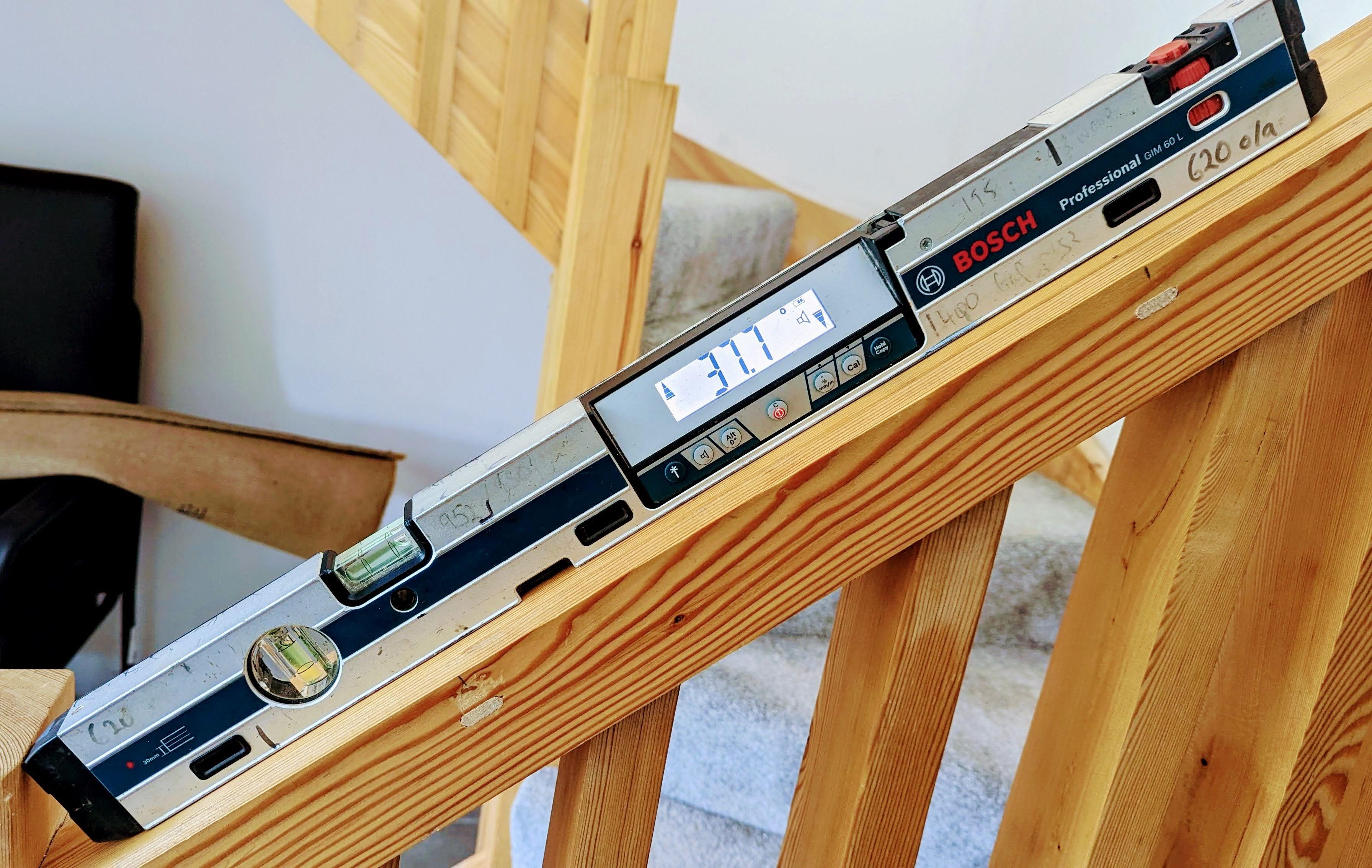

ToughButterCup Posted August 3, 2023 Posted August 3, 2023 (edited) 2 hours ago, markc said: .... The bubble size changes with temp, hence lines usually being too far apart in our climate Ah! Of course. 🤦♂️Thanks for the post . This is my go-to level because It has both a bubble and electronic feedback If set to electronic, you can hear when the item is level (the error can be given both in degrees or percentage) - you don't need to look at the level You can use the level upside down - the display automatically compensates The surface of the level allows you to write on it in pencil It has a built in laser (30mm above the base) (wish it had a laser both ends) It is magnetic It can be strapped to a straight edge - levelling a path today with a 3m straight edge ( 3 black slots for velcro straps provided) The level can be used as an inclinometer You can set the level to 'level' (or another value) when the level is placed on a slight incline (red turnbuckle on the RHS) You can 'hold' any value (hold button) allowing you to read the level when the viewport cannot be seen ( measure> hold > view) Yes, it's German, and you'd expect me to buy one. Haende hoch Fritz : I'm biased, I agree. I am sure that people like Zeiss, Leitz, or Hilti, or Dewalt do levels that are just as good. If someone drove a digger over mine, I'd have ordered another a few minutes after having stopped swearing. For a self builder, and for me, it's close to perfect 46 minutes ago, Conor said: I find an electronic level set on top of an aluminium straight edge works far better.... Exactly. Edited August 3, 2023 by ToughButterCup 3 1

Gone West Posted August 3, 2023 Posted August 3, 2023 5 hours ago, ToughButterCup said: This is my go-to level I've got a Bosch DNM120L bought 13 years ago and I also think it's good, especially as an inclinometer, not as posh as yours but didn't cost as much. Don't think they make that model any more. 1
