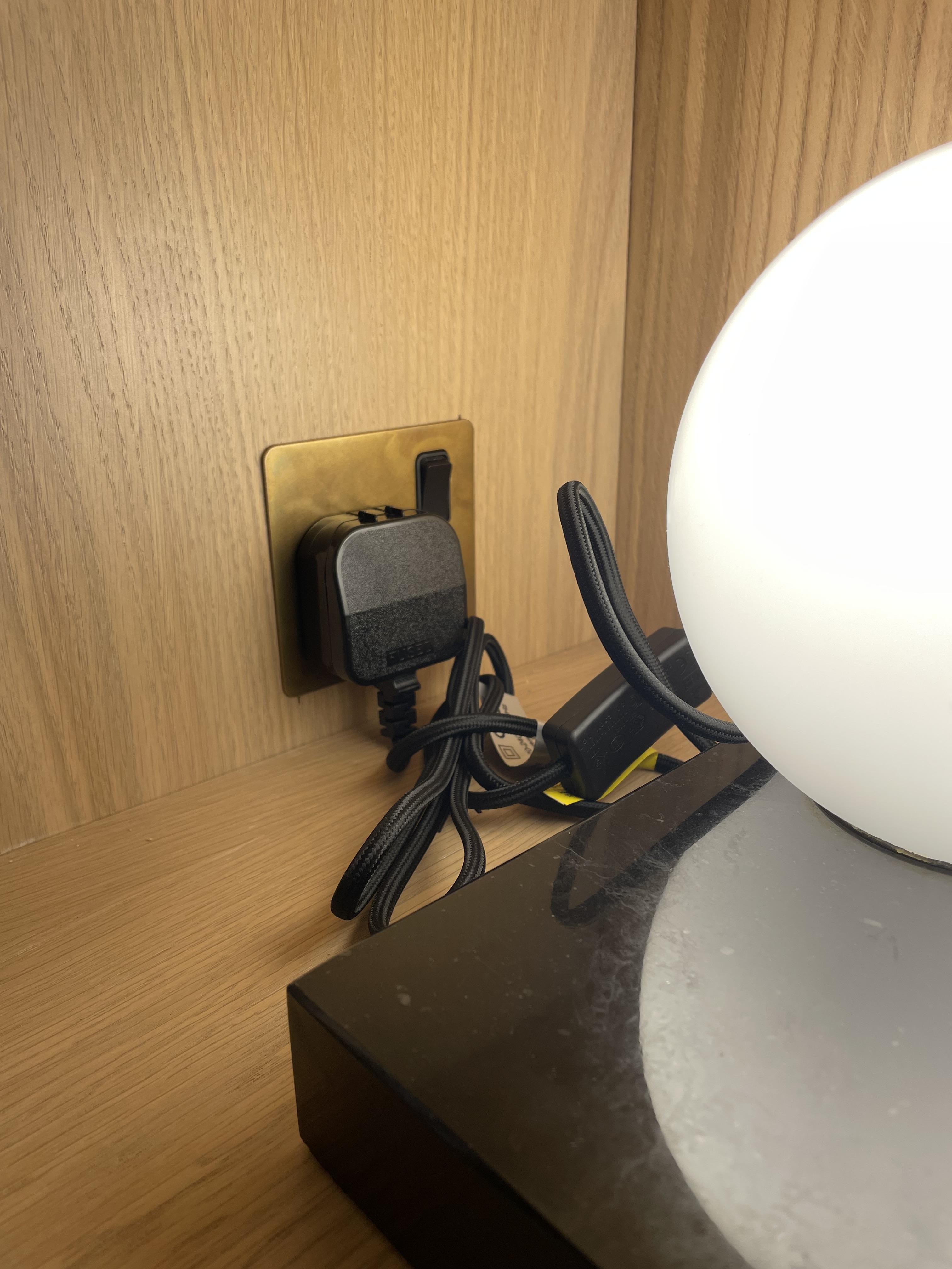

Adsibob Posted July 25, 2023 Share Posted July 25, 2023 (edited) We have some sockets built into a bookcase to plug some speakers and lamps into. The socket is probably 6mm too low for the plug to fit in comfortably, unless I switch this plug for one that doesn’t have such a large milder plastic mount on it. But it would also give the lamp a bit more visual “breathing space” if I got rid of the plug altogether. I found this online, but not sure how it would be wired up: https://www.corston.com/products/cord-outlet-antique-brass-1?variant=39293021323361&bcndyn=d2lkOjQ4OHxjaWQ6NTY5&gad_id=&utm_campaign=Google_Ads&gclid=Cj0KCQjw5f2lBhCkARIsAHeTvlgOLBlBfvfNNxDi8i6nC7GLxAvARlUbWx_6nTXjavYiyiLPYfy2b0saAsC6EALw_wcB Where would the fuse go? Alternatively, is there another type of socket that can connect directly to the cable, without having an actual plug? Edited July 25, 2023 by Adsibob Link to comment Share on other sites More sharing options...
dpmiller Posted July 25, 2023 Share Posted July 25, 2023 a fused spur outlet would be the job, if you can get one that matches Link to comment Share on other sites More sharing options...
Nickfromwales Posted July 25, 2023 Share Posted July 25, 2023 https://socketstore.co.uk/product/flat-aged-brass-switched-fused-spur-with-flex-outlet-black-switch-418048?srsltid=ASuE1wSQ2mkoyJwNvk4w4VS1bMA3ohRdpZlytGRJiqqkbH09csfgzqQixAI Link to comment Share on other sites More sharing options...

Adsibob Posted July 25, 2023 Author Share Posted July 25, 2023 31 minutes ago, Nickfromwales said: https://socketstore.co.uk/product/flat-aged-brass-switched-fused-spur-with-flex-outlet-black-switch-418048?srsltid=ASuE1wSQ2mkoyJwNvk4w4VS1bMA3ohRdpZlytGRJiqqkbH09csfgzqQixAI That’s a good find, but I know this finish and it won’t quite match. can i drill a hole in the brass plate of this: https://www.corston.com/products/13a-fcu-antique-brass-1?variant=39293020602465¤cy=GBP&bcndyn=d2lkOjQ4OHxjaWQ6NTY5&gad_id=&utm_campaign=Google_Ads&gclid=Cj0KCQjw5f2lBhCkARIsAHeTvli291xI4X0tP1aXi4NmQFz1_bRZn46A-xtajyTpRXFL-IjQL2_fp08aAp5LEALw_wcB Link to comment Share on other sites More sharing options...
RichardL Posted July 25, 2023 Share Posted July 25, 2023 Hole in the unit corner & discrete grommet - then a stock spur socket out of sight? Perhaps just the hole to push the cable loop into? 1 Link to comment Share on other sites More sharing options...

Adsibob Posted July 25, 2023 Author Share Posted July 25, 2023 16 minutes ago, RichardL said: Hole in the unit corner & discrete grommet - then a stock spur socket out of sight? Perhaps just the hole to push the cable loop into? The socket is cut into a bespoke bookcase. The location of the socket cannot now be changed. So only possibility is to replace the socket and/or drill an additional hole in the back panel of the bookcase for the cable to pass through. I’m keen to understand if I can just drill a hole in the cover plate of the Corston socket. Link to comment Share on other sites More sharing options...

Nickfromwales Posted July 25, 2023 Share Posted July 25, 2023 10 minutes ago, Adsibob said: The socket is cut into a bespoke bookcase. The location of the socket cannot now be changed. So only possibility is to replace the socket and/or drill an additional hole in the back panel of the bookcase for the cable to pass through. I’m keen to understand if I can just drill a hole in the cover plate of the Corston socket. You can’t drill holes in metal and pass mains cables through it, without installing an approved gland. I very much doubt drilling into a socket is permissible, plus you’ll need some for of cable grip also. Why don’t you use what I’ve linked? That has a front exit cable every point with a cord grip all in one. Drop in a 3A fuse and you’re done Link to comment Share on other sites More sharing options...
wozza Posted July 25, 2023 Share Posted July 25, 2023 Can you turn the socket 90 degrees? how is it mounted - pattress / drywall box? Link to comment Share on other sites More sharing options...
Mike Posted July 25, 2023 Share Posted July 25, 2023 5 minutes ago, wozza said: Can you turn the socket 90 degrees? how is it mounted - pattress / drywall box? That's what I'd do. Link to comment Share on other sites More sharing options...

Onoff Posted July 25, 2023 Share Posted July 25, 2023 9 minutes ago, wozza said: Can you turn the socket 90 degrees? how is it mounted - pattress / drywall box? ...or upside down... Link to comment Share on other sites More sharing options...
joe90 Posted July 25, 2023 Share Posted July 25, 2023 48 minutes ago, Adsibob said: I’m keen to understand if I can just drill a hole in the cover plate of the Corston socket. I suppose that’s possible with a Grommet but you will not have a cord grip or fuse 🤷♂️ Link to comment Share on other sites More sharing options...
joe90 Posted July 25, 2023 Share Posted July 25, 2023 Seek and yea shall find. https://www.corston.com/products/13a-fcu-antique-brass-1 Still does not have a cord hole but you could drill one and use a cable tie to act as a grip. Link to comment Share on other sites More sharing options...
Temp Posted July 25, 2023 Share Posted July 25, 2023 They do a blank plate.. https://www.corston.com/products/1g-blank-plate-antique-brass Add your own brass toggle switch and panel mounted cable strain relief or just the strain relief and an inline switch at the light. https://www.amazon.co.uk/Toggle-Switch-Single-Mounting-Connector/dp/B07YVBG8S2/ref=sr_1_19?crid=1CQP0EO3FQUBC&keywords=Antique+brass+toggle+switch+panel+mounted&qid=1690302828&sprefix=antique+brass+toggle+switch+panel+mounted%2Caps%2C136&sr=8-19 https://www.amazon.co.uk/sourcing-map-Strain-Bushing-13-7x11mm/dp/B08MZ4KBKJ/ref=d_pb_allspark_dp_sims_pao_desktop_session_based_sccl_3_1/261-1952398-5195920?pd_rd_w=qChST&content-id=amzn1.sym.4a6a4f4b-2ec4-4358-bbb7-36a980a0ba06&pf_rd_p=4a6a4f4b-2ec4-4358-bbb7-36a980a0ba06&pf_rd_r=0TW5H8BEMGDZNYMEMNDZ&pd_rd_wg=13nAw&pd_rd_r=4a15434e-e422-42d2-9961-cfd8a202c8db&pd_rd_i=B08MZ4KBKJ&psc=1 Possibly similar cheaper on ebay. Link to comment Share on other sites More sharing options...
Temp Posted July 25, 2023 Share Posted July 25, 2023 1 hour ago, Adsibob said: I’m keen to understand if I can just drill a hole in the cover plate of the Corston socket. They will have some sort of frame that screws into the patress box and the face plate clips to the frame so no screws visible. Some modification to the frame might be needed. I've done similar things to other makes to produce things like loud speakers cable outlets. Link to comment Share on other sites More sharing options...
RichardL Posted July 25, 2023 Share Posted July 25, 2023 ...don't drill into the socket - into the horizontal timber just below... leave the socket as is. (depending whats underneath) Link to comment Share on other sites More sharing options...

TonyT Posted July 25, 2023 Share Posted July 25, 2023 Cut that plug off and fit a normal 13 amp plug Link to comment Share on other sites More sharing options...
joe90 Posted July 25, 2023 Share Posted July 25, 2023 3 minutes ago, TonyT said: Cut that plug off and fit a normal 13 amp plug 👍 Link to comment Share on other sites More sharing options...
Dave Jones Posted July 25, 2023 Share Posted July 25, 2023 rotate socket 180 degrees and refit. Link to comment Share on other sites More sharing options...
Onoff Posted July 25, 2023 Share Posted July 25, 2023 Lower the shelf? A couple more options: Link to comment Share on other sites More sharing options...
