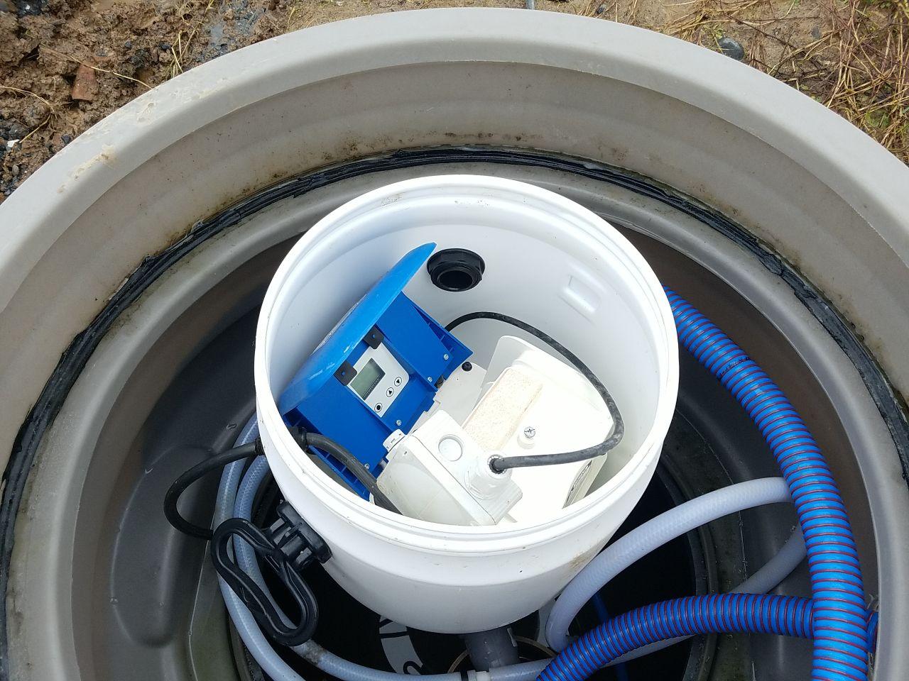

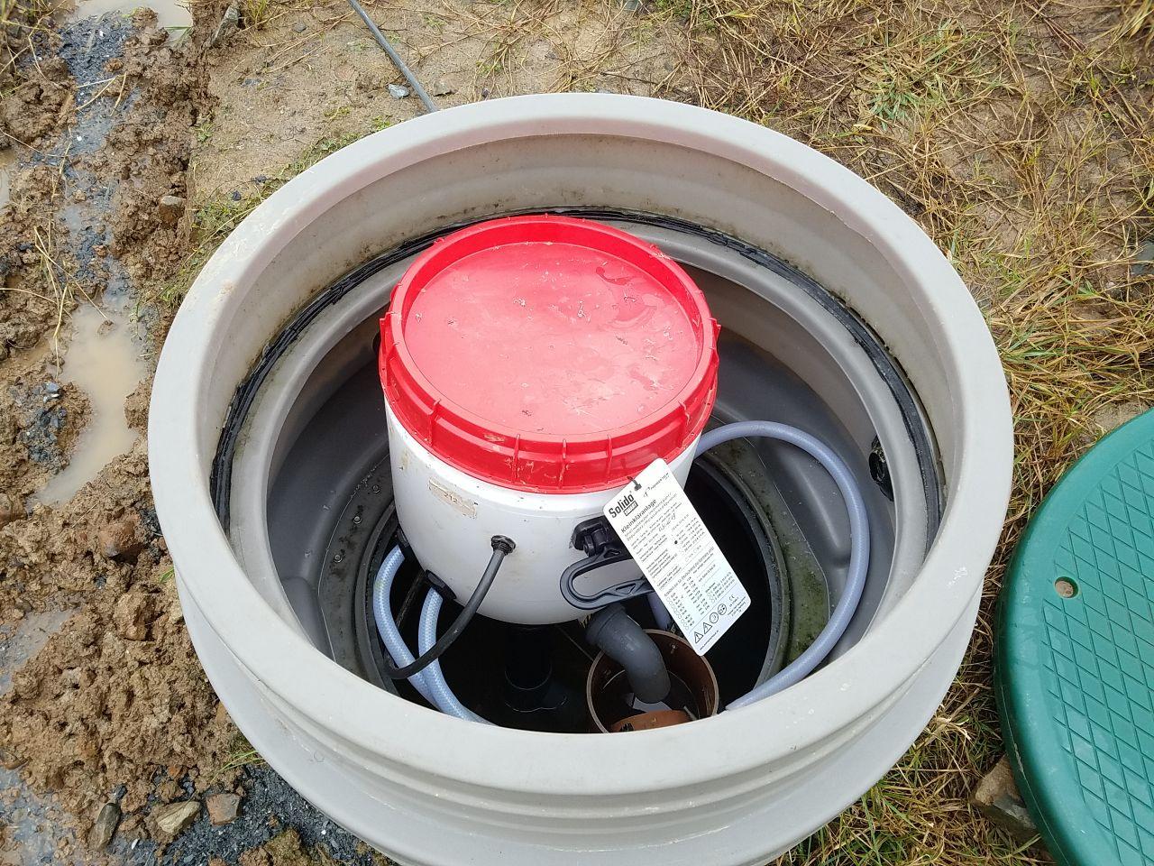

dpmiller Posted February 13, 2020 Author Posted February 13, 2020 Treatment plant wired in and running. Just the air inlet pipe to sort for the pump (I'm extending it so it's little stack is in the hedgeline rather than in thee middle of a lawn) but it's working. Very quiet. The Hiblow pump sits inside a sealed "bucket"- a screw-top vessel as used for storage on boats or that Sigma chemicals are supplied in- and this sits in the middle of the "manhole" atop the airlift pipe. So well isolated from the outside world. At power-on it did a 30-min airlift discharge cycle which does have a distinct trickling water sound and then settled into it's programmed bubble/ settle sequence. The bubble portion is 14mins, not quite sure what the settle is yet. From the manual this means it's set default as 8PE. When bubbling there's no noise whatsoever and the body of water heaves with a remarkable turbulence but no visible bubbles. I darned-near had to rest my ear on the closed manhole lid to hear the hum of the pump. It's double skinned poly which helps too no doubt. I've found a passord online to try on the controller. If it works I'll play with the menus a bit and reset down to about 5PE (there'll generally only be three of us in the house) If it doesn't I'll get the rep to pop in and do it, he lives locally. Piccies to follow. 1
dpmiller Posted February 13, 2020 Author Posted February 13, 2020 Password lets me view the menus but not alter, so Graeme is goiing to pop down and reset things for me. Here's the gubbins, as I was installing the air inlet hose earlier:

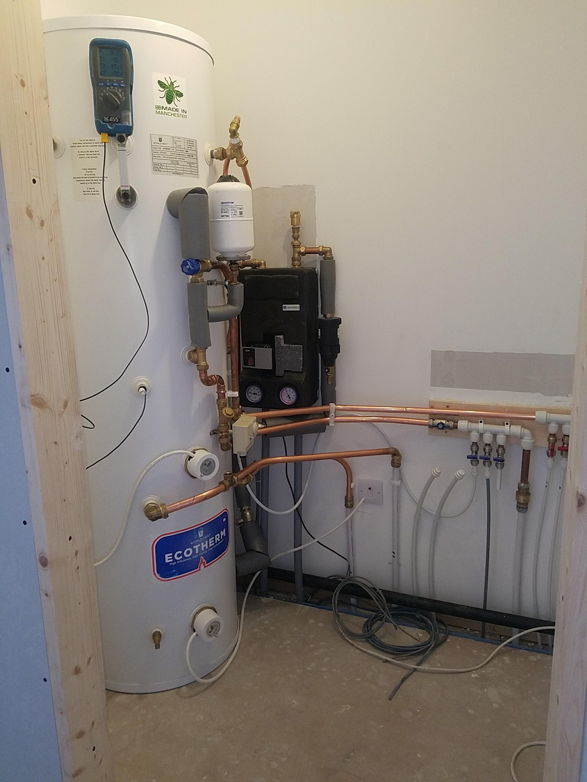

dpmiller Posted August 26, 2020 Author Posted August 26, 2020 And it keeps on keeping on. Down to my last stack of plasterboard. Been doing some diggering of soil and rubble outside so the topsoil mound is smaller than it was and we've an inkling of the shape of drive and garden. But more interesting stuff. As I'd mentioned elsewhere I'd ordered the thermal store- from the lovely people at World Heat- after it became apparent that Harlequin have moved away from larger and multi-coil variants of the Heatstream. Bit of a b*gger as I'd already pre-plumbed some stuff with it in mind. Hey-ho. 270l active, with expansion space above. Direct tappings from the boiler stove, an HP coil (15mx 35mm corrugated), a 15mx 25mm DHW coil, and two immersions. All in stainless. So tank is in place and sufficient of the plumbing done that I was able to fill it last night; from a stone cold start today it had got to over 51c and tripped out the 'stat (that I'd forgotten to turn up...) off diverted PV, and today wasn't terribly sunny. 7kWh diverted, according to the iBoost. I'm very happy with that.
dpmiller Posted August 29, 2020 Author Posted August 29, 2020 OK so what's the normal max to run a TS at? Fairly sunny today and both immersions (upper as master, then the lower one) have tripped their stats with the tank now at 82c. Aim for 85c?
PeterW Posted August 29, 2020 Posted August 29, 2020 TS can go to 90c but make sure you have a proper mixing valve setup that can take hot at 90c into the TMV.
dpmiller Posted August 29, 2020 Author Posted August 29, 2020 (edited) 4 hours ago, PeterW said: TS can go to 90c but make sure you have a proper mixing valve setup that can take hot at 90c into the TMV. It's as supplied, but I'll look into a copy of the MIs for the valve itself, thanks. OK for completeness it's a Reliance tempering valve and good to 99c Edited August 29, 2020 by dpmiller updating info 1

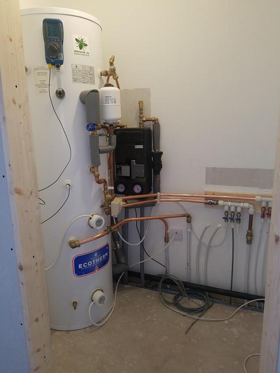

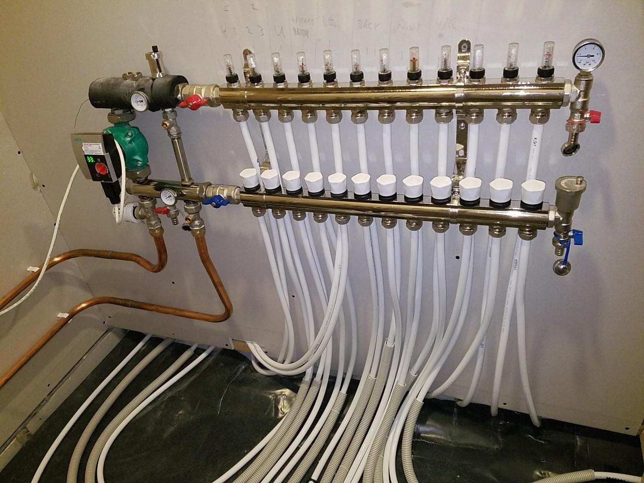

dpmiller Posted August 30, 2020 Author Posted August 30, 2020 Hot-press plumbing done, give or take. Just need to bring some cables up to a wiring centre on the wall and that'll be it for now. 2
Pete Posted August 30, 2020 Posted August 30, 2020 4 hours ago, dpmiller said: Hot-press plumbing done, give or take. Just need to bring some cables up to a wiring centre on the wall and that'll be it for now. What is the black box with the gauges on please?
dpmiller Posted August 30, 2020 Author Posted August 30, 2020 2 minutes ago, Pete said: What is the black box with the gauges on please? It's an Afriso pump station for the boiler stove, Like a Laddomat. Recirculates the water in a boiler stove until it heats to a useable temp before letting it into the tank. Improves combustion efficiency and boiler life. 1

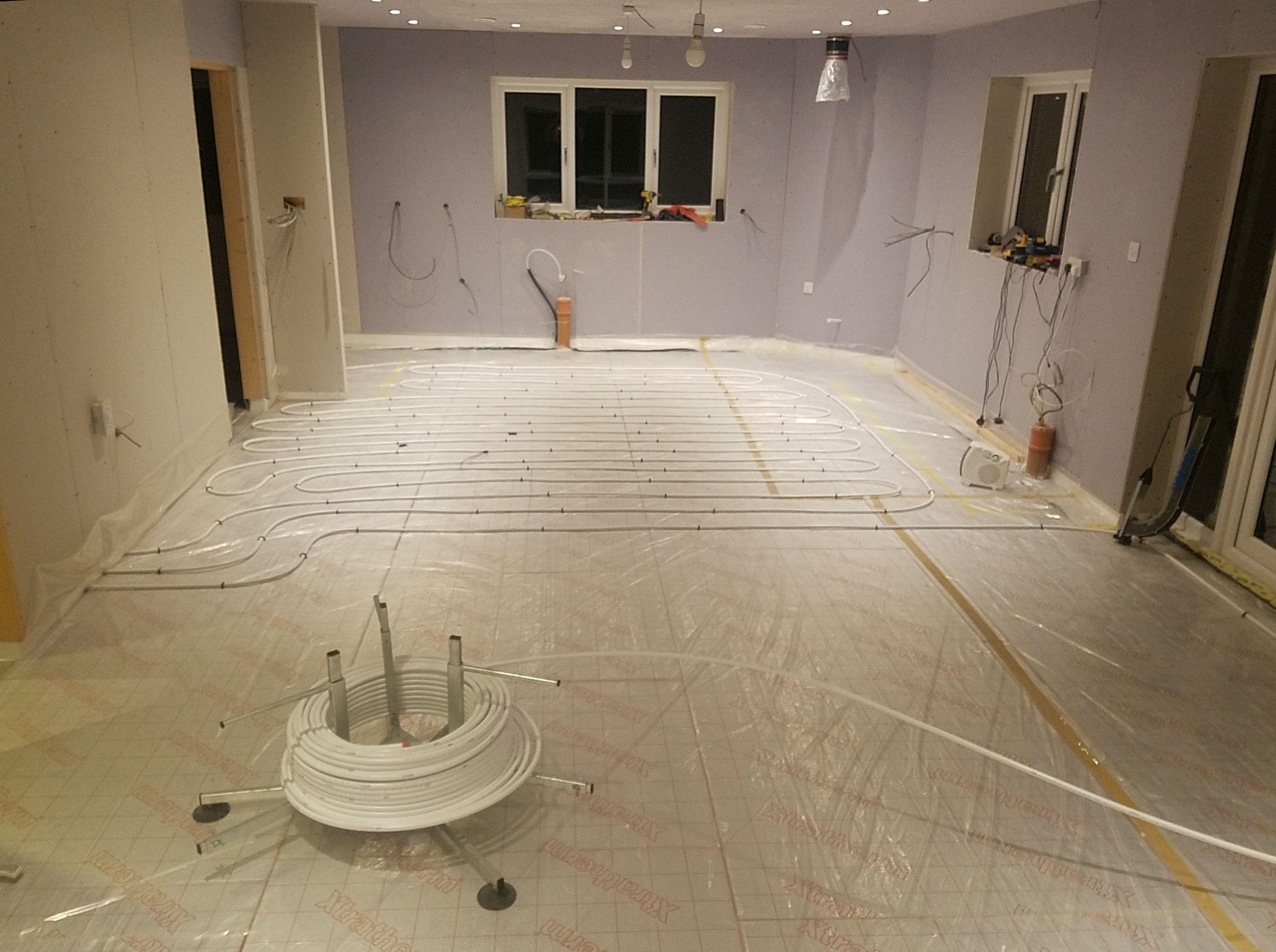

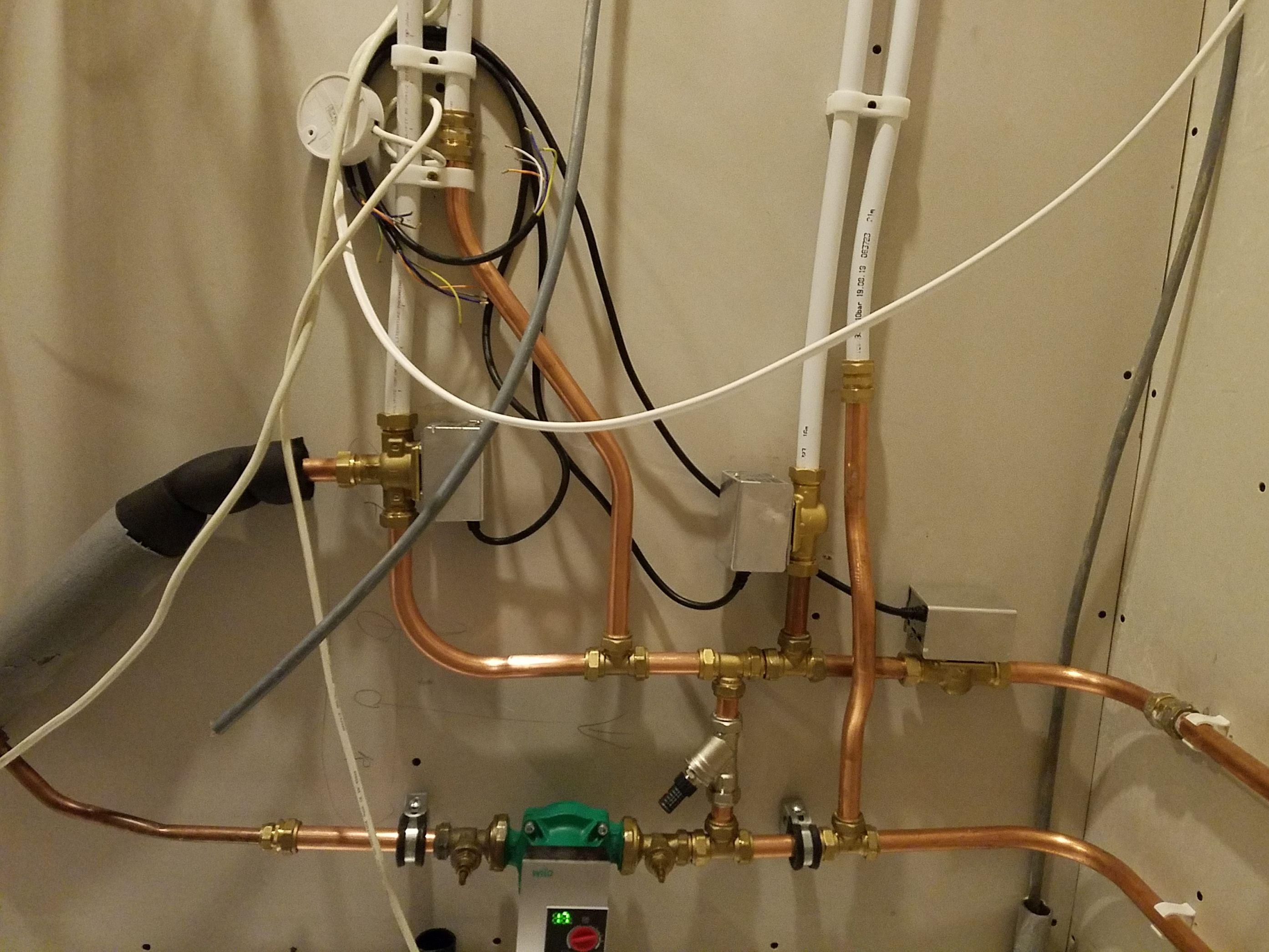

dpmiller Posted December 3, 2020 Author Posted December 3, 2020 (edited) Steady progress. Plasterboarding just about finished. Remainder moved upstairs for storage Ground floor cleared Insulation down (100PIR over 50 graphite EPS) Heating plumbing roughly in place Now working my way through the UFH pipework. About halfway there now... Willis on the left (and the piping from the ASHP will come through the wall in roughly that location). Diverter valve next (sorry @ProDave) defaulting all flow up to the TS's coil, mixing flows in the mid position and bypassing the TS when fully over. One 2-way valve sending up to the towel rail manifold, and the last sending round to the UFH manifold. Bypass valve to ensure necessary flow in all states. Interesting observation is that with the towel rail motorvalve open the is sufficient flow- convective or otherwise- to warm the FF ensuite towel rail even with the manifold pump off. And yes, I've pipe insulation to fit yet... Edited December 3, 2020 by dpmiller typos 1
dpmiller Posted December 9, 2020 Author Posted December 9, 2020 Date set for the screed pour- next Thursday (17th). Got the final loop down on the floor tonight, so that gives me a chance to go over the edge insulation, joints etc prior. Total loop length? 666 metres. Really. And no, not deliberately.... 1

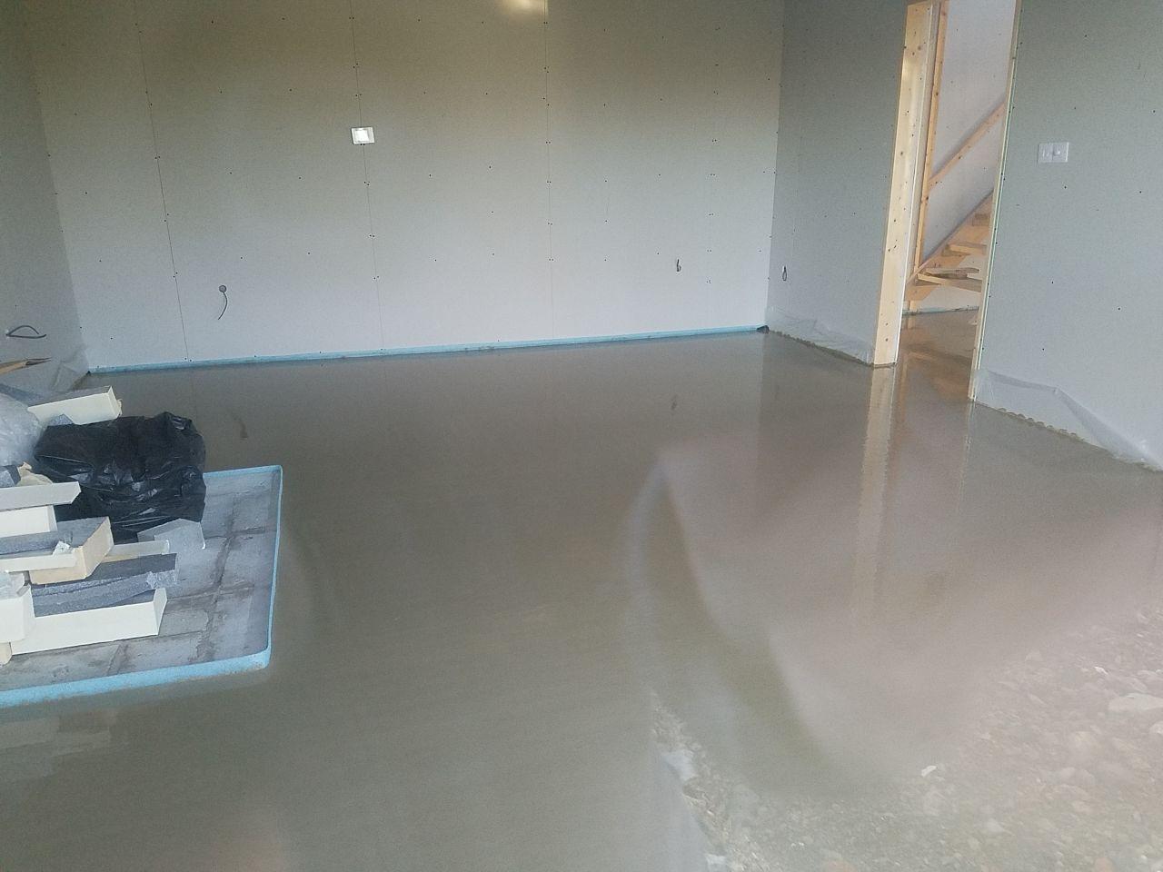

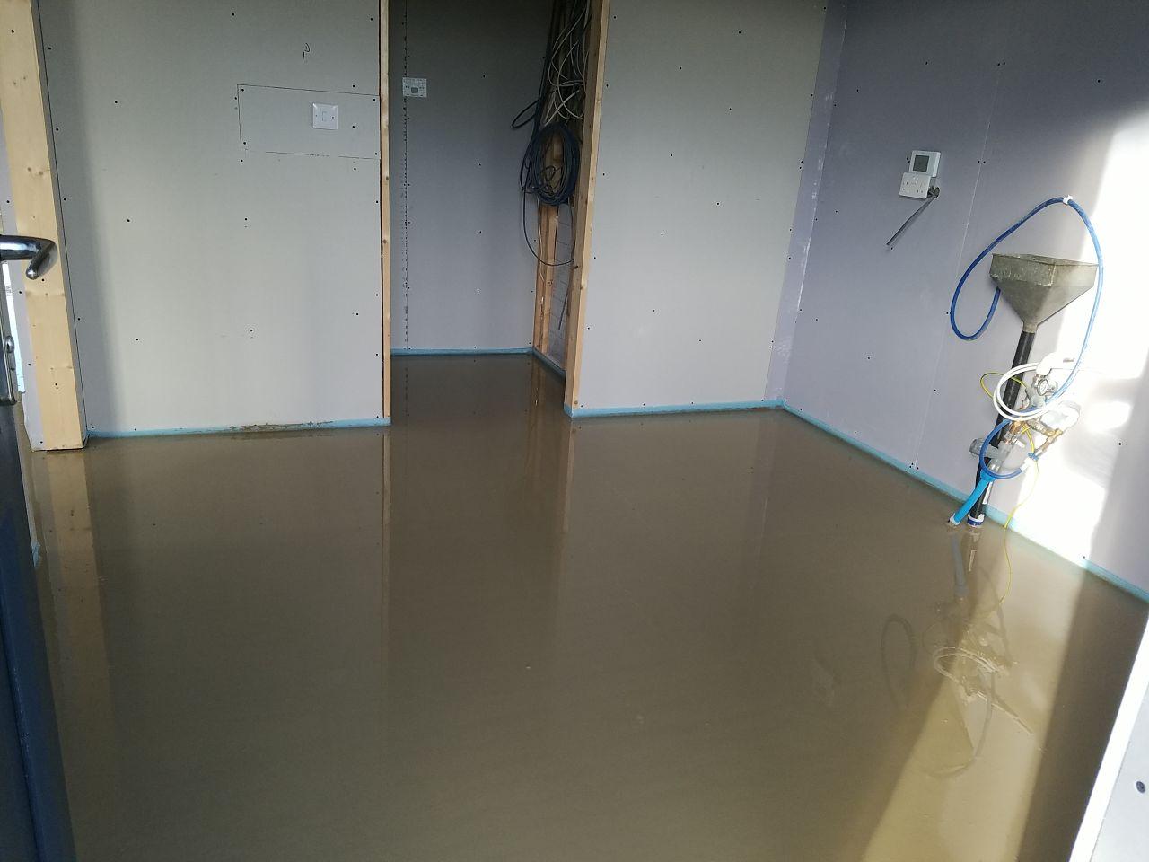

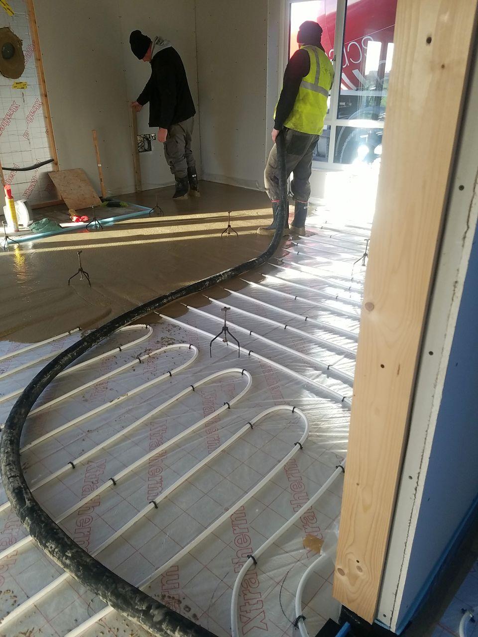

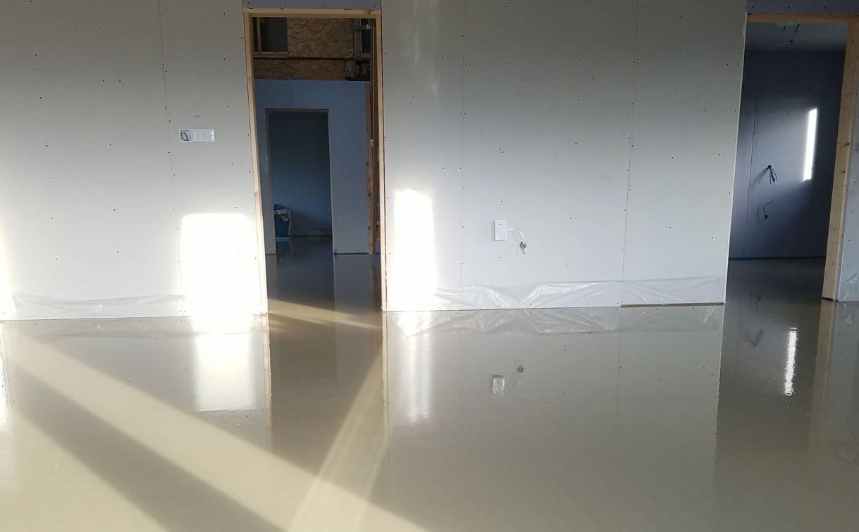

dpmiller Posted December 17, 2020 Author Posted December 17, 2020 Screed day! the two lads were on site at 0750 waiting for me to open up. They left shortly after 1pm, with 10 cube down at about 65mm average. Thankfully, nothing floated away during the process... 5
Oz07 Posted December 17, 2020 Posted December 17, 2020 You don't have to polythene over pir with that stuff to stop lifting?
dpmiller Posted December 17, 2020 Author Posted December 17, 2020 yes, there's a slip layer down. Still fearful of a breach tho...
Declan52 Posted December 17, 2020 Posted December 17, 2020 Company beside me have started doing thermal bead screed. It's supposed to do away with pir insulation.
