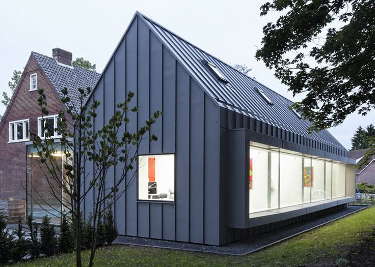

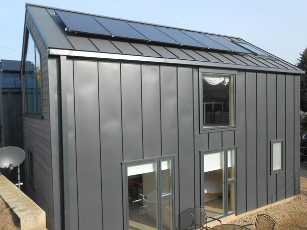

Visti Posted November 26, 2017 Posted November 26, 2017 Another consideration to using metals with standing seams that our architect pointed out was that the windows need to align with the seams to avoid it looking like a mess: vs
Russell griffiths Posted November 26, 2017 Posted November 26, 2017 Any idea who's that square gutter is @Visti, I can find lots of half round but not many square without going stupidly expensive.
Visti Posted November 26, 2017 Posted November 26, 2017 Don't know I'm afraid as it was one our architect sent us without a reference! @lizzie did mention Guttercrest the other day who I know do a square profile, but no idea how expensive they are!
Pete Posted November 26, 2017 Author Posted November 26, 2017 1 hour ago, Russell griffiths said: Any idea who's that square gutter is @Visti, I can find lots of half round but not many square without going stupidly expensive. The Tata steel one is a square profile that we are using via Catnic 1
lizzie Posted November 26, 2017 Posted November 26, 2017 Look at guttercrest they do a square (we didnt want round). They do bespoke too, which we needed for some bits, powder coated ali colour of choice. Very reasonable prices and really helpful tech dept. Mansel was really helpful. We chose them after looking at so many other companies and I am very pleased with product, service and price. guttercrest.co.uk
