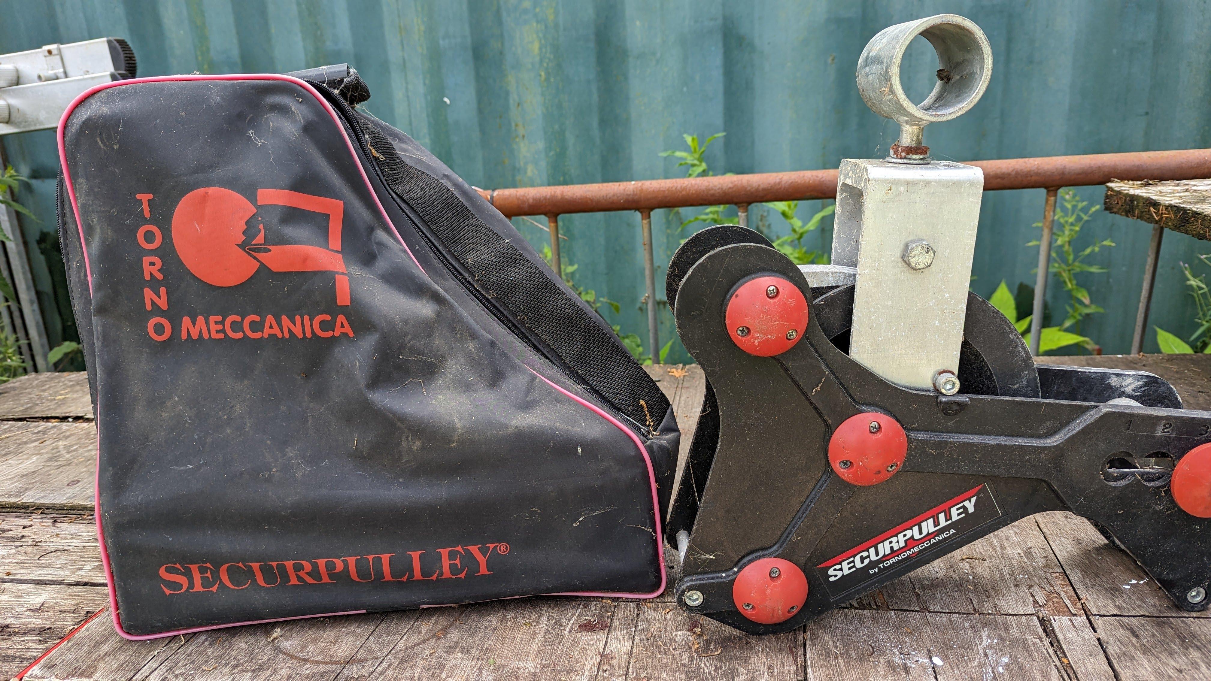

ToughButterCup Posted June 26, 2023 Share Posted June 26, 2023 This is what we used and hemp rope, a gin wheel , plus a bit of muscle. And a lot of pre-lift planning. We learned the hard way to keep the rope dry, because the auto-brake doesn't work very well when the rope is wet. I nearly killed Debbie lifting 25kg of concrete up to level 3 of the scaff - let go of the rope expecting the brake to do it's job, it didn't - whoosh, down it went : took about a year to regain the Brownie Points lost ..... Link to comment Share on other sites More sharing options...
Mike Posted June 26, 2023 Share Posted June 26, 2023 6 hours ago, Dave Jones said: If the scaff company have built a loading bay then it would probably be for loading materials ? If in doubt ask them Yes, do get confirmation of this. 14 hours ago, Declan52 said: If your loading out the floor don't skimp on the acrow props. +1 1 hour ago, ToughButterCup said: hemp rope, a gin wheel , plus a bit of muscle. Or get a 110V scaffold hoist for an easier option. Link to comment Share on other sites More sharing options...

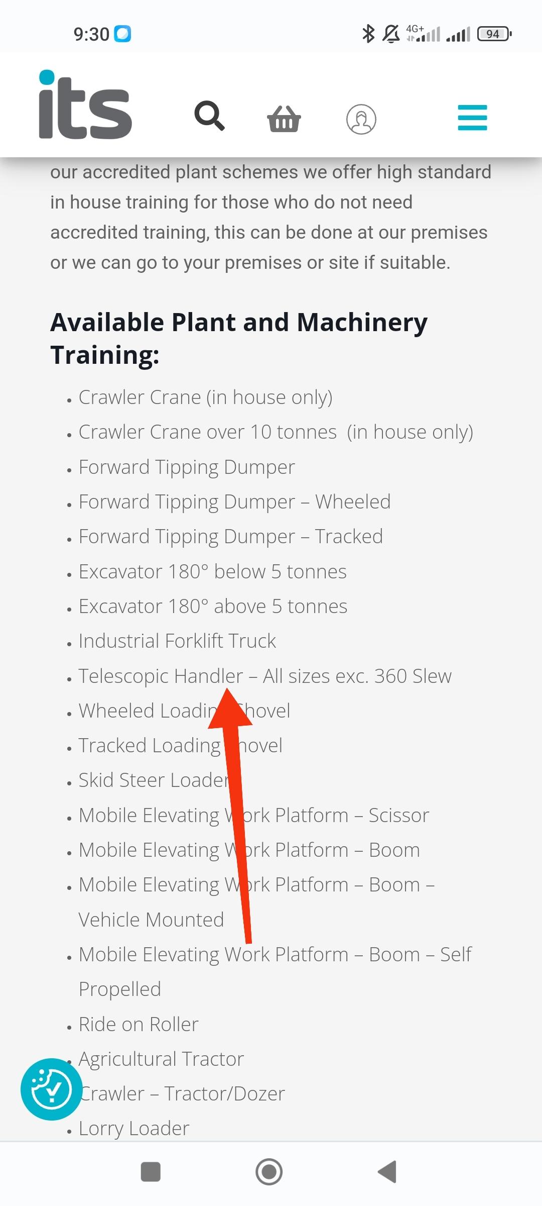

Dave Jones Posted June 26, 2023 Share Posted June 26, 2023 4 hours ago, Declan52 said: Having actually done my telehandler test I can confirm that this is lies. You do not need a licence to drive them at the start cause you need a minimum of 300 hours of site work experience before you go and do the actual test. This is because unlike learning to drive a car you can't just have easy access to this type of machinery so it's a given that the best place to learn is on site so you get a bit of leeway. Once you have your hours done you go to do your test. Attached is the actual course I done in the place I actually completed it. Also had my digger and dumper ticket as well just incase you say three don't exist. I didnt say private training courses don't exist I said a 'licence' doesn't exist. Which it doesn't. The big sites use CSCS type private training schemes because it suits them and their business model. If HSE visit they will ask for evidence of competence. This can be using a machine over many years, much like farmers do who also use telehandlers (yep see thousands of them queuing up every year to take telehandler tests lol). If you don't happen to have this experience you can certainly go on a course but it isn't mandatory and if you think a course makes you a safer driver than a farmer whos driven one for 20 years then your also mistaken. So back the original question, if the brickie has experience and says he is competent and YOU are happy he is competent then crack on. Buck stops with the main contractor which is you. https://www.hse.gov.uk/construction/safetytopics/telescopic.htm#training Link to comment Share on other sites More sharing options...
Crofter Posted June 26, 2023 Share Posted June 26, 2023 There must be more than one route in to gaining a telehandler ticket. I've got one, and all I needed to have before doing the course was a driving license. Btw I would second the suggestion of getting the delivery lorry to do the lifting. They have way more reach than a telehandler. Link to comment Share on other sites More sharing options...
