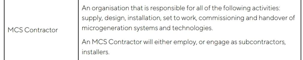

sharpener Posted April 24, 2023 Share Posted April 24, 2023 On 23/04/2023 at 19:39, JamesPa said: except that the legislation doesn't say 'MCS Noise Standards, it says 'MCS Planning Standards or other equivalent standards'. And the 'MCS Planning Standards', defined by MCS, require MCS installation and design, so an equivalent would (presumably) need to have similar constraints. If it were that easy, why has nobody done it. Bad drafting of the regs, I grant, but fact nonetheless This is the nub of it. Planning departments use the word "Planning" to cover different things (environment, noise) from MCS (system design, hp sizing). Not easy to fix now the confusion has arisen. In principle I think it should be possible to argue that the latter aspects are of no concern to the planners and so PD should apply provided the relevant parts of the MCS standards i.e. wrt noise and external appearance (if any) are met, and enforcement action against someone who met them whilst not being an MCS-certificated installer did not achieve any planning control objective and was therefore not in the public interest. But local planners are capricious and might require one to apply for retrospective p/p as a remedy. And then impose conditions which as you have found make no sense or defy the laws of physics - but they can be seen to have done their job and it is you that are non-compliant. Neighbour has a cellar with a window onto our property. MCS definition of "habitable room" does not mention cellars, just says (from memory) any "room" other than kitchen, toilet or bathroom. What about descriptive terms like library, study, studio, scullery, pantry, lobby, attic at least some of which would usually be regarded as "rooms", do we have to consider them or not? Or hall(way), corridor or landing - which are not normally thought of as "rooms" yet might be affected by noise? Or box room, store room, shower room, wet room, boot room, gun room, darkroom - which are "rooms" by their very nomenclature but not at all likely to be affected? IIRC there is someone on this forum who is a noise consultant, I wonder if he will tell us what the case law is on these definitions, they cannot be unique to ASHPs. Link to comment Share on other sites More sharing options...

RichardL Posted April 25, 2023 Share Posted April 25, 2023 (edited) @S2D2 £230 for householder planning, half that for a certificate if you are sure you are inside PD and just want confirmation, my lot are cheeky now and also want ~£100 just for a conversation with a planning officer for informal advice. Randomly in this part of the world you have to add to wildlife environments - hence the bird box requirement. The certificate approach usually doesn't need plans. TBH MCS wasn't mentioned either when I checked for the original PD unit, nor when this full application went through - is it a regional thing? Text of my application, this was accompanied by full elevation/site plan/location plan etc. Passed in Feb this year. Context --------- Continue projects to move the property away from Oil fired heating/hot water to sustainable options. The plan is to migrate to a combination of solar/battery and air source heat pump technologies. This proposal will complete the move of space heating away from Oil. Current situation ------------------- The property is currently heated with a combination of Oil boiler and one external air source heat pump unit. The air source heat pump was installed under permitted development terms, heating the timber frame half of the house & was successful in terms of functionality and costs over the winter months. The existing heat pump install was discussed informally with the planning dept. 1/2/21 and your colleague .... advised "...it is most likely that your proposals would be considered PD." - I proceeded on that basis with reference to the PD constraints he shared. I would like to expand the system. Proposed changes ---------------------- 1. Abide by Planning Policy Wales (PPW) 11 to enhance local wildlife and install a bird box 2-4m high on the north/east side of the Pear tree as indicated on the site block plan. 2. Install two external inverter/condenser units and discrete external trunking to supply heat to remaining rooms: The dining room, boot room and upstairs bedrooms. One additional unit sited at the back of the property. Mitsu..... Dimensions: w x h x d: 950mm x 330mm x 796mm Max noise level 51 dBA SCOP: 4:6-4:65 To heat: Boot room and upstairs bedrooms. Visibility: Front not visible from the ... road. Back not visible from the ... road. One additional unit sited near to the existing one next to the Lounge/Office area at the front of the property. Mitsu..... Dimensions: w x h x d: 800mm x 285mm x 550mm Max noise level 46 dBA SCOP: 3.74-4.2 To heat: Dining room. Visibility: Front not visible from passing traffic on ... road, units some visibility if standing at the front gate. Back not visible from the ... road. Edited April 25, 2023 by RichardL 1 Link to comment Share on other sites More sharing options...
RichardL Posted April 25, 2023 Share Posted April 25, 2023 @S2D2 For full context - this is the response - granted a bit old now from 2021 - re the original unit permitted development - there is the MCS standards statement - I guess it was implicit that I was using equivalent standards - I used terms like qualified installer/qualified electrician etc. I guess this does depend on local govt. development principles etc - may be different where you live - I could refer to the gov.wales document in my original PD conversation. Apologies I've had to remove some links which identify exactly where I am - Good morning Richard, The follow Welsh Government link provides additional detail on what is deemed Permitted Development for ASHPs: https://gov.wales/planning-permission-heat-pumps Installation of one air source heat pump used solely for heating purposes is normally permitted, provided that it complies with the MCS Planning Standards (or equivalent standards) and subject to the following conditions: · - no more than one air source heat pump can be installed on (or within the curtilage of) your property · - the volume of the air source heat pump's outdoor compressor unit (including any housing) must not exceed one cubic metre · - no part of the air source heat pump can be installed within three metres of the boundary of your property · - if in the case of the installation of an air source heat pump, a stand alone wind turbine is installed within the curtilage of the dwellinghouse · - the air source heat pump can not be installed on a pitched roof · - if installed on a flat roof, the air source heat pump must not be sited within one metre of the external edge of that roof · - the air source heat pump cannot be installed on a wall or roof which fronts a highway. An air source heat pumps must be sited to have a minimal effect on the external appearance of your property and the wider amenity of the area. For more details on restrictions applying to the installation of air source heat pumps, you should contact your local planning authority. From looking at the above it is most likely that your proposals would be considered PD. ...'s Renewable Energy Supplementary Planning Guidance also provides additional guidance (on 68/80): <link removed> Heat Pumps are PD if they are under 45KW, but my understanding is that most domestic heat pumps fall well within this limit. For proposals that are deemed permitted development you can apply for a Lawful Development Certificate (a.k.a. Certificate of Lawful Use – application form attached). This would be the only means by which to obtain a legally binding decision that the works qualify as permitted development. This can be obtained in the interest of any future property sale/conveyancing undertaken that would query the works. Link to comment Share on other sites More sharing options...
