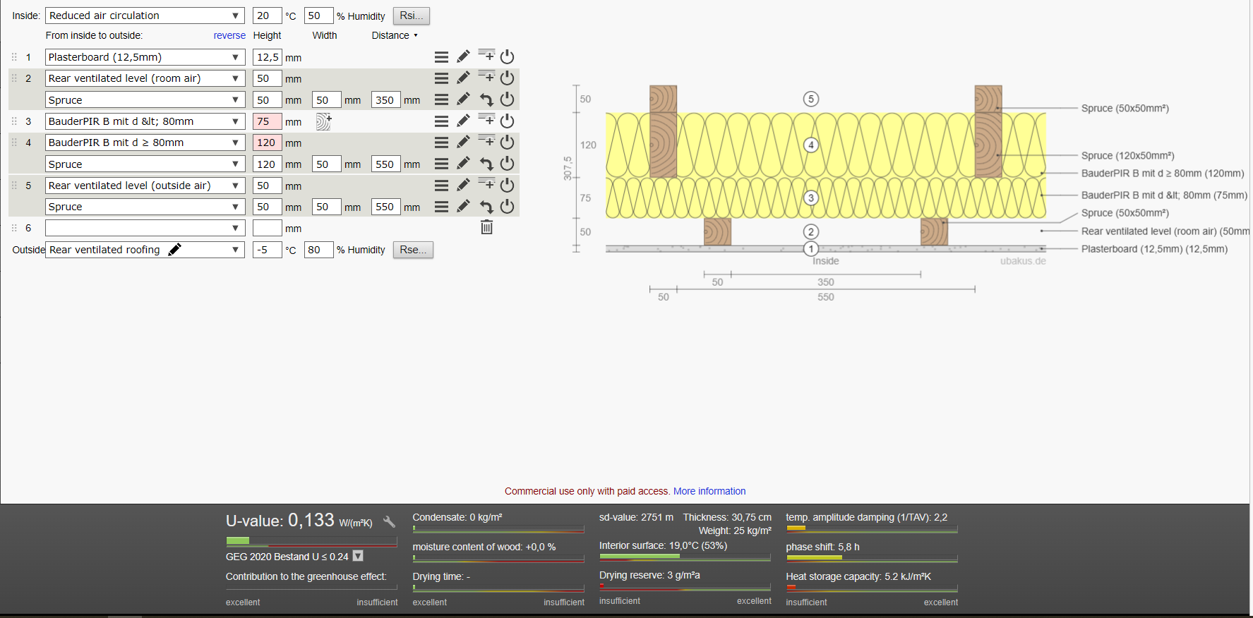

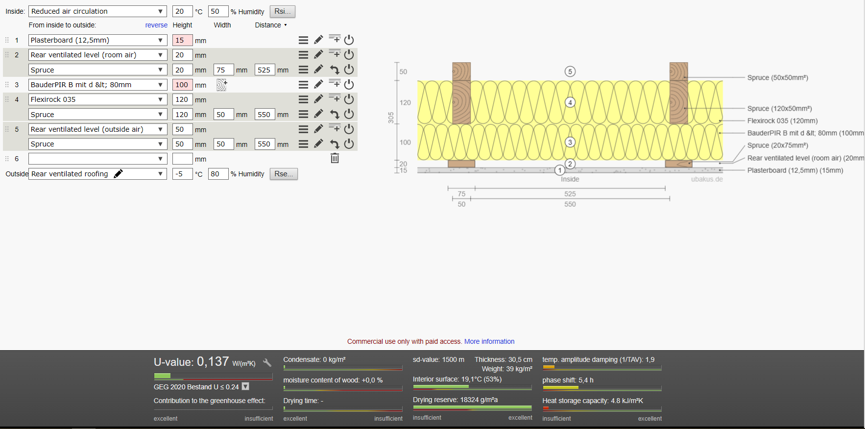

As @Iceverge's lovely U-value calculations show to get the same U-value as the PIR between the rafters you'll need 100mm PIR underneath. ultimately these decisions are all about compromise. we used https://www.insulationshop.co/140mm_isover_timber_frame_batt_32.html between our rafters (190mm of it) and 100mm PIR below. if you used mineral wool insulation with a thermal conductivity of 0.032W/mK you might get closer to the U-value with only 75mm PIR. i spent many hours going through different permutations on a U-value calculator to get what i wanted.

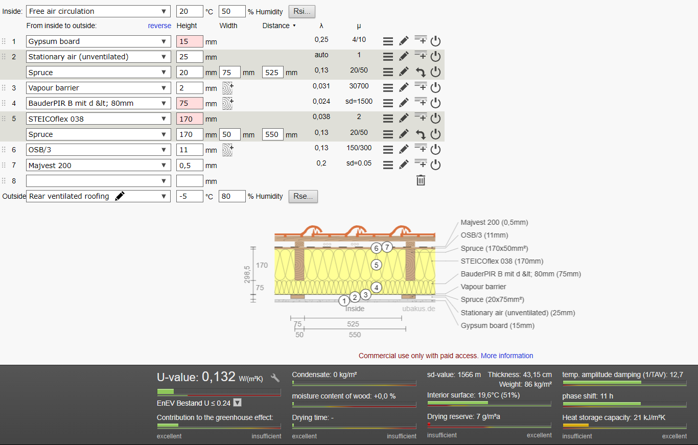

Running some quick costs on this. ( All from insulation4less)
Take 3 examples. All the same U value. Decrement delay ( for heat protection) is worst with all PIR at 7 hrs and best with full fill rock silk at 10hrs.   The cost of tape, screws , 50mmx50mm timbers and 100x25mm timbers are the same in all cases.
Celotex 120mm £20.38/m2
Celotex 75mm £13.12/m2
FM330  foam £/1m2
Total £34.50/m2
Rocksilk 37 batts 2 x 60mm £13.44/m2
Celotex 100mm £15.27
Total £28.71/m2
Full fill Rocksilk 180mm £20.16
Celotex 75mm £13.12
Total £33.28/m2
BUT
Fitting dense mineral wool batts is a pleasure, minimal itchiness and doesn't disintegrate like loft roll. Cut them with a sharp knife and they push right in. Almost zero wastage.
PIR is tricky to cut straight unless you use a table saw or similar and the dust is not pleasant. When you have 4 x 560mm spaces between the rafters you will end up with about a 160mm piece to play with from every board.  Wastage will be higher undoubtedly.
allways space the trusses so you have 400 gaps not centres, it may mean an extra truss to complete the run but this will be more than paid for in the un-wasted offcuts.

Thank you very much @Iceverge
I had also carried out these calculations and this just confirmed my decision.
I am going to go with 120mm Rockwall between the rafters then 100mm PIR over the top.
