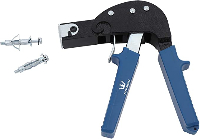

Radian Posted March 18, 2023 Share Posted March 18, 2023 If it can be attached with a bolt then these rivet-like anchors overcome the spinning rawlplug situation - so long as you insert them with the gun and not rely on the cage being pulled-in by doing up the bolt. 2 Link to comment Share on other sites More sharing options...

Temp Posted March 18, 2023 Author Share Posted March 18, 2023 Thanks folks. I have a triangular dormer and the way it was built and lined makes it hard to find timber behind the plasterboard. Was only able to find 2 nails with a magnet so probably 8 brackets will just be into plasterboard. It's only getting net curtains so no great weight. 4 hours ago, Radian said: If it can be attached with a bolt then these rivet-like anchors overcome the spinning rawlplug situation - so long as you insert them with the gun and not rely on the cage being pulled-in by doing up the bolt. Think I'll give those a go. The tool isn't very expensive on amazon. Think the brackets are a bit small to hide the hole needed for Grip-its. Link to comment Share on other sites More sharing options...
Nickfromwales Posted March 19, 2023 Share Posted March 19, 2023 10 hours ago, Temp said: Thanks folks. I have a triangular dormer and the way it was built and lined makes it hard to find timber behind the plasterboard. Was only able to find 2 nails with a magnet so probably 8 brackets will just be into plasterboard. It's only getting net curtains so no great weight. Think I'll give those a go. The tool isn't very expensive on amazon. Think the brackets are a bit small to hide the hole needed for Grip-its. Put the drill on very high speed. Drill a small hole, then a larger and then the final, without pushing on the drill whatsoever. If the plasterboard blows out behind, then these fixings won't hold very well. 1 Link to comment Share on other sites More sharing options...
Alan Ambrose Posted March 19, 2023 Share Posted March 19, 2023 +1 for the anchors that Temp suggested. Treat v gently until they’ve pulled in, otherwise they can fail in all sorts of ways. Fischer brand are best in my experience. Link to comment Share on other sites More sharing options...

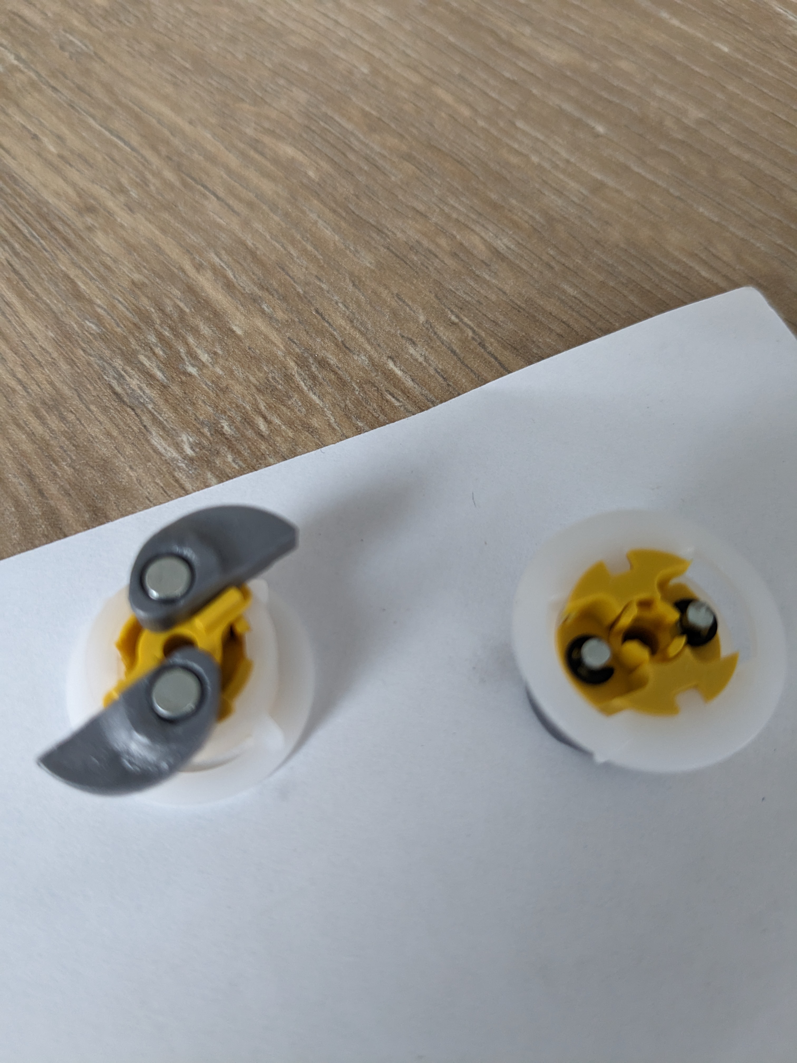

SimonD Posted March 19, 2023 Share Posted March 19, 2023 (edited) 16 hours ago, Temp said: So what's your favorite fastening for plasterboard? The number of failed rivet like fixings I come across behing radiators is ridiculous. For ultimate strength where there's good room behind the plasterboard I use Geefix fittings - https://www.geefix.com/ Otherwise I use Toggler Snaptoggle fixings - https://toggler.co.uk/snaptoggle/ Snaptoggles are the easier and quicker to fit but the Geefix ones are super strong. Edited March 19, 2023 by SimonD Link to comment Share on other sites More sharing options...

saveasteading Posted March 19, 2023 Share Posted March 19, 2023 I agree with Radian. We once had multiple toilet cubicles to be fitted by the manufacturer, and they were clearly wary of the wall fixing efficacy. You would think they would have a preferred solution. After research we supplied these expanding fixings with rivet gun. It worked really well. Fitted impressed and no follow-up issues after years in a school. Without the gun these fixings are a pain. Link to comment Share on other sites More sharing options...
