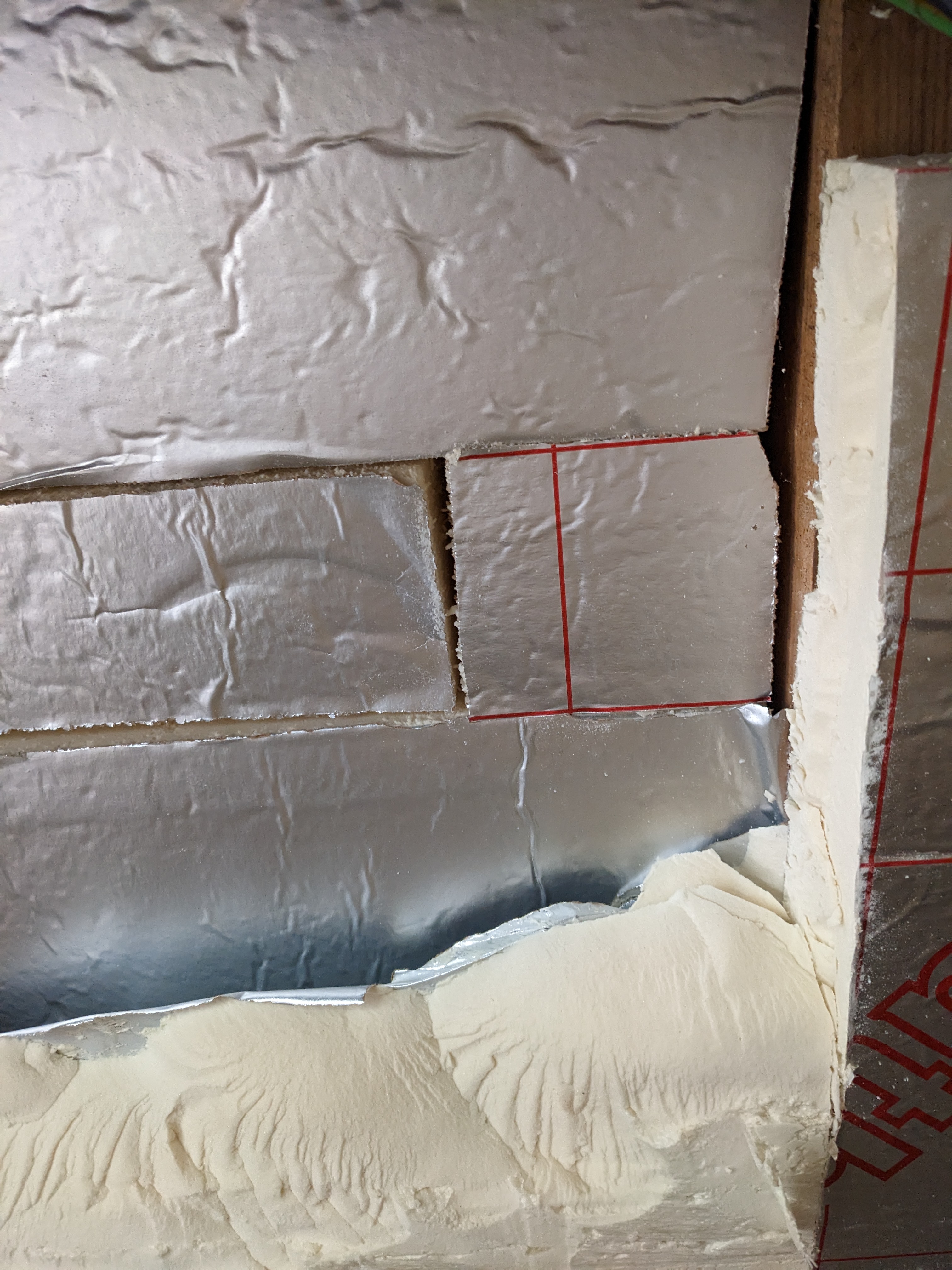

Hi,

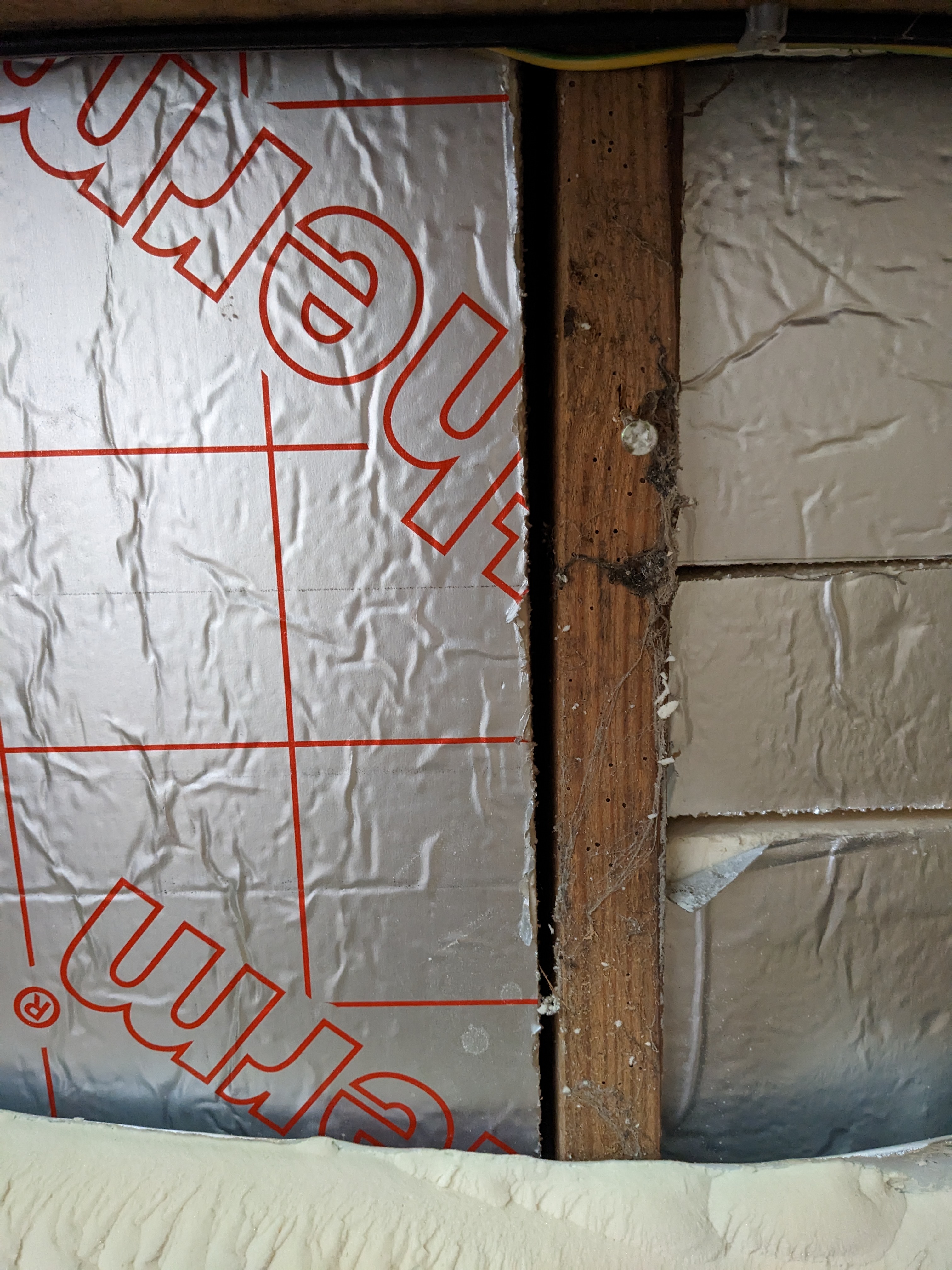

We had a new roof put on with a breathable membrane under the slate. We've opted for celotex insulation between joists/rafters and a second layer on top to get it up to spec. I had my suspicions and took a piece of the top layer off and sure enough none of it is either cut to friction fit not have the gaps been foam filled. I can fit my fingers in the gaps. Builders are telling me this fine....  I don't think it is. Am I right?
No, absolutely not fine! But depressingly common. I have had a contractor tell me the same thing, but being told it is fine does not make the insulation value any better. If the 2nd (under-side) layer is not completely tight to the first (between-rafter) layer, and the ventilation is working as it should, then you may even get thermal by-pass - cold ventilation air getting between the layers of the sandwich and effectively negating the effect of the between-rafter layer.
You’re right. Builders are wrong. They either know they are wrong  and fobbing you off or they don’t understand how insulation works.

No it's not fine.  You are right.  These sorts of gaps are enough to allow air circulation within the panels and this will drop the effective U value.  It would only have added a few mins per panel to use filler foam to seal the gaps.  Sloppy workmanship, plain and simple.

It's all over. I've asked for £1500 back to get someone else in to fix it as work is currently crazy busy. I doubt I'll get it but if you don't ask, you don't get.
If you've time it's easily DIYable. We did all our insulation ourselves for this reason - knew trades would be half-arsed and have no attention to detail. Nothing a bit of foam and some foil tape won't sort.

Frosty morning: ice on the roof. Pools of melt-water on the roof when the rest of the roof is still frozen?
Not OK.

Also, your timber has signs of woodworm, has it all been treated?

Woodworm is old.
It's not plasterboarded yet thankfully. It will be a matter of taking the top layer off and foaming everything underneath and replacing and retaping the top layer. In theory it shouldn't take too long but it's the ball ache of it and it shouldn't be like that in the first place.
That's good, it'll soon be a long forgotten memory. A diligent amateur would surely take up the task if offered a few ££. Just retain the cost from the builder and document all the poor workmanship to ensure they have no comeback.
Don't cheap out on the foam either. Something that remains flexible and doesn't shrink.
