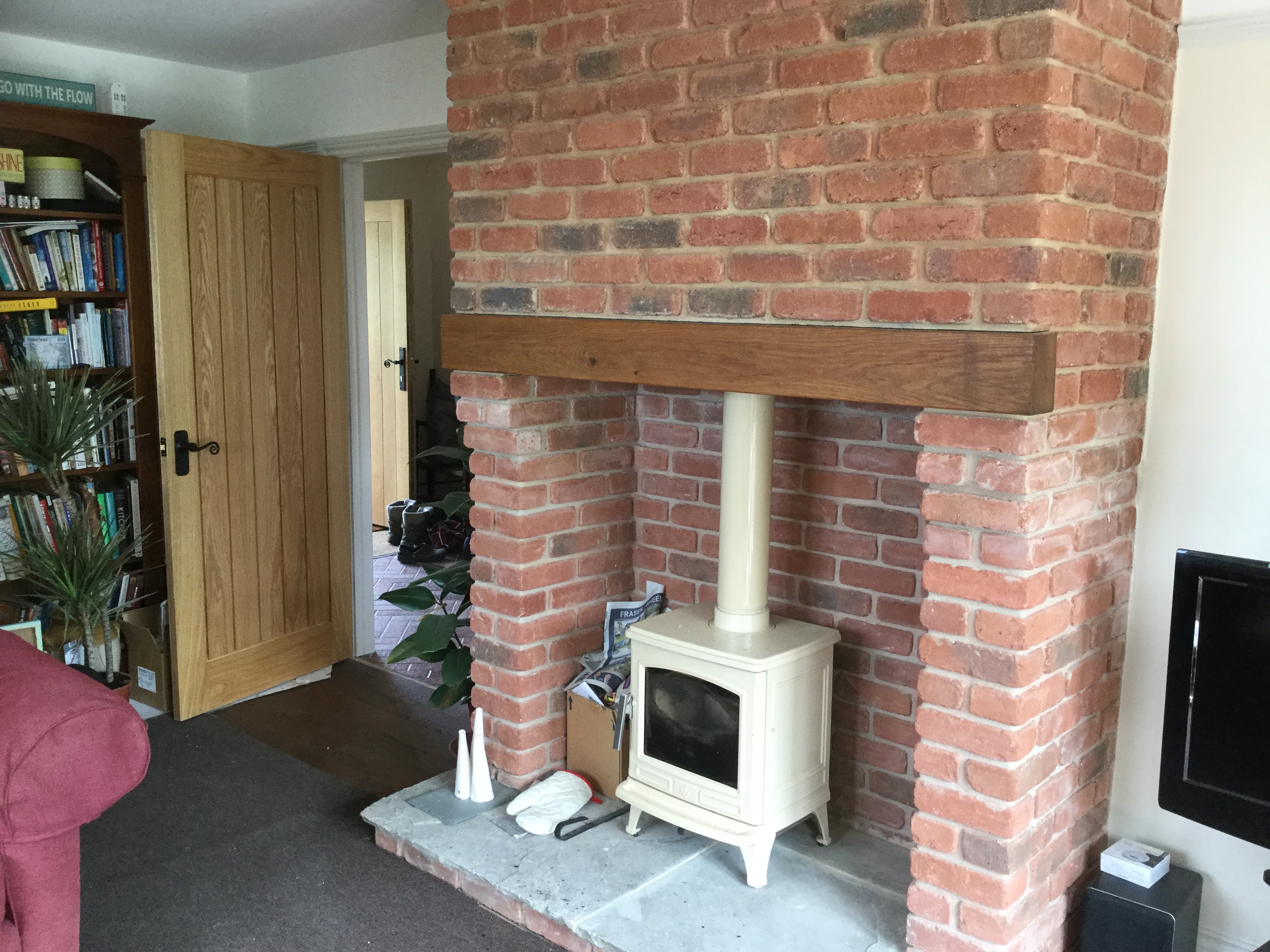

joe90 Posted January 27, 2023 Posted January 27, 2023 With my brick build the bricky used some lime in the mix and it looks good, the joints are about 12mm and the bricks “tumbled” (put in a revolving drum to knock the corners off to make them look old) very pleased with the result.
