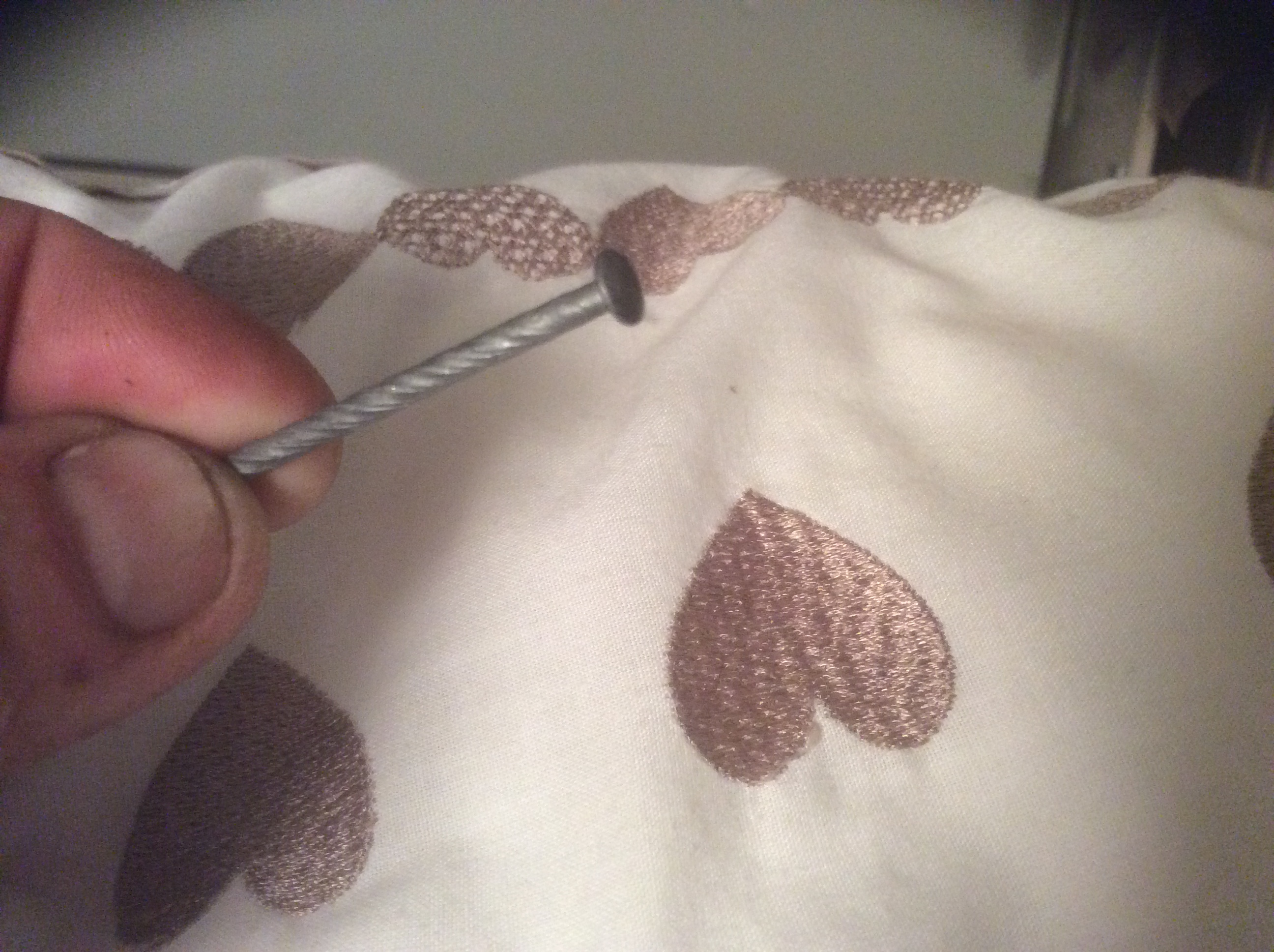

I too have used a coil nailer,stainless with a twisted shank, stays in place like a ring shank
i will see if I have a couple about for a pic.

Can you imagine this in stainless, I fired them out of the coil nailer, but any near the end I pre drilled and banged in with the estwing.

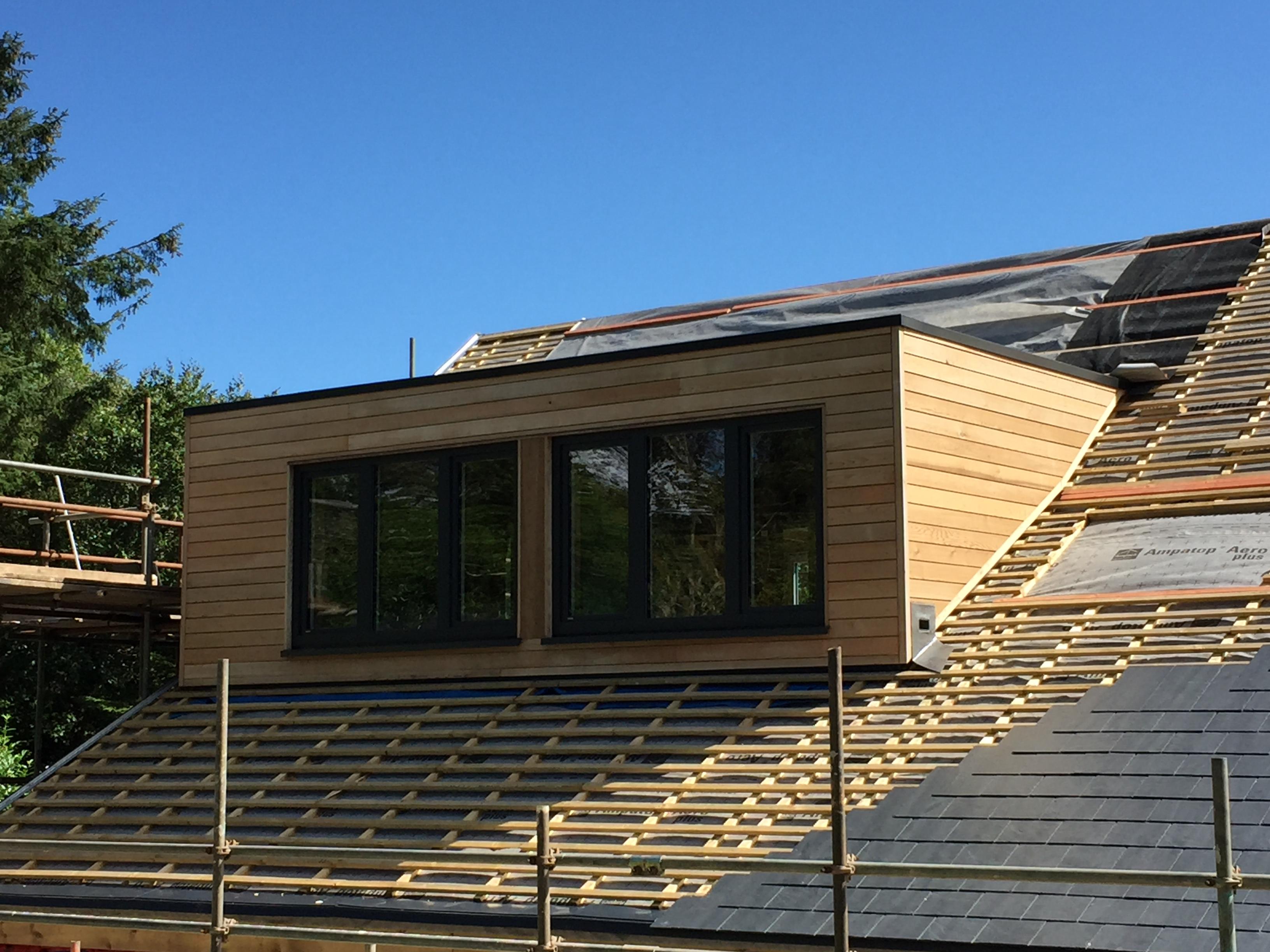

Went with the Spax stainless 20170730_132615251_iOS.thumb.jpg.a19fc8ffcc056555b890558b3bdf0338.jpgin the end. If it would only stop raining I could get it finished. :/
1 minute ago, Construction Channel said:
Looks very nice indeed, I cant see the fixings at all but i assume they look good to :)
4.5 heads so pretty small. But all perfectly aligned on the h&v :)

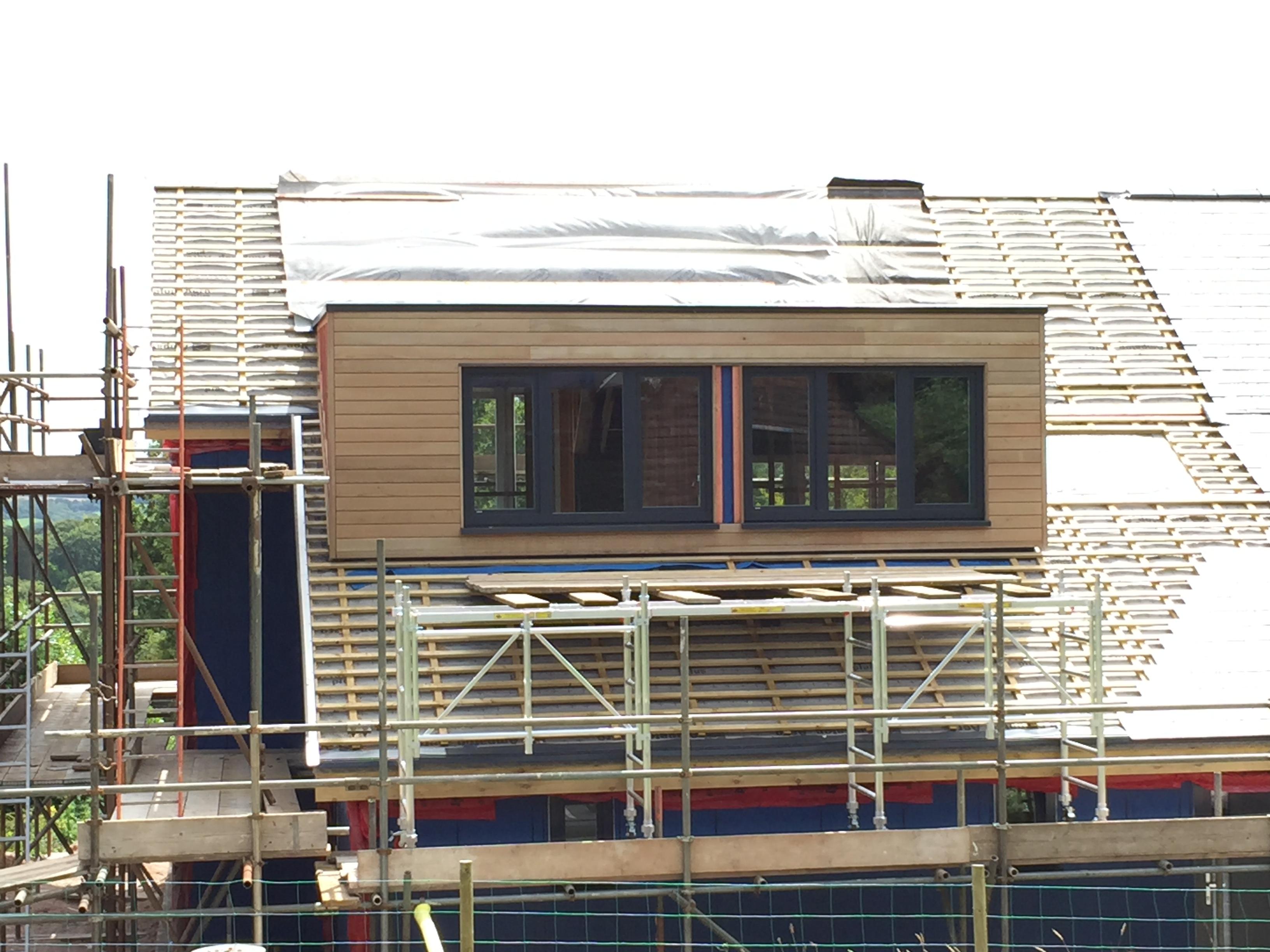

The job is done.
If anyone is wondering how fast Sioo:x changes the colour of cedar then look at the centre panel (between the windows) 20170805_143608567_iOS.thumb.jpg.2bc9c944b156dc1641832a0bc592311e.jpgwhich I didn't install until this morning compared to the rest over a week ago. It was hand applied and I seem to remember @iSelfBuild saying that his hand applied Sioo coated cedar went grey very quickly. As I understand it it's rain and sun that accelerates the process and its lashed it down a fair few times in the last week.

Yes, I'm really impressed. It really tones down the Cedar shades which creates a more uniformed finish.
I'm hoping it goes a lovely silver grey patina.
