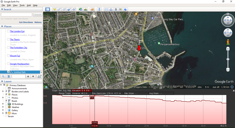

SteamyTea Posted January 8, 2023 Share Posted January 8, 2023 (edited) 5 hours ago, Radian said: Neither altimeter or GPS are going to be any where near accurate enough. Maybe to the nearest 2m but that's about it Interesting, I put my GPS logger on today, drove 600 miles, parked back in my drive and the altitude gap was 2' (600mm). But I think a simple water level is the easy way for house stuff. There was a 'thing' in Google Earth were you could run the cursor over an area and it would work out the heights to quite good accuracy. Can't for the life of me remember how to do it. May have been this: View Path's Elevation Profile https://support.google.com/earth/answer/148134?hl=en I am too tired to try it now. Actually, I tried it. Dead easy, but not sure how accurate it is. Edited January 8, 2023 by SteamyTea 1 Link to comment Share on other sites More sharing options...
Radian Posted January 8, 2023 Share Posted January 8, 2023 49 minutes ago, SteamyTea said: Interesting, I put my GPS logger on today, drove 600 miles, parked back in my drive and the altitude gap was 2' (600mm). GPS suffers from Dilution Of Precision due to the changing geometry of satellites as they orbit relative to ground locations. Altitude error is generally specified as having 1.5 times the horizontal error - which itself is in the order of a few meters. Your results are surprisingly close! I'd say more down to luck than precision and accuracy was probably way off. You can do much better by measuring air pressure. Very roughly speaking, referenced to an air pressure of 1000mb at sea level, pressure falls reasonably linearly to 500mb at an altitude of 5000m (with half of the Earth's atmosphere sitting below this altitude) so pressure changes by around 0.1 mb/m. A typical digital pressure transducer is only precise to this sort of amount so you could only use one to estimate height to within 1m steps. A fancy one might improve on this by a factor of 10 but would be difficult to get repeatable measurement's from it. Link to comment Share on other sites More sharing options...

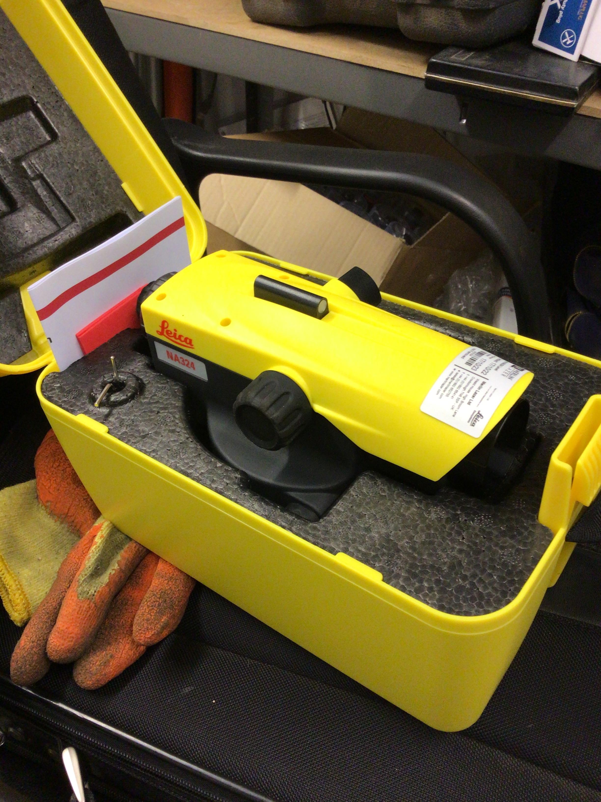

markc Posted January 10, 2023 Share Posted January 10, 2023 1 hour ago, Bonner said: Theodolite, which is a challenge to spell or even say, hence the common term ... which I don’t know the origins of thinking about it ... Dumpy level is not a theodolite, dumpy is a small automatic level and theodolite is for measuring vertical and horizontal angles/setting out etc. pic here is a dumpy level. 1 Link to comment Share on other sites More sharing options...

LSB Posted January 22, 2023 Author Share Posted January 22, 2023 On 10/01/2023 at 08:28, markc said: Dumpy level is not a theodolite, dumpy is a small automatic level and theodolite is for measuring vertical and horizontal angles/setting out etc. pic here is a dumpy level. ooh, that's a nice shiny bit of kit which HID would want instantly if he saw it 1 Link to comment Share on other sites More sharing options...
