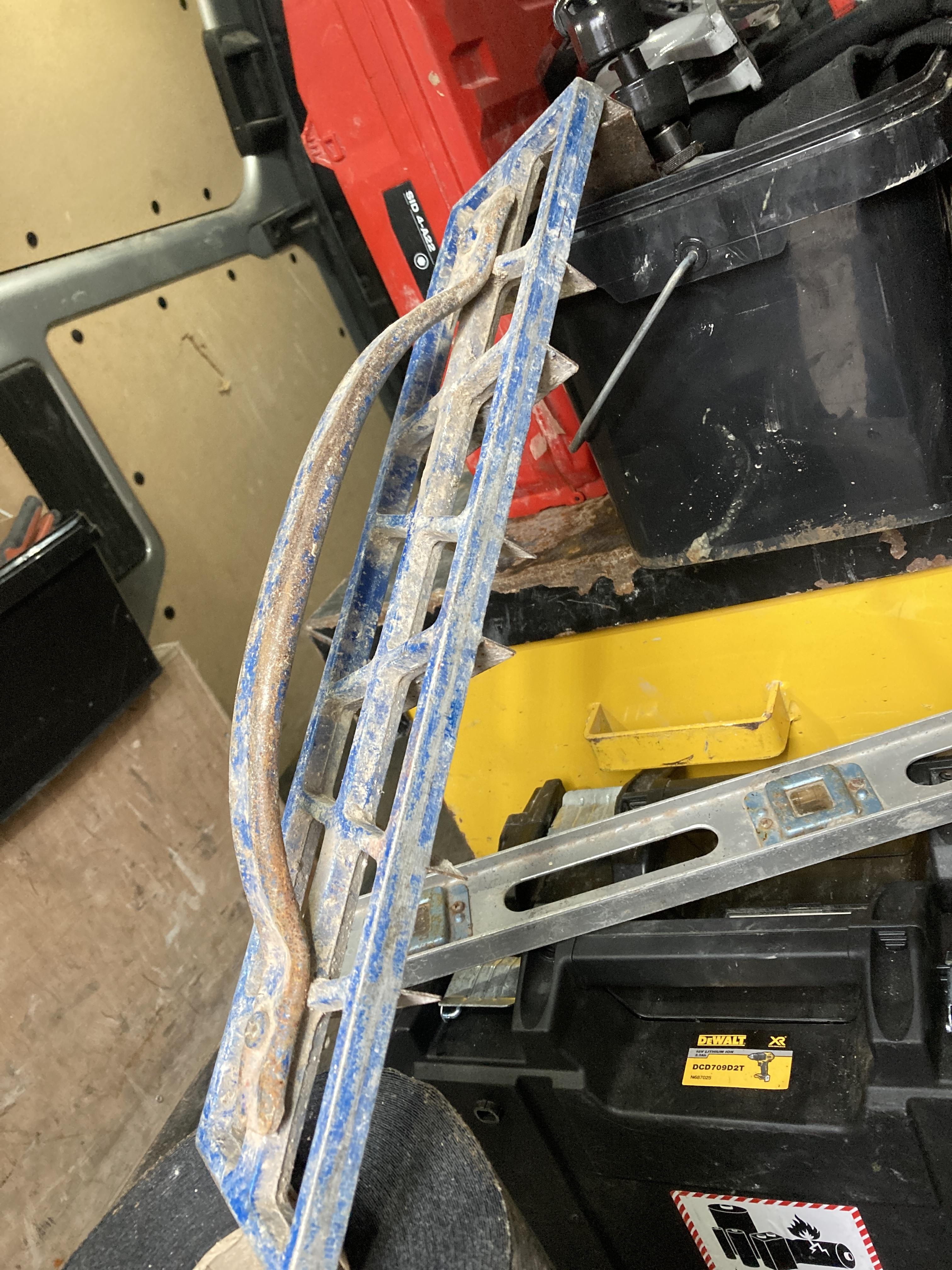

Mr Punter Posted December 27, 2022 Posted December 27, 2022 3 hours ago, nod said: I have not seen this before. What is it called / used for?
nod Posted December 27, 2022 Posted December 27, 2022 1 hour ago, Mr Punter said: I have not seen this before. What is it called / used for? Angle plane Gives nice sharp angles and takes any high spots off 1

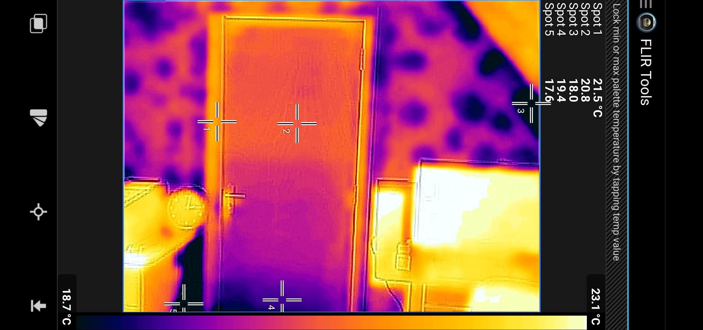

Radian Posted December 27, 2022 Posted December 27, 2022 One small wall in my recent room-in-roof garage extension got the D & D treatment - as I'd missed giving any other instruction for it and the builders automatically reached for the easiest solution: The wall has two concrete block leafs with EPS insulation in the cavity. The plasterboard was fitted up to the slope of the roof (visible at top right) and . While there was an attempt to put a continuous bead around the perimeter (as the contractor assured me had been done) clearly there are gaps so any infiltration from the cavity works its way around the edge and blows around behind the boards. I just don't see enough care and attention ever being likely to be applied in the construction industry. One small gap in a supposedly continuous bead of adhesive can open up an entire wall to external air currents totally short-circuiting the insulation.
ProDave Posted December 27, 2022 Posted December 27, 2022 4 minutes ago, Radian said: I just don't see enough care and attention ever being likely to be applied in the construction industry. One small gap in a supposedly continuous bead of adhesive can open up an entire wall to external air currents totally short-circuiting the insulation. I am convinced the only way the average building monkey will ever get a room in roof right, is to make the entire roof a warm roof. Fairly easy to detail, then all the roof space even the bit not used for the rooms, is inside the warm envelope of the house.
Radian Posted December 27, 2022 Posted December 27, 2022 3 minutes ago, ProDave said: I am convinced the only way the average building monkey will ever get a room in roof right, is to make the entire roof a warm roof. Fairly easy to detail, then all the roof space even the bit not used for the rooms, is inside the warm envelope of the house. Amen to that. But as we are right on the border of a conservation area, adding 200+mm to the ridge height was going to put a major crimp in our planning approval.

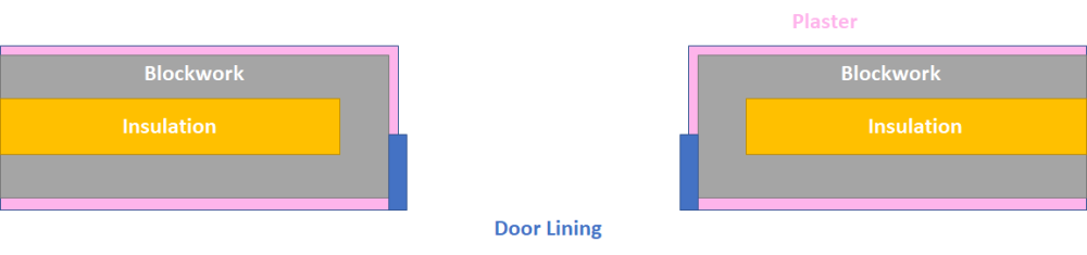

MortarThePoint Posted May 8, 2023 Author Posted May 8, 2023 Door linings are progressing nicely and I am staying a week ahead of the plasterer there. I only have three more to do in blockwork now. One of them is a bit odd though. It's an interior section of a cavity wall. The Utility is a single storey bit on the side of a two storey wall so the lower part of the cavity wall is warm on both sides and has no cavity closer, just a full blockwork reveal. What's the normal ay of doing a door lining in this situation? fit it to one side and plaster up to the back face of the door lining? Not sure how the plasterer would get a good edge on the back face of the door lining.
