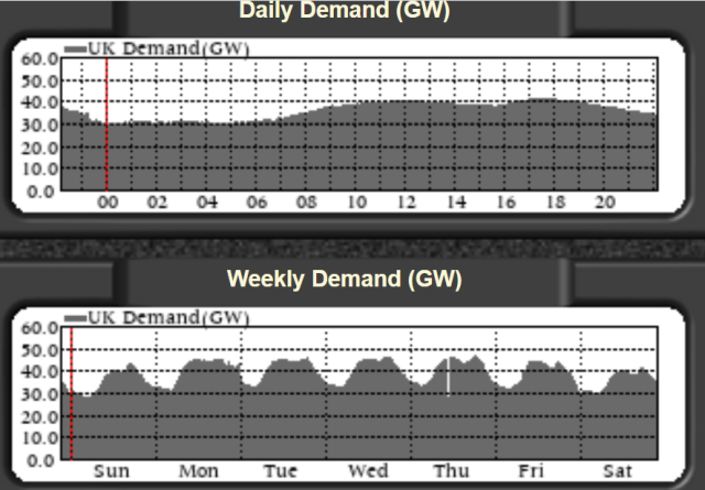

MikeSharp01 Posted December 18, 2022 Posted December 18, 2022 12 hours ago, Radian said: The flipside of £40/day bills is the strain which that kind of energy demand puts on our generators and networks. Everything is connected to everything else and not many people are thinking through the 1st order consequences let alone the second and third order unintended ones. We need to get our head in order so as to steer a path through this lot. 1

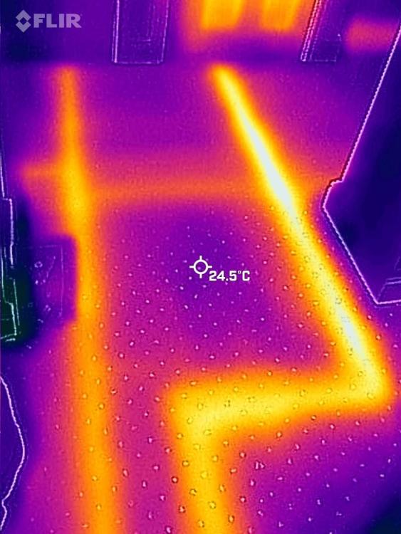

GrantMcscott Posted December 18, 2022 Author Posted December 18, 2022 3 minutes ago, Radian said: How is the ground floor constructed? For all we know the UFH could be shorting to ground. Of course it won't be but the first thing I noticed was setting the timer for 20oC at 6:30 - which smacks of you expecting things to warm up by 7, when you fire up the woodburner. The response time of UFH is going to be such that you'd come in and out of setback at a much earlier time. Do you have a log of indoor temperature throughout the day? I'm not so familiar with ASHP when used with UFH but it might be that people would even suggest having no setback at all. Slab with 150mm PIR then 40mm PIR covering the joints then UFH pipes and then 68mm screed. no logs of indoor temp
Onoff Posted December 18, 2022 Posted December 18, 2022 22 minutes ago, GrantMcscott said: The windows were sealead with expandable foam all around where possible as for eample the one in the utility is siting on the frame so hard to get a seal to the bottom. so it has a draught that needs to be fixed It's really not hard to get a seal there if the right product was used. The expanding tapes are great for this sort of thing. Expensive and you need your wits about you to use them. Sadly the average bodging builder will resort to foam, cheap foam at that and often after the event. Would it pay in the long run to have the windows removed and refitted?
Radian Posted December 18, 2022 Posted December 18, 2022 3 minutes ago, GrantMcscott said: Slab with 150mm PIR then 40mm PIR covering the joints then UFH pipes and then 68mm screed. OK, that's a reasonable amount of insulation. I would expect it to take 4 or 5 hours to bring the room up a couple of degrees depending on floor finish. You really need a cheap temperature logger to see what's actually happening.
