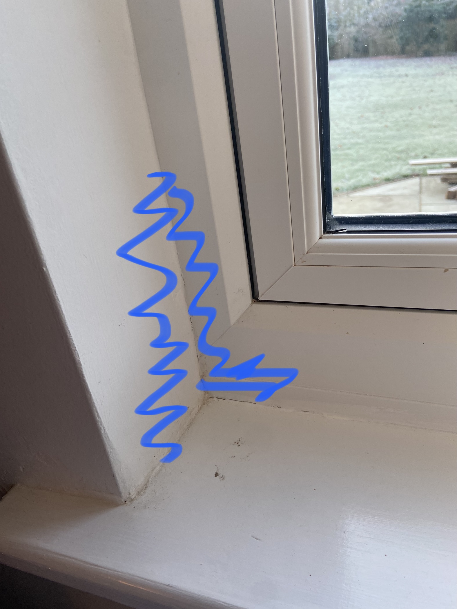

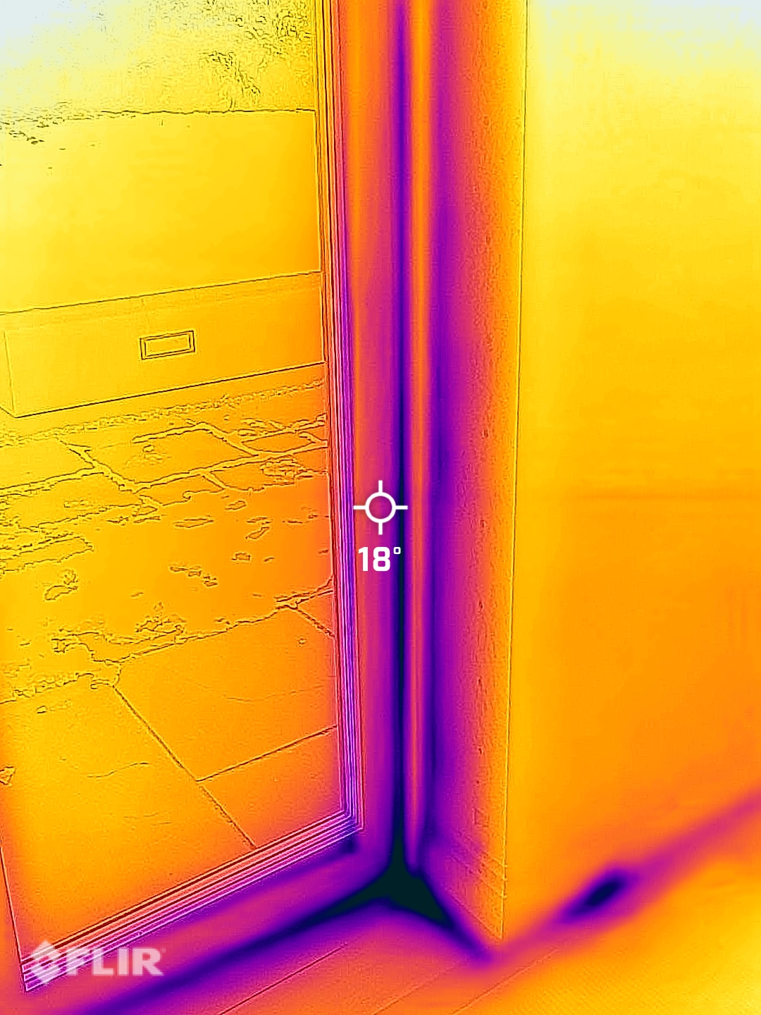

SanMan Posted December 10, 2022 Share Posted December 10, 2022 We had new Rehau uPVC windows installed earlier this year. Now that the cold weather is here, I have noticed that some of them feel noticeable cold and draughty around the reveal, not the glass or rubber gaskets themselves. It could also be coming from the outer uPVC frame, I am not sure. Please see attached photo. It almost seems like there is a hollow around the window. Only some windows are affected. How is this possible and can this be recitified, for example by drilling a hole into the plaster of the window reveal and injecting foam? Thanks. Link to comment Share on other sites More sharing options...
Spreadsheetman Posted December 10, 2022 Share Posted December 10, 2022 Do you have cavity walls and did you see if there were insulated cavity closers to the sides of the window when they were fitted? I recently had a couple of windows replaced in my 70s chalet and the window reveals were solid block bridging the cavity sides and below. I.e. a big cold bridge. These blocks had to be cut out and insulated closers fitted before fitting the windows. Link to comment Share on other sites More sharing options...
SanMan Posted December 10, 2022 Author Share Posted December 10, 2022 Thank you. Yes, they used cavity closers. I watched them do it, but there are lots of windows at our house and they had 4 people working, so I did not see every single step. When they took the old windows out, they disturbed plaster and the edge of the brickwork. I wonder if there are ragged edges. I have a boroscope….I wonder if it is worth drilling a small jolt into the reveal to have a look. Also, why would the actual white frame be so cold? Thank you. Link to comment Share on other sites More sharing options...

Radian Posted December 10, 2022 Share Posted December 10, 2022 9 minutes ago, SanMan said: So your's is this DG unit with MDPE thermal breaks. Very good performance across the broken sections I expect but laterally you have UPVC bringing the cold directly in from your bridged reveals. Maybe the frame is a tight fit into the reveal at this point? Link to comment Share on other sites More sharing options...
SanMan Posted December 10, 2022 Author Share Posted December 10, 2022 Thank you @Radian. Yes, I wonder if this is it. A fitting error that cannot be rectified? Is the unit possibly too big for the reveal? Anything I can do? Link to comment Share on other sites More sharing options...
Radian Posted December 10, 2022 Share Posted December 10, 2022 1 minute ago, SanMan said: Thank you @Radian. Yes, I wonder if this is it. A fitting error that cannot be rectified? Is the unit possibly too big for the reveal? Anything I can do? If you don't take steps to remedy it, I would expect this to be a permanent source of condensation leading to mould. You could start by inserting your scope into a diagonally drilled hole a little way from the frame to get you into the junction between window frame and outer leaf of wall. Do it about half way up the bit you marked on the photo BUT MAKE SURE YOU MISS THE FRAME! You could make thigs much worse if you breach the hollow frame! Alternatively, have a good look outside to see if there are signs of the frame being jammed in tight to the reveal. If it turns out to be a tight fit you shoud get your installer to come back and sort it out. If it's stood off with packers it's just down to the state of the reveal which probably means cutting it away and re-boarding to remedy any cold bridging. You could certainly try injecting foam and seeing if it helps first, but how effective it might be would be anybody's guess. Link to comment Share on other sites More sharing options...
j_s Posted December 10, 2022 Share Posted December 10, 2022 (edited) I have serious issues on our double glazed (4-20-4) aluminium window in the ensuite and master bedroom. I also have mvhr so the room has fresh air coming in and doesn't drop too low in temp over night. I'm confident that it's due to them being set too far forward and not on packers. Are your windows set back into the reveal over the cavity and that the closers were 100% sealing the cavity off? If not then cool air will be getting around the frame and cool air hitting those points you show. My newer aluminium triple glazed windows are set much further back in the reveals on packers and although cool to the touch are doing their job. Reveals are also sealed off from the cavity with closers that are foamed and glued and taped in along with insulation right up to the closer insulation. Edited December 10, 2022 by j_s Link to comment Share on other sites More sharing options...
Gus Potter Posted December 10, 2022 Share Posted December 10, 2022 As the mould / damp bit is at the bottom I would take off the plasterboard on the window ingoe where it is at it's worst. Yes there will be a bit of disruption but it is the best way of getting to the bottom of the problem.. UPvc windows are fine .. it's the fitting of them that 99% of the time causes the problem. Two basic things I would look for and suspect.. 1/ Window fitters are notorious for not closing and installing the cavity closers properly. They will shove something in for good looks but particularly on a retro fit you often have mortar snotters and wall ties in the way. They are pushed for time so often don't care. 2/ You have a cill that should be sealed to the bottom of the window frame so that the water drains out through the front, usually done with a bead of silicon when the cill is fixed to the window before installing. Check to see if there is dampness when you open it up. To make sure get a hose and spray it on the window for 10 -15 minutes and look at the bottom corners. Link to comment Share on other sites More sharing options...

craig Posted December 11, 2022 Share Posted December 11, 2022 You’ll actually find that Uf values (uPVC system dependant) are generally thermally better than wooden windows. Especially uPVC systems with 5 / 6 chambers and or insulation within the chambers. Not a lot you can do now other than what @Gus Potter and others have said. You need to open up to see what hasn’t been done and get them to rectify or do it yourself. Link to comment Share on other sites More sharing options...

HughF Posted December 14, 2022 Share Posted December 14, 2022 Surprise surprise, a window installation company have done a mediocre job.... Hack the reveals off, see what's underneath... Link to comment Share on other sites More sharing options...

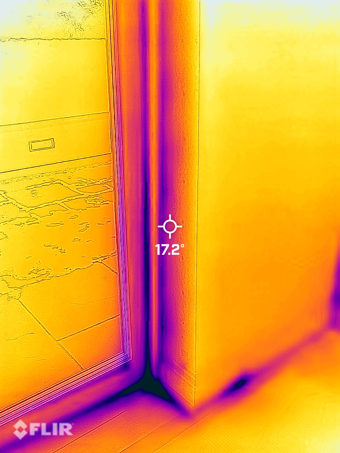

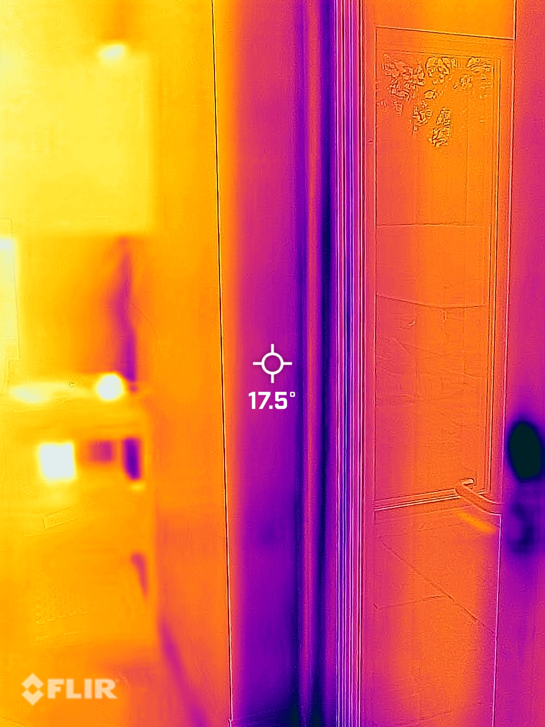

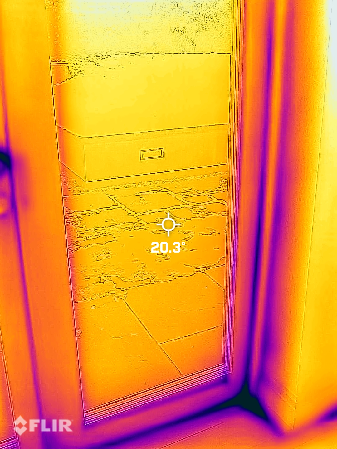

AliG Posted December 14, 2022 Share Posted December 14, 2022 That is the coldest area in all the walls in my house. Almost my definition it will be. The walls are insulated with a very low U-value and the triple glazing has a low U-value. The weak spot is the window frames, plus any bodges around them when the windows were installed. So I guess the question is are these areas colder than the should be. I would expect them to be a good few degrees cooler than the glass and walls especially when it is as cold as it has been. My windows have aluclad wooden frames, I think most uPVC frames would be worse. When you say they are "draughty" do you mean that you can actually feel a draught. This would suggest that the windows are not tight in their frames. Or is it just that the area feels colder than the surrounding area. I actually tried the experiment of injecting foam into the reveal on one side of a window to compare to the other side. I just took an IR picture of it and it has made no difference. Both sides are basically the same temperature. The RHS has foam, the LHS does not. The worst points seem to be the corners as you can see. 1 Link to comment Share on other sites More sharing options...

AliG Posted December 14, 2022 Share Posted December 14, 2022 The correct way to do it is to tape around the reveal between the frame and the wall to make it airtight. This might be on top of any foam to fill the gap around the frame. You would then probably use insulated plasterboard in the reveal on top of this. The issue is that depending on available space, width of the frames etc this is not possible, Within reason the small cold bridge is not the end of the world. The cold air getting in around the frames and behind the plasterboard is the bigger issue and if you can address anything this is what to look for. 1 Link to comment Share on other sites More sharing options...
