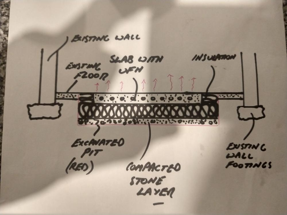

Caddy Posted January 5, 2023 Share Posted January 5, 2023 (edited) 4 minutes ago, PeterW said: Those numbers are bonkers unless this is a 250sqm ground floor cottage !! How many rooms etc do you have ..? Floor plan would be helpful. 60m² total lower and upper floor. The £20,000 is the average of 3 quotes so far. Not the equipment that is anymore expensive but the labour of fitting the pipework and converting the toilet into a small plant room. 2 rooms downstairs and 3 rooms upstairs. Edited January 5, 2023 by Caddy Link to comment Share on other sites More sharing options...
Roger440 Posted January 5, 2023 Share Posted January 5, 2023 12 minutes ago, Caddy said: 60m² total lower and upper floor. The £20,000 is the average of 3 quotes so far. Not the equipment that is anymore expensive but the labour of fitting the pipework and converting the toilet into a small plant room. 2 rooms downstairs and 3 rooms upstairs. Thats still bonkers! If you do the floor, adding a UFH loop is pennies extra, UFH pipe is cheap. All you need is this: https://www.ufhtradedirect.co.uk/multi-zone-warm-water-kits/358-623-emmeti-2-port-x-100-metre-kit.html#/57-thermostats-hetta_programmable_thermostat_000 Make sure its pressurised when the floor is laid though! I did that bit myself when i had the floor done. If its old with no DPC, id strongly suggest NOT using a modern DPM under with PIR/EPS etc. Likely to caiuse you more damp issues. Damp walls = cold walls (you dont mention that?) I used the foamed glass under the slab. Should ensure a reduction in moisture getting to walls, plus insulate and act as the foundantion layer at the sime time, so a thinner build up. You dont want to disturn the foundations on this by digging down to far. Again i stripped out the floor, dug down a bit and prepared ut myself. Then the chaps came in and put the foamed glass down. With hindsight, i could easily have done that myself. Then i put the pipes down. Then they came back and laid the floor. In my case it was connected to my existing heating circuit (oil) All that said, you need to insulate the roof first, an, i suspect your walls are wet, so will suck heat like nothing else. Whats the humidity levels in the house? Link to comment Share on other sites More sharing options...
PeterW Posted January 5, 2023 Share Posted January 5, 2023 So for digging out a 60sqm floor and relaying it you’re being quoted £6k or thereabouts by my calculations … For a weeks work for 2 guys..?? I’m in the wrong job..! TBH you will get away with not needing a buffer tank here as the UFH in the slab will need a lot of heat off an ASHP - it will just bleed heat until you start to dry out the fabric and get to some sort of equilibrium. A standard monoblock heat pump needs nothing inside - only query would be about hot water ..? A2A isn’t that expensive either if you are going with a unit for upstairs and one for down but if you’re going full splits etc it can get pricey plus it needs more wiring and pipework than is first considered. Another option with this sort of building is a pellet range cooker - they give a constant low heat and can be surprisingly efficient if you have the space. They aren’t cheap but do qualify for some of the renewables grants https://www.stovesonline.co.uk/wood_burning_stoves/Klover-Traditional-Smart-120-wood-pellet-boiler-stove.html Link to comment Share on other sites More sharing options...

mgo Posted February 8, 2023 Share Posted February 8, 2023 such a lot of info here, my wonder is do you always need to break up the old concrete floor? If you have enough headroom, what could be the disavantage to just add a layer of PIR insulation on top of the old concrete, add UFH and level off with screed. Leaving out DPM all together when the original cement floor is not damp. I am in the same situation (assuming no insulation / DPM currently under current old cement floor), and am looking into installing it this way, rather than opening up and excavating all excisting flooring. Link to comment Share on other sites More sharing options...
