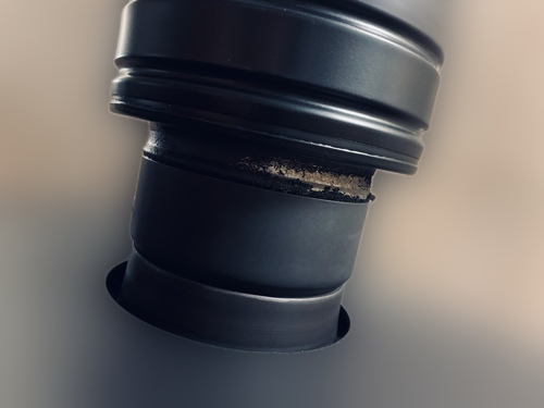

Marvin Posted November 28, 2022 Share Posted November 28, 2022 This should help: The male end of the stove pipe for wood burning should always point down and/or pointing at the stove. Also, the wood stove pipe should always be inserted into the collar of the wood stove outlet. From: https://www.rockfordchimneysupply.com/blog/correct-direction-to-install-wood-stove-pipe/ 1 Link to comment Share on other sites More sharing options...
SteamyTea Posted November 28, 2022 Share Posted November 28, 2022 3 hours ago, Temp said: I believe its done like a funnel so that any tar/condensate/rain running down the inside of the flue doesn't leak out of joints but ends up in the stove. 1 hour ago, saveasteading said: provide no hindrance to smoke travelling upwards. And you woodburners are happy to have this happening in your living room, or should that be renamed, dyingroom. When it gets cold can I pop over and sit in your warm room. I will not smoke more than 1 packet of Marlboro Reds (even though they are in a black packet). You will not notice me being there. Link to comment Share on other sites More sharing options...
Alan Ambrose Posted November 28, 2022 Share Posted November 28, 2022 (edited) >>> The second installer said that it wasn't best-practice to seal stuff with fire rope - he said fire rope is only really good in limited situations and this wasn't one of them. Yeah, I sealed mine with both fire rope & fire cement - I believe I probably got that info from Morso and/or Schiedel, the stove/flue suppliers. A bit odd for a 'professional' to forget the seal. Maybe there is some seal there too but it's a very lightweight application? I can understand your concern, but once it's fixed and you have ample CO alarms, you should be good to go. Alan Edited November 28, 2022 by Alan Ambrose Link to comment Share on other sites More sharing options...
Alan Ambrose Posted November 28, 2022 Share Posted November 28, 2022 Yeah, from Schiedel install instructions: https://www.schiedel.com/uk/schiedel-download/icid-installation-instructions/?wpdmdl=6823 "APPLIANCE CONNECTOR 1. The protruding liner of these components should be pushed into the appliance spigot with the male collar pointing upwards. The liner can be trimmed to suit the depth of the appliance spigot. 2. On solid fuel appliances the appliance connector should be sealed to the appliance with fire rope and fire cement or high temperature sealant to provide a gas tight joint." Alan Link to comment Share on other sites More sharing options...
Temp Posted November 28, 2022 Share Posted November 28, 2022 Our stove gets about 3 mm taller when hot and this caused some movement at the joint between stove and stove pipe. Doesn't seem to have caused a leak though. I guess I should throw in a reminder to install Carbon Monoxide detectors in any/all rooms with a stove or flue. 1 Link to comment Share on other sites More sharing options...
hendriQ Posted January 11, 2023 Author Share Posted January 11, 2023 So by way of update, the stove was purportedly fixed in early December. The guy applied some fire cement, gave me instructions on how to cure it and then told me “it would definitely be fine now”. Well we ran the stove at least once a week over the last 5 weeks or so, all good. Then tonight it happened AGAIN. I’m fuming. I paid by credit card so solid be relatively straightforward to get all my money back, although I need to check as the transaction was over a year ago. If not I will sue . Is my reaction a reasonable one? Link to comment Share on other sites More sharing options...

hendriQ Posted January 12, 2023 Author Share Posted January 12, 2023 1 hour ago, ProDave said: Did you take a video this time? Yes, it shows smoke coming out from the same place as last time. I guess my options are to claim against my credit card company under section 75 of the ConsumerCredit legislation which - checked - I am still well within time to do, or try to engage with HETAS to get to the bottom of what the cause is, or speak to the Stove manufacturer or give the supplier and installer yet another chance. I am loathe to do the last option, unless there is a defect in the stove itself they just smack of incompetence. Link to comment Share on other sites More sharing options...

ProDave Posted January 12, 2023 Share Posted January 12, 2023 As part of the investigation, did anyone check the flue? check it was not blocked? swept it? been up on the roof to check the outlet, used a smoke candle etc? Normally the flue draws and as already sated that will be a negative pressure inside the flue with respect to the room so a leak would draw air in. The fact smoke is leaking out really suggests to me the flue is partly blocked so the heat of the stove is forceing the smoke up the flue. Re sealing the joint had hidden the true fault for a while until the seal cracked a bit and allowed the positive pressure smoke out. I would get an independant HETAS engineer to check it out, check out the flue and write a report. If he can point to a defect in or blocked flue etc you might have a chance of a claim against the original installer. Or having identified the true fault it might just be quicker and easier to fix it. 1 Link to comment Share on other sites More sharing options...

hendriQ Posted January 12, 2023 Author Share Posted January 12, 2023 25 minutes ago, ProDave said: The fact smoke is leaking out really suggests to me the flue is partly blocked so the heat of the stove is forceing the smoke up the flue. Also, i'm no thermodynamics expert but is a partially blocked flue likely when the fire lights so easily and draws very well for a good 30 minutes before the issue developed. I also can't see what it would be blocked with. Brand new installation, with a flue pipe going all the way up to the top of the house. Link to comment Share on other sites More sharing options...
ProDave Posted January 12, 2023 Share Posted January 12, 2023 4 minutes ago, hendriQ said: I agree with this, save that both the original installer and the purported fixer were Hetas registered, so it doesn't sound like such a good accreditation. But did anyone investigating this examine or test the flue? or just re seal the leaking joint and hope? It really should not need to be a perfect air tight seal. I have worked with some builders that have an old stove they use on new builds in the winter. They just stand their "portable" stove on a couple of concrete blocks in the fireplace, a short length of flue, not even properly sealed to the stove stuck up the chimney. Because the flue draws air when working properly, not a drop of smoke leaks from their temporary unsealed joints. Link to comment Share on other sites More sharing options...
hendriQ Posted January 12, 2023 Author Share Posted January 12, 2023 (edited) 47 minutes ago, ProDave said: But did anyone investigating this examine or test the flue? or just re seal the leaking joint and hope? It really should not need to be a perfect air tight seal. I have worked with some builders that have an old stove they use on new builds in the winter. They just stand their "portable" stove on a couple of concrete blocks in the fireplace, a short length of flue, not even properly sealed to the stove stuck up the chimney. Because the flue draws air when working properly, not a drop of smoke leaks from their temporary unsealed joints. I see where you are coming from now. When the "fixer" attended in late Nov to diagnose the issue, he did get some cardboard and light it on fire to see if the flue drew. I can't remember if he went outside to look at whether the smoke came out the chimney. Is that the test he should have done? Edited January 12, 2023 by hendriQ Link to comment Share on other sites More sharing options...
Miek Posted January 12, 2023 Share Posted January 12, 2023 Does the flue come out of the back of the stove in to a T piece? Occasionally the end cap can drop off the bottom when it gets hot and kills the draw of the flue. Maybe a long shot but one I've seen happen.. Link to comment Share on other sites More sharing options...
