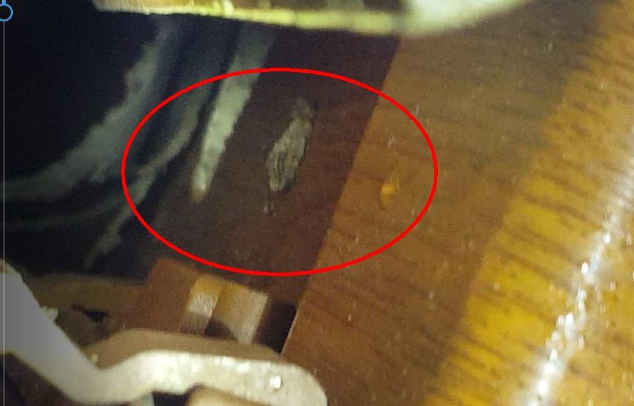

Ferdinand Posted January 4, 2023 Author Share Posted January 4, 2023 A further question. Does this look like a Roland entrance hole, in the soffit. It is just about 1 inch across. It is neatly gnawed by the look of it. May need to remove gutter to get at it properly. No noises at present. How do I block this, and prevent another one being chewed? The photo us at approx the right angle. It is behind a gutter which had hedgehog in it (currently removed for a clean), so I wonder if the brush gave a bit of shelter. Ferdinand Link to comment Share on other sites More sharing options...
ToughButterCup Posted January 4, 2023 Share Posted January 4, 2023 Put baited traps down. M/T for 2 weeks (they're neophobic) then bait and check fortnightly. Get a ratter of a cat: day rate £100 a day. Link to comment Share on other sites More sharing options...
