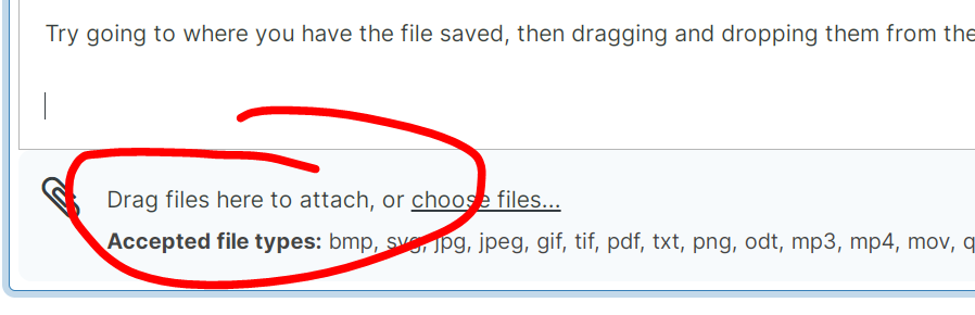

jack Posted November 15, 2022 Posted November 15, 2022 9 minutes ago, Conor said: You're a new user, you dont have the right to upload yet. Maybe @jack can help? I'm not aware of there being limitations on new users uploading, plus he managed to upload one yesterday. 22 minutes ago, DaveAF said: File size is 1.50mb. I select 3 from my files but they dont upload. Accompanying post text does upload. Size seems fine. Try going to where you have the file saved, then dragging and dropping them from there into the post where shown in the editor: 1
