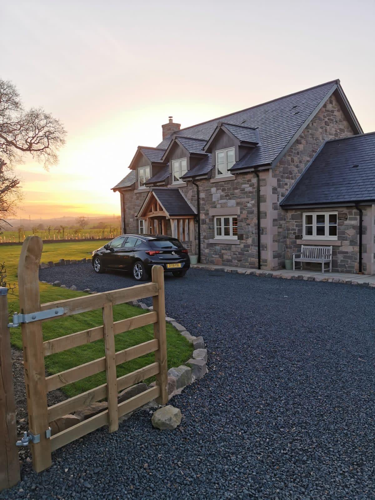

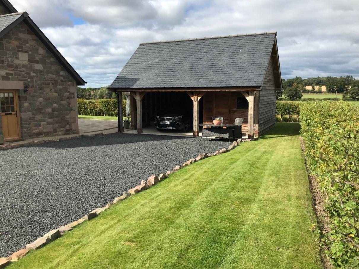

Redoctober Posted October 11, 2022 Share Posted October 11, 2022 3 hours ago, JohnMo said: We have compacted type 1, then crushed lime stone. Any gravel type protects you use, make sure you specify a crushed rock and not sand washed (rounded) pebble. Crushed rock locks its self together, so it compacts and doesn't move much. Anything rounds just moves about and is a complete pain. Exactly that - we have used 20mm granite chippings on compacted type 1 and haven't had a problem since it went down some 4 years ago. A couple photos to help. 2 Link to comment Share on other sites More sharing options...
Carrerahill Posted October 11, 2022 Share Posted October 11, 2022 3 minutes ago, Redoctober said: Exactly that - we have used 20mm granite chippings on compacted type 1 and haven't had a problem since it went down some 4 years ago. A couple photos to help. Simple, looks good and suits your property & surroundings. 1 Link to comment Share on other sites More sharing options...

Vijay Posted October 11, 2022 Author Share Posted October 11, 2022 thanks guys. I like the look of the granite chippings too Link to comment Share on other sites More sharing options...
Vijay Posted October 11, 2022 Author Share Posted October 11, 2022 56 minutes ago, Redoctober said: Exactly that - we have used 20mm granite chippings on compacted type 1 and haven't had a problem since it went down some 4 years ago. A couple photos to help. Really like that. Any idea what depth of sub base and top layer of granite chippings you did? Link to comment Share on other sites More sharing options...
Redoctober Posted October 11, 2022 Share Posted October 11, 2022 @Vijay I'm not sure of the measurements etc - From the outset of the build, the "driveway" was used as main entrance so over the months the build progressed, we may have topped up with MOT 1 - Somehow the figure of 20 Tonnes comes to mind. The same quantity of chippings too I believe. Sorry, that the best I can offer. For completeness, the landscaper allowed me to order materials using his account so I benefitted from his discounts. Link to comment Share on other sites More sharing options...
