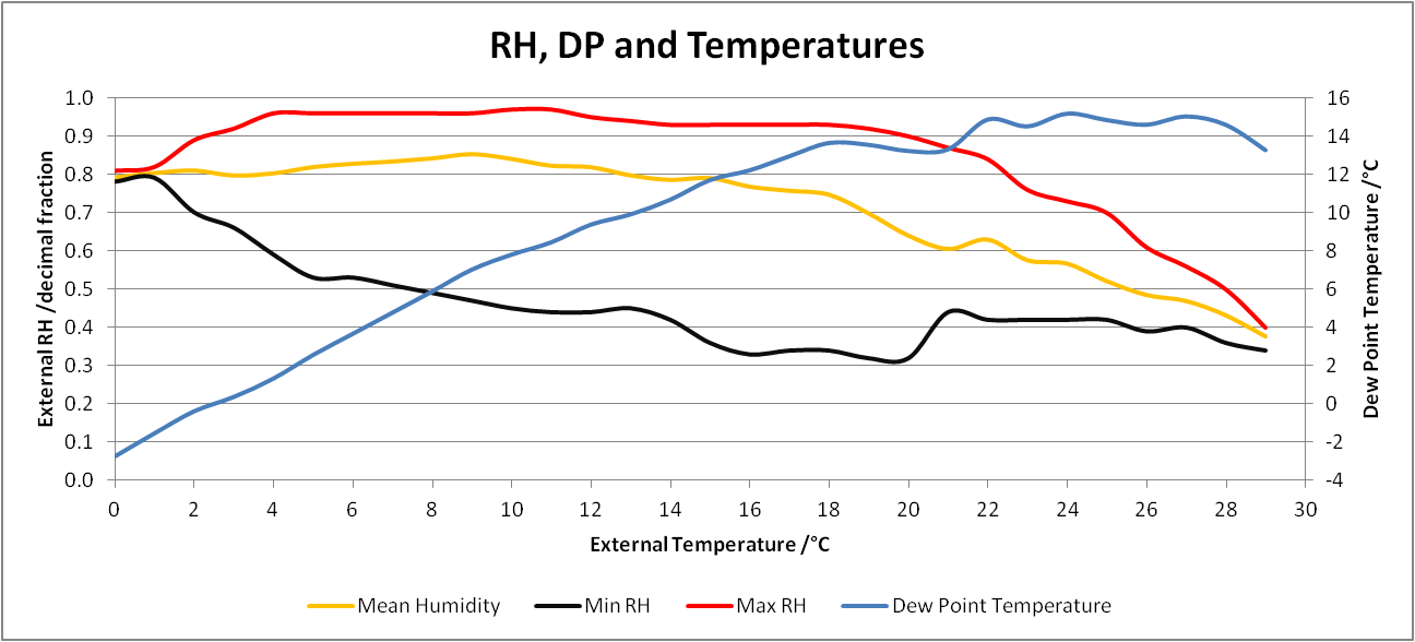

TonyT Posted September 25, 2022 Share Posted September 25, 2022 What’s the humidity like in the house? amazon sell cheap units for about a fiver that will help gather data Link to comment Share on other sites More sharing options...
Radian Posted September 25, 2022 Share Posted September 25, 2022 (edited) Borderline amounts of airflow may be all that keeps condensation forming on your walls. Therefore where things cover the wall (e.g. hats) there's a build-up of moisture that the mould is thriving on. Additional vapor from your breath on the wall you sit at might also tip the balance. If it is such a fine balance it might be solvable with a small amount of additional ventilation. As for eliminating the mould, bleach solutions might not be enough. A 3% hydrogen peroxide solution (the standard percentage sold in pharmacies) would be my starting point. Stronger can be bought online if 3% doesn't clear it. Edit: just read you ventilate the place by opening windows - but to what? Must be a rainforest out there. Edited September 25, 2022 by Radian Link to comment Share on other sites More sharing options...
ProDave Posted September 25, 2022 Share Posted September 25, 2022 You bought an old stone cottage that will have no damp proof course and was built to standards of the era. I could have told you it would likely be a cold and damp building to live in. Unless you hermetically sealed the extension from the rest of the house then the damp air will circulate. I very much doubt it is your location. Put a modern house like the ones many on here have built in that location and I bet you would not have any problem. 1 2 Link to comment Share on other sites More sharing options...
Adsibob Posted September 25, 2022 Share Posted September 25, 2022 I would seriously consider selling up and buying something newer that isn’t going to affect your health. I’m not sure I buy the “it’s the local microclimate” thing, because a good house should be built to deal with it’s climate. If you had a fully airtight and water tight well insulated new build with MVHR you just wouldn’t have mould anywhere, whatever the local climate. 1 Link to comment Share on other sites More sharing options...

Gone West Posted September 26, 2022 Share Posted September 26, 2022 It is possible to have an old stone cottage that isn't cold and damp. I pumped a lot of heat into our place initially, because it had been empty for a year. Eventually the humidity decreased but it took a long time to dry out. I think it was @SteamyTea who explained how much moisture can be held in the plasterwork etc and therefore how much energy is required to dry it out. I think a lot of people who live in areas like @zoothorn think it's just the way it is and have always lived in cold houses which are therefore damp. Link to comment Share on other sites More sharing options...
markc Posted September 26, 2022 Share Posted September 26, 2022 I bought an old house that had been empty for a year, thick solid walls and cellar etc. probably took around 18 months of over heating it to dry it out properly. now my heating bills are pretty low considering it’s an ex railway property. Link to comment Share on other sites More sharing options...
joe90 Posted September 26, 2022 Share Posted September 26, 2022 I think position and amount of solar gain makes a huge difference, Wales is wet by nature. The cottage I referred to above was in a deep valley so very little solar gain or wind drying effect. It’s a shame @zoothorn heating was a fiasco in the first place. Link to comment Share on other sites More sharing options...
SteamyTea Posted September 26, 2022 Share Posted September 26, 2022 5 minutes ago, Gone West said: It is possible to have an old stone cottage that isn't cold and damp. Yes, just costs a lot to get it dry again. There is, at a fundamental level, no difference between a new brick and an old brick, or a new stone and an old stone, or concrete. Really just where they are placed and what the environment around them is. Here is what the environment is like around my house. Gets close to saturation i.e. RH=1, but not quite (basically means very few foggy days this year) Got to within 0.5°C. This basically means that there is, in an unoccupied building, little risk of condensation. Increase the internal temperature and there is no risk. But add some people and cook, bathing, clothes drying, then there is, so ventilation is needed. 2 Link to comment Share on other sites More sharing options...

zoothorn Posted September 26, 2022 Author Share Posted September 26, 2022 (edited) 23 hours ago, TonyT said: What’s the humidity like in the house? amazon sell cheap units for about a fiver that will help gather data Tony, this is a total red herring. I have cheap units, someone kindly sent me them. They shoe a " normal" humidity figure. So something else is at play here for the descriptions I've outlined, the physical evidence I've described in photos & describing the strangely ott damp conditions of the local area, the physical pain my lungs were in for months. So, readings of a % the figure are totally inadequate, useless. Why? Because it results in a collection of people desperate to disagree with me. With what I report. With what I say it's like living here. "Old stone cottages.. blah blah". It has bugger all to do with 'old stone cottages'!! It's a LOCAL facet. It is equally abundant here, as it is in the modern bungalow opposite (I had friends living there, I frequented it/ the same symptoms- of course the same symptoms if it's a LOCAL facet). And, similar too in my even more modern brand new extention. Actually this most modern build of all three eg's......... is by far...... the worst!! Please. Forget this red herring of old stone cottages, or humidity readings. Its a LOCAL facet. I've shown examples of the unusually bad mould on newly built areas, in extentions, not corners of my old part of the house which is totally, completely separate in terms of the odd 'usual' bit of "old cottage damp" I'm not not not ----whatsoever---- talking about. Local environment. You cannot do anything about it!! Nothing. Apart from de-seed the clouds that is, &/ or flatten both steep hillsides here & remove the fir forests ( & reverse the westerly sea breeze bringing in moisture from sea 6m away); these these these are, can only be, the likely reason for this weird local facet 'thing'. It's just a combination of factors colliding, in an area, like a perfect moisture storm. I simply wouldn't have been in pain, in my lungs, for months, if it wasn't for such a 'thing' being real. Absolutely zilch all to do with 'old stone cottages'! Edited September 26, 2022 by zoothorn Link to comment Share on other sites More sharing options...

joe90 Posted September 27, 2022 Share Posted September 27, 2022 5 minutes ago, Gone West said: Yes it's weird to think that my old PassivHaus would no longer function as a PH just because I built it in a different place. However, if I may, his original build is not passive, no cavity no wall insulation, perhaps no DPC and years of damp build up within the old stone. I am sure with lots of heat and ventilation the damp could be removed but it won’t be quick. Link to comment Share on other sites More sharing options...
Gone West Posted September 27, 2022 Share Posted September 27, 2022 7 hours ago, joe90 said: However, if I may, his original build is not passive, no cavity no wall insulation, perhaps no DPC and years of damp build up within the old stone. I am sure with lots of heat and ventilation the damp could be removed but it won’t be quick. The point is that Zoot seems to think that any house in his area will always be cold and damp. He said "LOCALLY-specific (not house-specific!!)", whereas I think a PH will function as a PH in his area. 1 Link to comment Share on other sites More sharing options...
Radian Posted September 27, 2022 Share Posted September 27, 2022 Hopefully zoot has stopped reading this now to preserve his blood pressure but I'm afraid it would be a case of "magical thinking" to contend that no matter what type of house construction is subject to these conditions, they will all suffer the same fate. While it may seem this way, it can be shown to be physically impossible by considering extremes: For instance if we build a habitat on Mars it would have to behave exactly the same on Mars as it would when transplanted to zoot's location. From there we can gradually widen the constraints and uncover the failings in construction and operation that lead to an exchange of indoor and outdoor environments. Of course it might take a considerable budget to achieve it. More than is commonly deployed for domestic dwellings. 1 Link to comment Share on other sites More sharing options...
