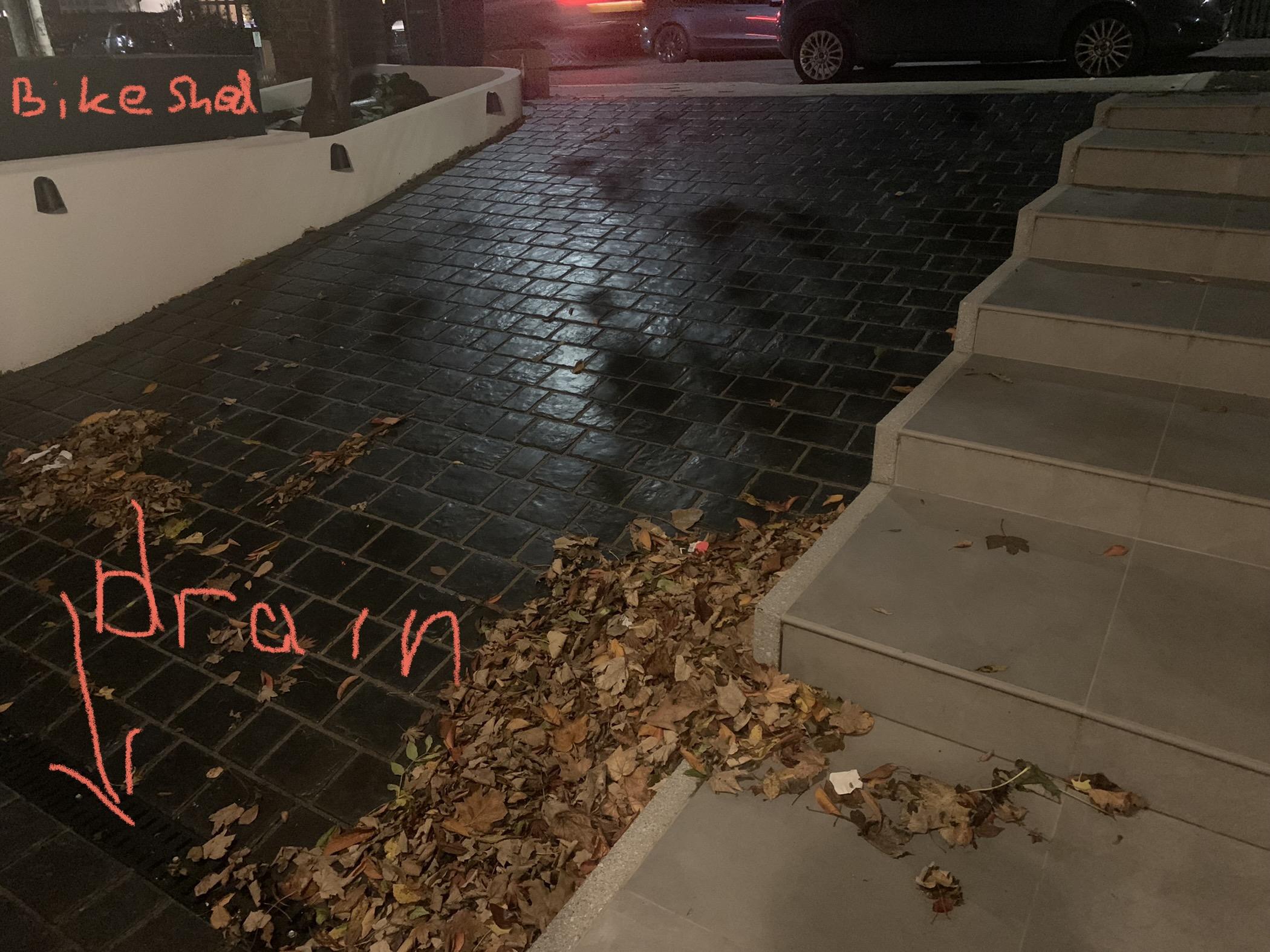

She wants us to spend £££ redoing the whole driveway by taking up the setts, building a retaining wall and raising the slope so instead of a 12 or 13 degree slope, we have something much closer to flat (but not actually flat) and then relaying the setts. The setts are not stuck down to the bedding beneath them. They are just grouted in because these are Marshalls drivesys setts, so that’s how they are installed.
Part of me thinks this is absolute madness, part of me thinks that having spent so much on the house already, in the grand scheme of things this will be 1% more at most, particularly if not too many setts are damaged in the “ungrouting” process. We have about 200 setts spare anyway.

the drain is an aco drain which runs the whole width of the driveway at the bottom of the slope. (we have one at the top as well). The bike shed is accessed in the bottom right hand corner of this image, which the camera shot has chopped off. That’s relevant because the access to the bike shed is fairly flat and level, so reducing the slope of the driveway will either leave a massive step up from the area of ground outside the bike shed door or we need to remove the bike shed, pour quite a bit of screed/concrete and then reinstall bike shed so that it will be level.
 There are 6 steps up to the street from the floor immediately outside our front door. Each one is about 76cm deep. From that floor, there is also a step down to the bottom of the driveway (which partly explains why you can see a bunch of leaves which have collected there in the image).
Current rise over run of driveway is 1/5.33.
I will post another photo in a minute showing other side of aco drain.
 Those three black things are wall lights and the white wall is a planter that houses the bike shed and one day will house soil and plants to partly conceal the bike shed.

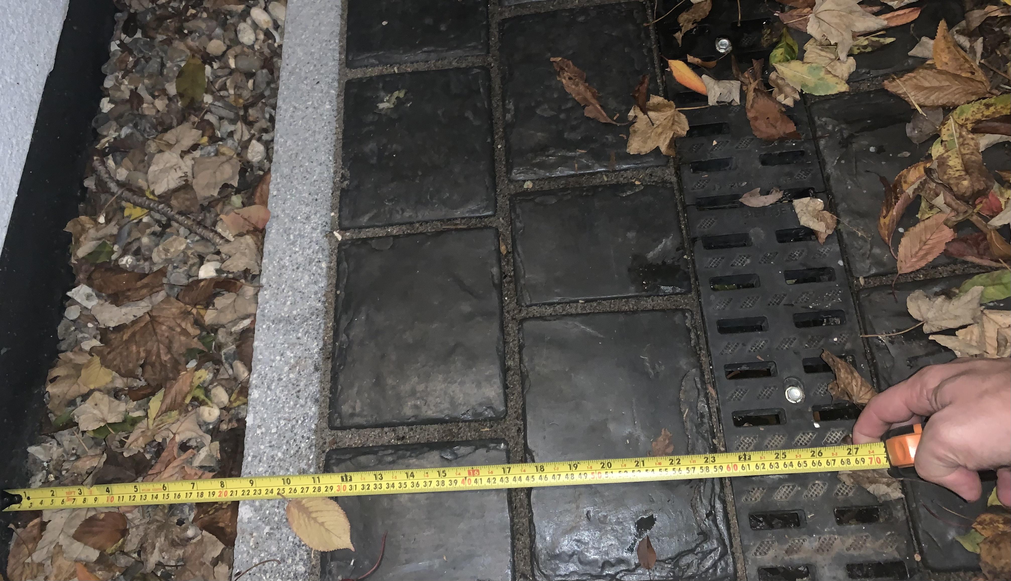

Here is other side of aco drain:
Two rows of setts which are virtually flat, but with a slight fall towards aco drain, then a retaining concrete edging strip then a French drain before we hit the wall of the house.
 Originally, there was a patio here which was built up over the DPC and this wall had a massive damp problem as a result. As part of the refurb a surveyor designed this, which has obviously resulted in this bit of ground being quite a bit lower than before.

It does appear steep and shiny...
Yes. I’ve worked out how to get the shiny coating off (which is wax the manufacturer applies to protect the setts (which are artificial) during transit) but it’s a least a day’s  work using solvents and elbow grease and I’m not sure I can be bothered if I will just be forced to redo the whole thing anyway.
It does look great, and I can understand the reluctance to take it up.  Now crack on and get it raised, anything else is not really going to be a satisfactory solution I fear.
My thoughts on the photo.
Wrong material, you don't want smooth and shiny, you want rough and grippy, probably coarse tarmac, or concrete with a tamped finish but that might be tricky on that slope, it would have to be pretty dry when laid.
I would not want to park on a slope like that, you either have to reverse down, or probably worse is reverse up the steep slope not being sure that is coming because you are down in a dip.
Does it lead to a flat area with room to park 2 cars and turn?  If not and that is your only parking I would want it a LOT less sleep which means the retaining wall and a flatter raised drive.
It’s all very disappointing, because the setts are made by Marshall’s and designed for driveways, and I checked with them prior to ordering and their limit is 15 degrees, so I thought this (which is 10.8 degrees) would be fine.  But I guess the forum agrees with my darling wife, and we will go ahead and do it.
