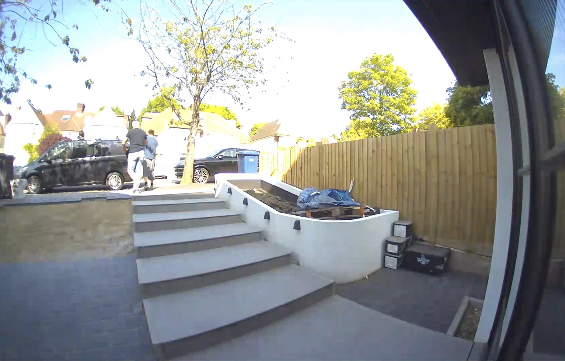

Ok, so almost a year after driveway V1 was finished, my trusty builders are back to redo it. Costing me an absolute fortune, but probably cheaper than couples therapy.
Here is progress (of two guys) after day 1 (which started at 11ish and finished at 445):
they have managed to take up almost half the setts. The rest will come up tomorrow.

Two weeks in, and they have made good progress. The retaining wall (made of steel reinforced concrete) has been cast and they have started to fill the diagonal volume now bound by that retaining wall with a layer of concrete rubble and then sand which they have been compacting with a compactor. They have maybe filled the bottom third of it. What has surprised me a little is that on top of this, they have put in some clay soil which I wanted thrown away (from the back garden). I wasn’t thinking it would end up in there when I asked them to dispose of it but it has now ended up in there as well. In all, it will only make up about a tenth of the volume, probably less, but it concerned me a bit as I would have thought this is not really a building material appropriate for the sub-base of a driveway. There is of course compacted MOT below all of this which was laid for the original driveway.
I asked the foreman if it was okay to use soil mixed in with the sand, and he said it will be fine as they are compacting it.
Some of this clay soil (less than 5% of it) is grass, which will surely shrink to nothing once it decays.
Thoughts?
Postscript: got some further clarity today: above the clay they are putting in, they are putting in more rubble, above that and about 40cm below the finished driveway line, they are going to put a load more MOT in and pack it down with a compactor. So I’m more relaxed now.
It suits him and saves some money.
The weakest material always goes at the bottom. But this just seems silly.
What’s silly about it? He had a m3 of clay soil to get rid of, which he hadn’t factored into his original pricing. If it can go in the ground underneath the driveway, what’s the problem?
