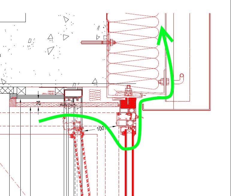

Temp Posted June 14, 2018 Posted June 14, 2018 (edited) Someone called "lineweight" posted this detailed expert witness report on how the tower did/did not comply with the Building Regulations... https://www.dropbox.com/s/9f9679e7k0yppyj/Dr Barbara Lane report_1.pdf?dl=0 It's full of horror stores so I just pick out..... "11.18.22 I have found no evidence that proprietary cavity barriers were specified at any stage of the design or installed during construction to close the openings created in the external cavity walls by the windows." snip "11.18.29 I therefore conclude that every window opening in Grenfell Tower was not compliant with the provisions made in section 9.3 of ADB 2013 to provide cavity barriers to close around openings in the external wall" Edited June 14, 2018 by Temp
Jeremy Harris Posted June 14, 2018 Posted June 14, 2018 That fits with the sectional drawings that were dug out shortly after the fire, before the companies involved started trying to cleanse the internet of any of them. There were clear gaps shown where fire escaping from a window opening could directly access the void between the rainscreen cladding and the insulation in this drawing you posted back then, @Temp:
Temp Posted June 14, 2018 Posted June 14, 2018 Not sure if that link works but the original can be found here.. http://www.greenbuildingforum.co.uk/newforum/comments.php?DiscussionID=15130&page=13#Item_13
