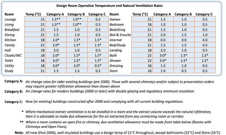

ruggers Posted August 26, 2022 Posted August 26, 2022 I've been using some heat loss calculation software that many heat engineers use & I've accurately included all of my data & exact U-values. I've tried altering certain room temperatures from 21°C to 19C to see how it affects things room by room and the total. The software defaults the ACH per hour but I don't see any option to include the MVHR unit I'm choosing to use & include its efficiency. Zehnder Q350. Looking at an MMVHR estimate I received, it states some nominal air changes 1/h. I input one of them to a small second bathroom, overriding the default and i had to increase the ACH from 2 to 3.47 if this is correct? to see how it would affect the heat loss. It increased it much more than expected, so I'm now wondering how much this is going to negatively affect my overall loss. The standard heat loss for 235m2 is 6.4kw with 10% extra added on due to exposed area setting. How should MVHR be included into the ACH section once I have a detailed design? We know with UFH/radiators and weather compensation that its very important to get accurate heat losses to size the emitters. I was also hoping for a good heat loss result.

ruggers Posted August 26, 2022 Author Posted August 26, 2022 A good few replies from a late night post. I'll answer below. I believe MVHR to be good and having to have an air tightness test on new builds means MVHR or trickle vents, ones cheap, one isn't, but i hate trickle vents with a passion. So going down the MVHR route, I'm fitting a quality unit that can recover up to 94%. I have a good draft design that i will self install and have narrowed it down to two really good companies to complete the design, install & commission after speaking to a few of them. (Will select once overall quotes are in for all trades). So I've decided to make sure I apply a high level of air tightness & insulation detail myself after researching a lot on here & speaking to people. 5 hours ago, MikeSharp01 said: Which software are you using? MVHR should improve your heatloss as it warms the incoming air from the heat embodied in the outgoing air. Heat engineer app followed by sending the report to the desk top version to fine tune everything. It will warm the incoming but would it not also be dumping some of the warm air outdoors continuously, 20°C extracted at 90% recovery would mean the supply air is 18°C? I sometime see quotes saying MVHR can lower your heating bills by 20%. In winter I probably wouldn't open my windows & never use trickle vents so it would be less than MVHR. I'd crack them open on catch in bedrooms for an hour or so in the morning or when cooking. 2 hours ago, joth said: Can you explain why you had to do this? It doesn't sound right. It's probably not correct what i done, i was just trying it based on the attached screen shot, the heat loss software defaults all ACH to 0.5, 1.5 or 2 for various room types. 2 hours ago, ProDave said: There is no such thing as a standard heat loss per square metre. It will be individual to each building depending on insulation levels and air tightness. Once you get to a certain level of insulation, then ventilation heat loss starts to dominate, and that is really where MVHR works best. At this stage in a new build you should be striving for maximum insulation, detailed well, and very good air tightness, and then mvhr will get you a low energy house. Bad choice of words from me sorry, shouldn't have said standard. My calculations are now completed & showing as whole house loss of 6.11Kw based on all of my materials to be used with correct U-Values. This is 10% more than it would be because I've ticked the exposed area option being 125m elevated, 2 miles from the West coast in a windy area. What I'm surprised at, is by changing my 0.17W/m2K cavity wall insulation to a different U-Value to simulate how adding some internal insulated plasterboard at different thicknesses would improve things, it made hardly any difference at all and they cost 3x more than a standard plasterboard. Adding 37.5mm to the inner skin gives a value of 0.14W/m2K, adding 52.5mm gives a value of 0.13W/m2K. My 6.11Kw house heat loss only improves to 5.97kw and 5.92. It seems a waste of money adding the insulated board to the inner walls unless I've done something wrong?
ruggers Posted August 26, 2022 Author Posted August 26, 2022 I think MVHR is a good idea, and I'm happy with the heat loss calculation although would like to improve it further. What I don't know how to do, is get the most accurate results from the heat loss software when installing MVHR as this could/will affect the air changes beyond their defaults. This can through the calculation out massively & I could end up under or over sizing my heat emitters which defeats the object. I'm aiming to get them as accurate as i can, so when fitted with weather comp the house is sized perfectly & feels good. Question is, what do i set the ach to in the software to reflect the MVHR install?
SteamyTea Posted August 26, 2022 Posted August 26, 2022 1 minute ago, ruggers said: Question is, what do i set the ach to in the software to reflect the MVHR install? Try 20% of the value. 1 1
ruggers Posted August 26, 2022 Author Posted August 26, 2022 1 minute ago, SteamyTea said: Try 20% of the value. Of each room value? Why that figure? I'm hoping it will be answered at a later date once i pay for a detailed design with the MVHR company who can advise me what to add but MVHR won't know much about heat loss calculations or care so I need to make sure I can input the correct data to get my results accurate. As mentioned, a whole house of adding insulated plasterboard made very little difference but changing some parallel rooms lowest temperatures from 18°C to 20°C to match the 21°C design temperature shaved off 0.4kw total.
SteamyTea Posted August 26, 2022 Posted August 26, 2022 10 minutes ago, ruggers said: Of each room value? Why that figure If the MVHR unit is 80% efficient (optimistic in reality) that means 20% is not recovered. Room by room or whole house probably does not make much difference, but the Building Regs specify flow rates. Just convert from litres per second to kWh per day. 1 1
joth Posted August 26, 2022 Posted August 26, 2022 33 minutes ago, ruggers said: It's probably not correct what i done, i was just trying it based on the attached screen shot, the heat loss software defaults all ACH to 0.5, 1.5 or 2 for various room types. (I don't see the screen shot?) This sounds very similar to the standard MCS heat loss calculator template. We used the "Cat C" columns below, which assume 0.5 of 1.5 ach with a special note about extract ventilation. The issue with their spreadsheet is less the specific ACH used but the fact they have no calculation for heat recovery of any sort. The net result was it overestimated our heatlosses by 100% vs PHPP. 1
JohnMo Posted August 26, 2022 Posted August 26, 2022 Not sure why you are not just using the heat loss calculations in the boffins corner, it lets you set the ACH and MVHR efficiency. It free easy to use and pretty good representation of what to expect from your house. 2

ruggers Posted August 26, 2022 Author Posted August 26, 2022 @joth This is my concern, that the software only detects a change of defaults resulting in more air exchanges per hour so it estimates that i require more heat than needed because it doesn't factor in the heat recovery percentage. I will look into this in more detail because a tutorial video i recall a mention of 50% default for MVHR but an option to increase the %. Is PHPP the passive house detailed calculation, do you have a passive house? I've included some attachments, the MVHR report is just one of the 3 companies who provided me with some details & a quote.
ruggers Posted August 26, 2022 Author Posted August 26, 2022 2 hours ago, SteamyTea said: If the MVHR unit is 80% efficient (optimistic in reality) that means 20% is not recovered. Room by room or whole house probably does not make much difference, but the Building Regs specify flow rates. Just convert from litres per second to kWh per day. 1 hour ago, JohnMo said: Not sure why you are not just using the heat loss calculations in the boffins corner, it lets you set the ACH and MVHR efficiency. It free easy to use and pretty good representation of what to expect from your house. I will take a look at them John, always good to compare because sizing emitters can only be done once with UFH. I just imagined the sheet would require me doing a lot of long hand calculations with formulas which isn't my forte. Some experienced heat engineers I've been speaking to had said about using the heat eng. software as it was good, although they can do it via others means it would provide me with good results and use it themselves. I'm not sure if they have considered MVHR before though. My concern is how the software correlates with heat losses vs ach & heat recovery. 1 hour ago, JohnMo said: In a close to airtight house an exposed windy location, shouldn't have any undue effect on the heat loss calculation as the wind cannot get into the house. 1 hour ago, joe90 said: That sounds counter intuitive to me! I have a west facing wall and believe the wind chill will lower the temperature of that wall which will “suck” more heat through the insulation , hope to be proved wrong! I think I'm with Joe on this one to a degree (No pun intended). The chilled wind could act as a wicking effect at drawing the heat away from the dwelling, especially if wet mortar between face bricks, I may be wrong because the inner and outer skins are independent, but we do know that poorly fitted PIR in a cavity can have the same effect as a radiator in reverse. Air passes between the gaps from poor install and draws heat away from the inner cavity wall. Effectively no wind should be able to get in other than tiny weep hole vents but its possibly just from the difference of temperatures.
